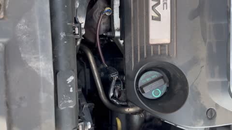

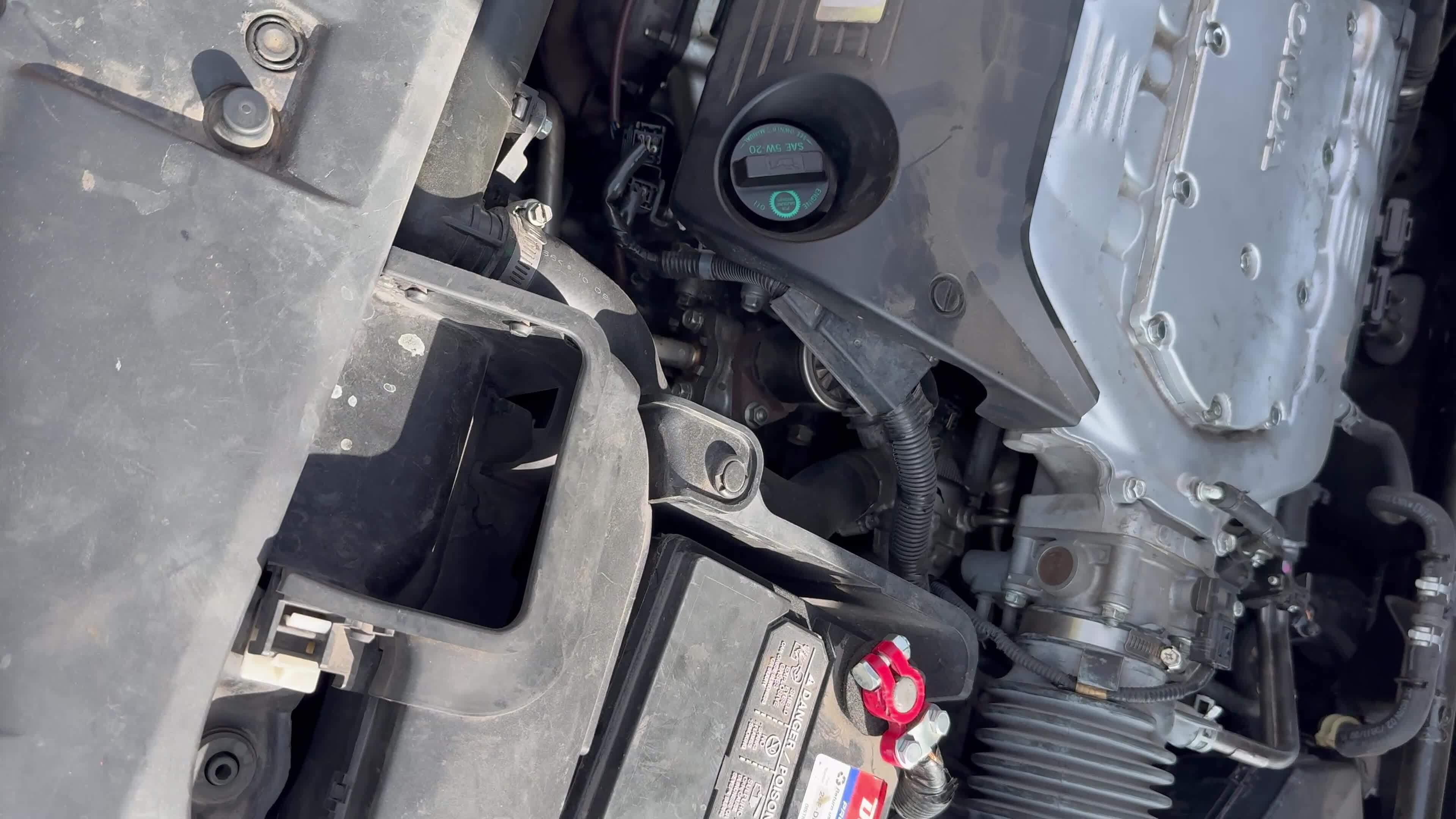

So just a little over a week ago, I had a cylinder 4 misfire code. I replaced the spark plug and ignition coil but that did not fix the issue. I had a cylinder compression test done and cylinder 4 had zero. Ultimately, my mechanic determined it was a cracked cylinder head, and he replaced it. Driving my car these last couple days, I noticed a burning smell but didn’t pay it much attention because I didn’t think it came from my car. But this morning, I noticed the same smell but this time smoke coming from the engine. I noticed what looked like a leak coming from the front exhaust manifold, not sure if the valve cover is leaky too. Thoughts??

Video for reference.

Hard to see where it's coming from. If you remove the plastic engine cover it might let you see into the area better. Then wipe away the oil you find and dust the area with talc or flour. Then start it and look for the spot(s) that get damp fast.

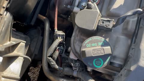

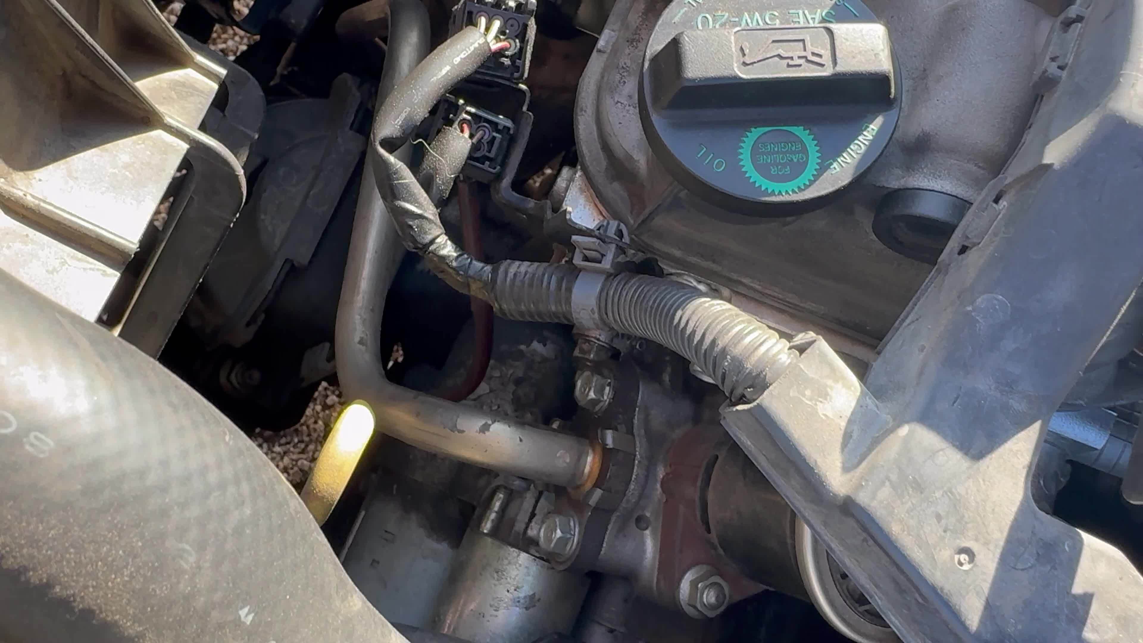

Here’s a clearer video with the plastic cover removed. You can see some oil pooled up in that corner next to the v-tec solenoid.

Clean that up and see if it returns. It might just be spillage that is dripping off onto the exhaust. If it then returns you know it's a leak and can take it back to the shop.
