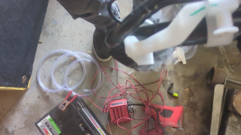

I have been getting EVAP codes P0441 and PO455. I put my smoke machine on and there was smoke coming out of the gas cap. I went to the local Toyota dealership and got an OEM gas cap for my car. That didn't solve the problem, smoke was coming out again. So I think it is the fuel neck gas filler hose. I been having a problem finding one for my car. I have a 2013 Toyota Corolla that was built in Mississippi. The VIN number is 5YFBUEEXDP197201. First of all do you think my diagnosis is correct and were can I find the part for my VIN number?

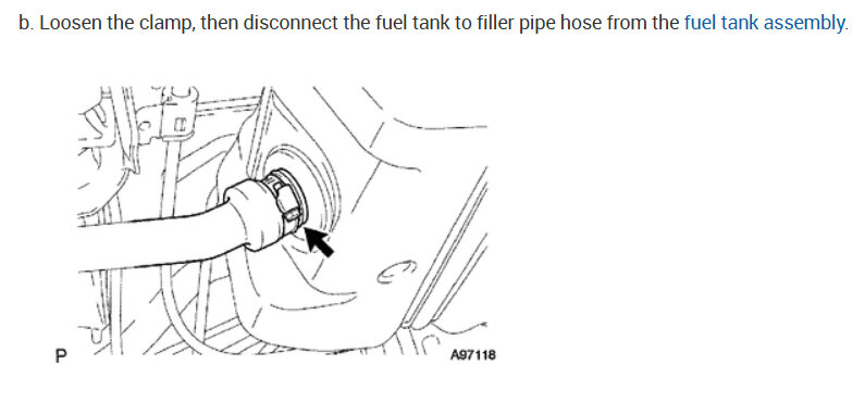

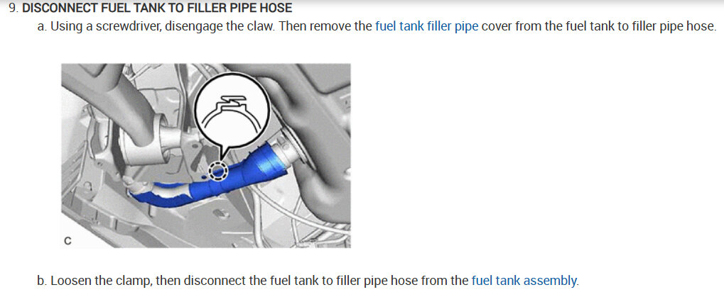

First, drive the car until the gas is on empty or follow this video on how to drain the gas out.
https://www.youtube.com/watch?v=Q5MH2gnyFH0
You will need to raise the car up watch this video to do it safely.
https://www.youtube.com/watch?v=xLFn_bMkZc0
Then remove the clamp at the bottom of the tank, remove the filler tube mounting clamps and then remove the filler tube to replace it with the new unit. If you have problem please upload an image or a short video in your response, so I can see what's going on. Check out the images (below).

I just went out and put brake cleaner on a microfiber towel and went around the the sealing surface with three applications of brake cleaner and did the smoke test. Smoke continue to come out, so that didn't solve the issue.

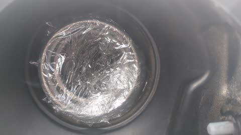

Next, remove the gas cap, then cover the opening with plastic wrap and a rubber band, then do the smoke test again. If you still see smoke escaping, it has to be from something other than the cap. Use plastic that is used for food as it is very thin and easy to form a good seal. Smoke machines only develop around 2 psi of pressure, so it doesn't take much to contain it. Let me know what you find.
Feb 15, 2026 at 1:19 AM (Merged)
RLPETERSON78
  • 147 POSTS
I put plastic wrap over the gas cap with a rubber band securing it. Then I started my smoke machine. I took a video of what it did.
CARADIODOC
  • 34,381 POSTS

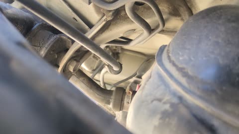

From what I can tell, it looks like the leak is down lower and the smoke is just rising to where it can disperse. It looks like there's no smoke right under the plastic wrap. Are you able to see the filler tube from underneath? Look for that smaller tube and hose I mentioned.
RLPETERSON78
  • 147 POSTS
No I can't see the under the smaller tube. I have ordered a new fuel neck from eBay that I will install.
CARADIODOC
  • 34,381 POSTS
Can you see from under the vehicle if there's smoke down lower? It's also possible to have a cracked / loose / rusted part on top of the gas tank, but by now I suspect you would have noticed gas seeping onto the ground when you filled it. Replacing the filler tube appears to be easier than on a lot of other models. We'll wait to hear from you. Please keep us updated on your progress.

I got a new fuel filler neck from a auto salvage yard and installed it. That didn't solve my problem. I just got a new one and I tested it today and the video shows what I found. I contacted the first guy who I got the new one I installed and he said that it could be the charcoal canister was the cause. What do you think?

First I replaced the fuel neck to the gas tank, then I replaced the charcoal canister 3 times, two brand new and the last one from a salvage yard and every time smoke came out of the gas cap. So nothing I tried fixed my problem. What could possibly be the problem?

I have been spraying soady water everywhere and don't see any holes in any of the EVAP system, and I still have smoke coming out of the gas cap. I have installed 3 different charcoal canisters and they didn't solve the problem. What do you think the problem is?

I plugged up the charcoal canister and put my smoke machine on it. I saw smoke coming out where the fuel pump was (under the seat). I replaced the hose that went from the charcoal canister to the fuel pump and that solve the problem.
