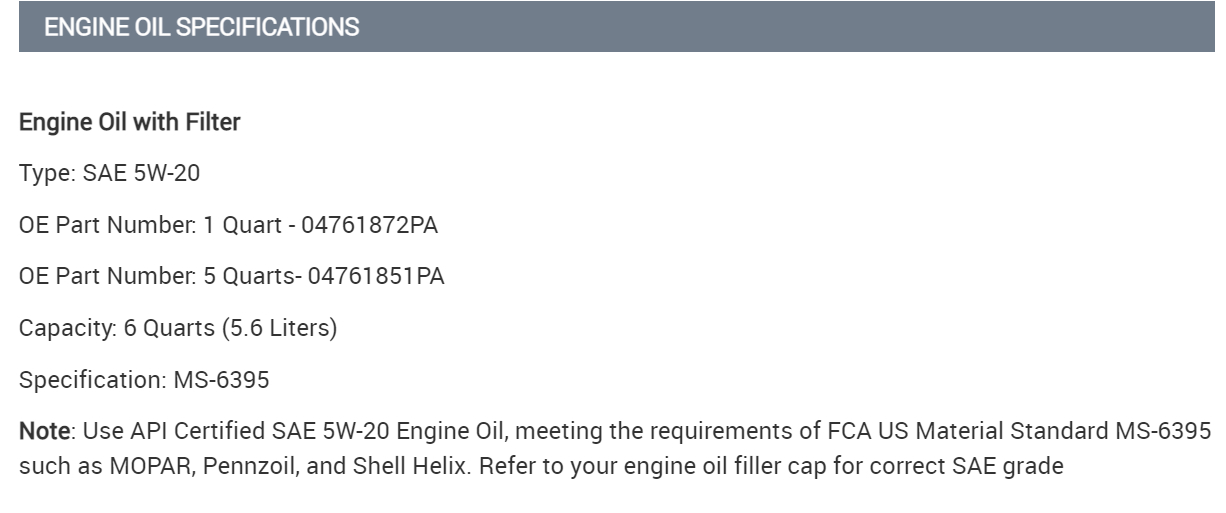

Here is the correct oil type and capacity if there were any noises from the top of the engine. It may have had the wrong engine oil in it to begin with. Most quick lube places throw whatever oil they have in the vehicles that come in.
