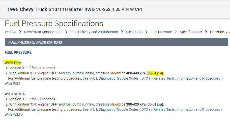

So, where do we start? When was the last tune-up? Have you checked the fuel pump pressure to make sure it is within the manufacturer's pressure specifications?
Start with this. First, confirm there are no restrictions between the air filter and throttle body. If that is good, check the fuel pump pressure.
Here is a link that explains how to test it?
I attached the manufacturer's pressure specifications below. You will need a fuel pressure gauge to do this, but most parts stores lend one to you.

Here is more information: There are no restrictions between the air filter and the throttle body. Fuel pump pressure is 54 psi, not running. It has good compression, cylinders are as follows: # 1/170, #2/170, #3/170, #4/180, #5/170 and #6/175. I installed a new harmonic balancer, air conditioning compressor and the serpentine belt a month ago. Timing is where it is supposed to be. The brown and black wire under the passenger side dash was disconnected when I checked the timing as the manual says to do and has been reconnected. The engine has good spark, the plugs are gapped at 45, In my opinion, they look normal for an emission equipped vehicle, they look lean. I put a vacuum gauge on the truck and it's running in the normal range. The truck's idle is really rough though. It revs high while I am driving. The idle when waiting at a red light, revs up unexpectedly at times, eager to leap forward. It catches me off guard. No current trouble codes showing, but recently the code 35 for high idle came up a few times. What else can I check? I'm stumped.

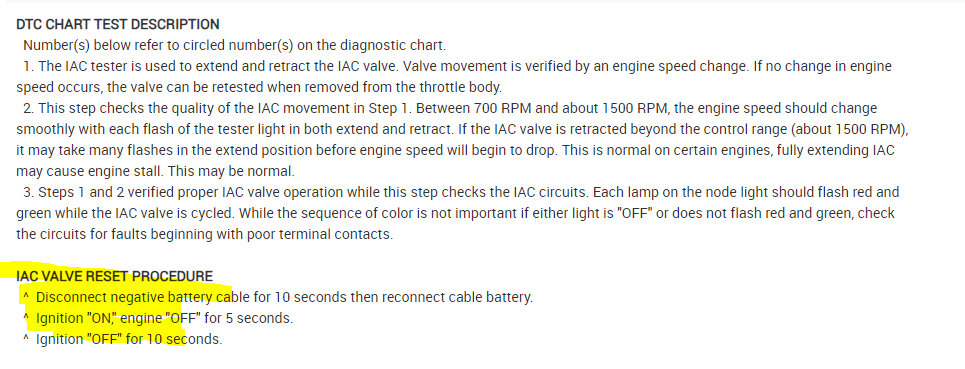

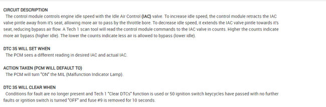

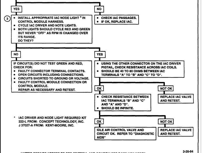

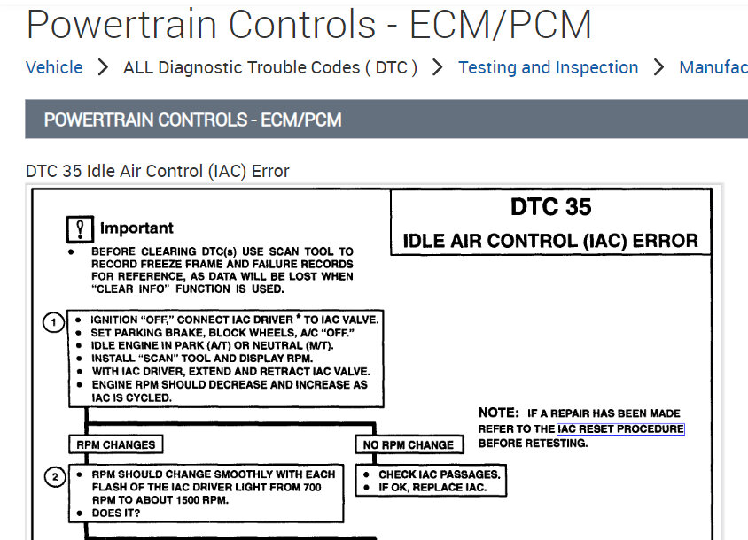

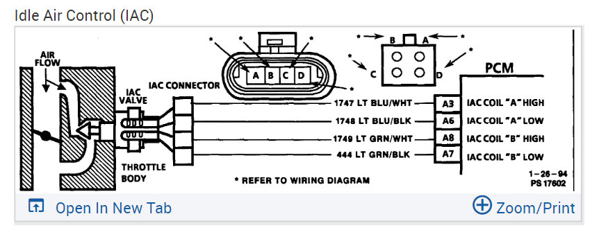

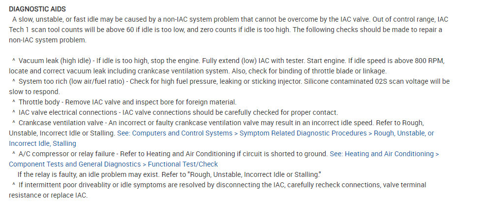

The issue appears to be related to the idle air control valve. If you look below, I attached the diagnostics related to the code (35).
Take a look through the diagnostics and let me know if you are comfortable performing them.

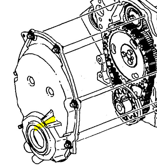

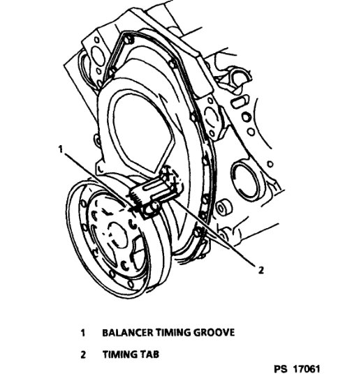

Hi Joe, Do you know why the harmonic balancer I just bought has one timing mark and the original one had two? They are 90 degrees apart. Thanks for your help.
Apr 24, 2024 at 1:43 PM
  • 110,248 POSTS
Unfortunately, I can't answer that. However, the single mark on the new one should be where it needs to be.
I tried looking up info to see if anything was indicated, but the only thing I found shows one. Take a look at where the keyway on the crankshaft is located. Check to see if the new one aligns with it in the correct position based on where the old one would have set.
See pic below.
Apr 25, 2024 at 12:06 PM

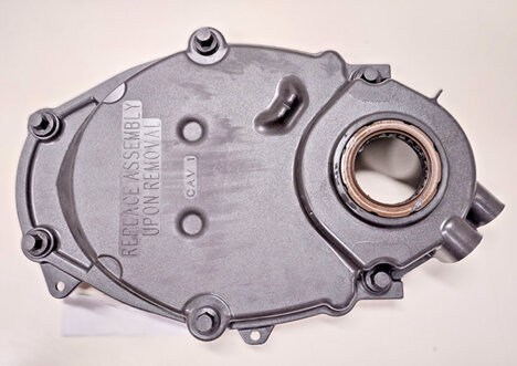

Hi Joe,
That does not look like the one I have. The one I have fits 1995 Blazer up to 2005. The timing chain cover is plastic.
Apr 26, 2024 at 5:13 PM
  • 110,248 POSTS
They likely used the pic I attached as an example. Take a look at the one I attached below. It is for the same engine. The picture is from the directions to replace the timing chain.
Let me know your thoughts.
See pic below.

Yes, that is a picture of the one I have and that's the TDC mark. but there is only one mark so why would the original dampener have two? Everything I have read says the one I have is the correct one, but I don't understand how it could be correct when the original one I replaced had two marks. I'm getting desperate here because I can't find the timing mark when it is running. I don't know what to do at this point. Thanks for your help.
Apr 28, 2024 at 7:01 AM
  • 110,248 POSTS
I'm not sure why the OEM had two marks. That is odd. However, the new one's mark has to be the correct mark otherwise you would never be able to get it in time.
