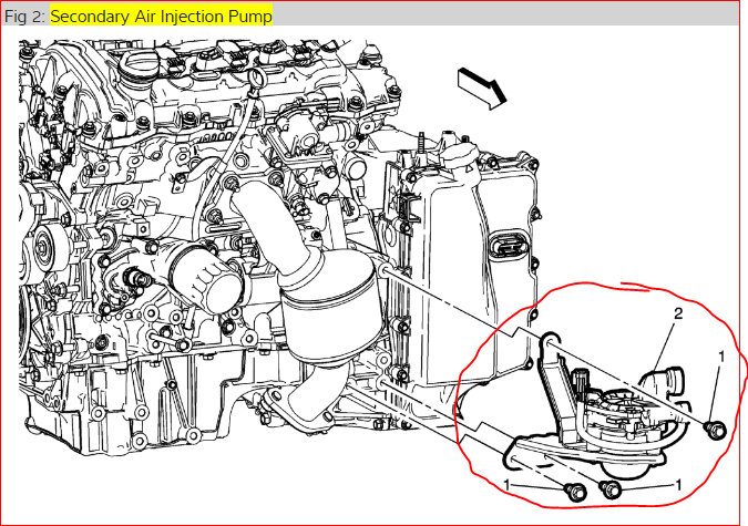

My boyfriend has disconnected my smog pump but he cannot remove it from the car. He has removed the fender wall and headlight but it still won't come out. Any special trick to it maybe?

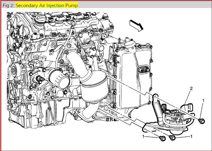

I've attached two pictures below for you to view. Hope this helps and thanks for using 2CarPros.

Looking at the diagrams it seems like you will need to remove the radiator? This guide will walk you through the steps.
https://www.2carpros.com/articles/how-to-replace-a-car-radiator
Can you upload a picture or video of the trouble so we can see?

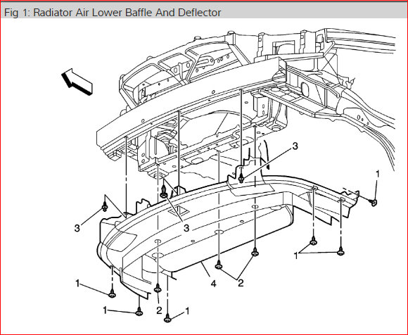

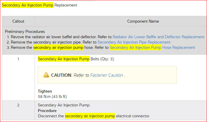

I rechecked the guides and in addition to the pictures I sent you it just states to remove the radiator air baffle/deflector.That is on the bottom of the bumper and protects the underneath of the car/radiator. I've attached a picture of it below.With that being removed you should be able to remove the smog pump through the bottom of the air baffle/deflector through the opening.It doesn't say to remove radiator but if you do it's extra work but you will have more room-It's up to you.Here are the pictures below.Hope this helps and thanks again for using 2CarPros.

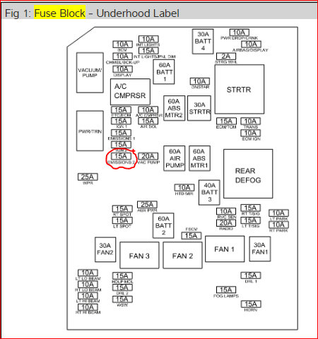

So we ended up removing the smog pump and putting a new smog pump in but my check engine light came back on. So now I am wondering if I should replace the check valve next or the relay or if I should check the fuse or something like that. Thanks for your advice.

Do you happen to remember what the code number that came back on was? Here is a tutorial on how to check fuses:
The fuse to check is labeled emissions 2. I've attached a picture below and circled in red.Thanks again for using 2CarPros.
