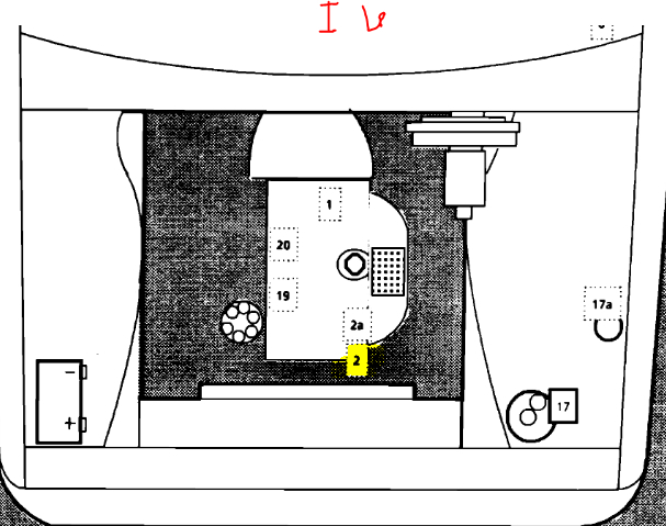

Im trying to put a smog pump on and I can't seem to find the location the smog pump came with brackets in a tensioner adjuster already on it but I can't find where to install them can somebody please help with photos of one on or something

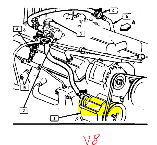

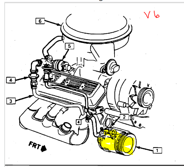

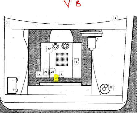

Hi:
I'm not sure what size engine you have. It came with an I-6, a V6, and a V8. I attached what I have for each engine. But I went with a 1/2 ton 2wd, without CA emissions.
Take a look and let me know if this helps.
