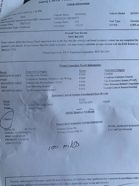

I fixed the "check engine light on" problems by replacing the new oxygen senor. After that, I have driven for more than 500 miles so far. However, it is still not ready for smog, because when the technician checked by OBDII, it indicated that "Catalyst not read". does it mean I will fail the smog check? I was told that I need to drive more miles and fill the tank with high quality gasoline (91#). Is that true?
please advise.
appreciate your help.

What is the actual code that you have. There are many things that can prevent the catalyst monitor from running. Is the CEL out now? Did you use a scan tool to clear all of the codes? There can be codes that do not set the light on, but that can keep tests from running.

the CEL is off after the oxygen sensors have been replaced. the Scan tool only showed "Cat not ready". The mechanic just told me to keep driving more and use the best quality gasoline to fill up the tank. I asked him any other possible mechanic issues and he said "no"...

The Toyota drive cycle for that monitor to run calls for a warm engine, no codes of any type and then drive at a steady speed for 7-10 minutes at between 40 and 70 MPH. So say 10 minutes at 55 mph. Then check the monitor status. If needed drive the cycle again. If the monitor still does not set then you need to use a dealer level scan tool to check that there are no pending codes in any other system, as well as checking the O2 sensor signals to be sure they are correct. Better gas won't make a difference.

Initially, the CEL was on, so I paid the smog station to do a full diagnose and fixed the issues by replacing the new oxygen sensors. Then I was told I have to drive more miles, put high quality gasoline etc. in order for the Catalyst to be ready. However, the OBDII scanner still indicated "CAT not ready" and everything else all "PASS".Attached please see the SMOG report. The dealer would charge $200.00 for the diagnosis. Is it worthwhile? Please advice.

If you have driven the vehicle but it still has not set then there is something wrong. Either there is something blocking it from running or there is another fault that hasn't been detected yet. You don't have to use a dealer, just someone who has a full line scan tool that can check all the modules for faults. Another option would be to reset all of the monitors and drive it and see if it runs them all or sets the CEL on.
