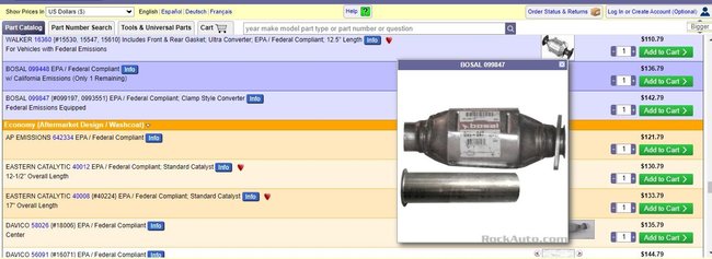

Jun 30, 2020 at 7:00 AM
Yes, they sell parts based on what you want to spend.
You will need to spend upwards of $300.00 for a quality catalytic converter.
Actually Bosal and Walker are not that bad for your truck.
I attached from rockauto for you. About $200.00 seems right.
Jun 30, 2020 at 8:31 AM
