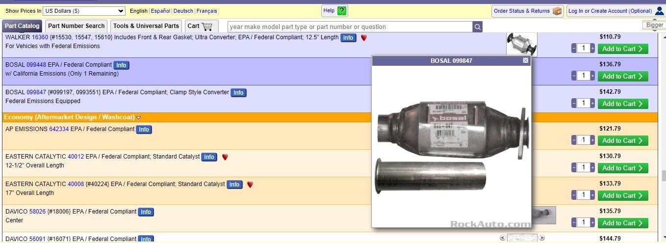

What brand converter did you use. Cheap catalytic converters will do next to nothing.
I use either Bosal or Walker as they have 5 year warranties on them.

well, this is a cheap brand it was $150.00 for the catalytic converter i installed myself. so this cal cat catalytic converter is probably made in China and i'm sure they're looking for payback anyway they can get it. but how can Napa sell a piece of junk like that? because i don't see any way of passing with this catalytic converter.
Jun 30, 2020 at 2:00 PM
Yes, they sell parts based on what you want to spend.
You will need to spend upwards of $300.00 for a quality catalytic converter.
Actually Bosal and Walker are not that bad for your truck.
I attached from rockauto for you. About $200.00 seems right.
