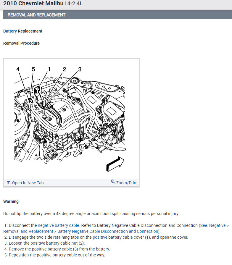

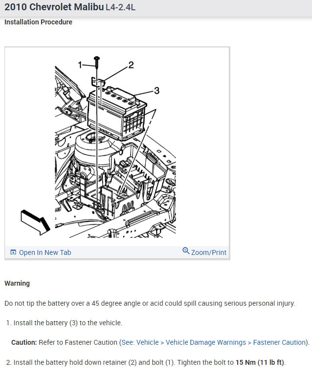

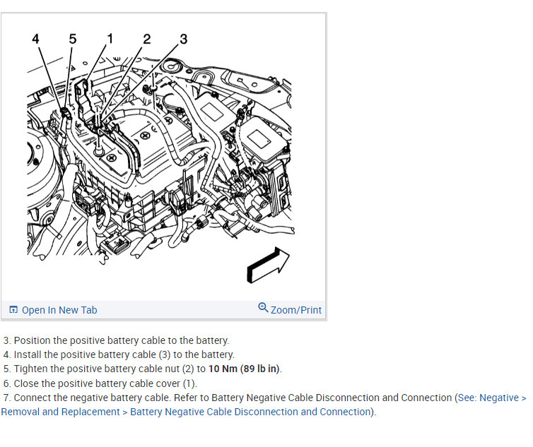

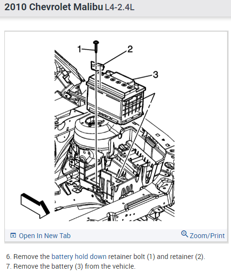

The stink for sulfur or egg smell means your battery is leaking acid.
That smell can also be associated with the catalytic converter but since you have the battery issue all of a sudden it is likely the battery.
Carefully inspect the battery for leakage. If it is leaking replace it.
