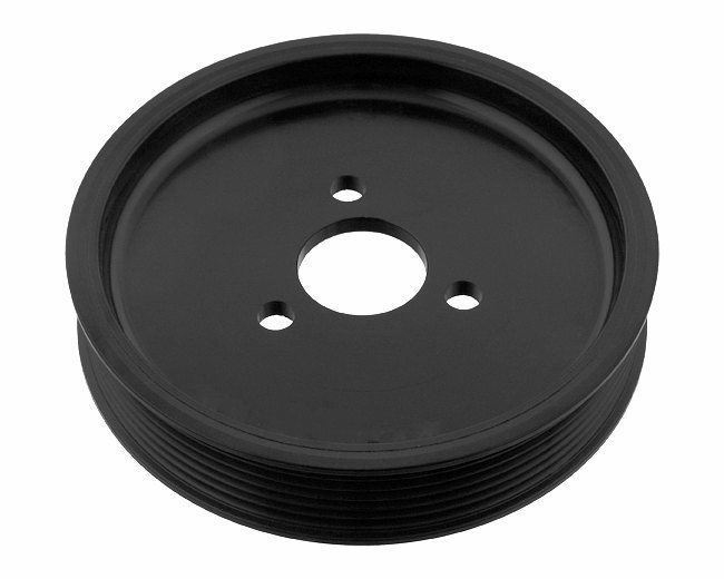

very old car, power steering broken, cannot get replacement pulley.
do you know if FEBI 30123
or
BMW E39 E46 Z3 Power Steering Pump Pulley 131mm FEBI Diameter 32421740858
or
http://picclick.ca/FEBI-BILSTEIN-Germany-Power-Steering-Pump-Pulley-30123-291896993438.html
http://picclick.ca/FEBI-BILSTEIN-Germany-Power-Steering-Pump-Pulley-30123-291931219038.html
would work in the Mercedes?
You can see I am not a mechanic, so i do not know much, but I love that old car! Can you help me? The garage is going to tow!

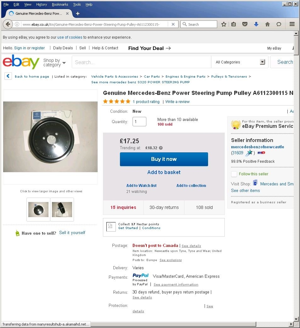

I really need to know what I can substitute now. There are lots of BMW 3-series Power Steering Pump Pulleys here - can i safely use one? BMW PART NO - 32421740858
(Or FEBI 30123 Pulley)
Can it work instead of Mercedes original part number A6112300115 Power Steering Pump Pulley for Mercedes-Benz C-Class (W203) ML (W164) & E-Class (W210)
They look the same - can anyone compare the specs?

Dear HMAC300,
We bought the BMW P/S Pully and it is identical except it is not plastice like the Mercedes original, and itis 4 mm smaller diameter. (since it is a tensioner pulley - that may not matter?) and seems identical in every other aspect.
The car is actually a 2005 W211 E320CDI and is super great in every way except the cruddy plastic Mercedes pulley.
We are going to try a BMW Aluminum pulley just because.
Thanks so much for the tests.
I will keep you posted.

with the 4 mm difference is not a lot but it may take the tensioner to it upper limit which would have you get a different belt to compensate for that. good luck

Substitute BMW 3-series power steering pump pulley worked fine for next 100 km. Will post again if any change.

Would a movie of the BMW aluminium power steering pump pulley installed in the 2005 W211 E320CDI and running (taken with an iPhone) help an expert decide whether it's safe to leave it in? It's been driven for 3 days now and seems perfect.
I was looking for someone who could compare the manufacturing shop drawings for the 2 parts. Is there no-one who can tell me how to find them or help by comparing them? It does look as if the 4mm difference in circumference doesn't matter and the rest LOOKS identical.
It may be better to order a replacement Mercedes part now that the BMW one has bought us some time for it to be delivered. Maybe aluminium is bad to put there?
Can i send you the iPhone movie of the replacement running? How?

4mm is about a little more than 1/8" diff so it's ok if you want regular merecedes part then do so because the new may be steel or aluminum. the only thing with aluminum is it can corrode which I don't think it will on p/s pump and shouldn't matter anyhow.
We can't be SURE the BMW part is identical without the manufacturer drawings with the measurements of things like rib widths and depths and hub offset. Maybe it's better not to take a chance?

A 4mm difference is not enough to effect anything. You will be okay.

you have to go to the manufacturer of the pulley who supplies it for drawings etc. which they will not give you anyhow because it's I n current production
