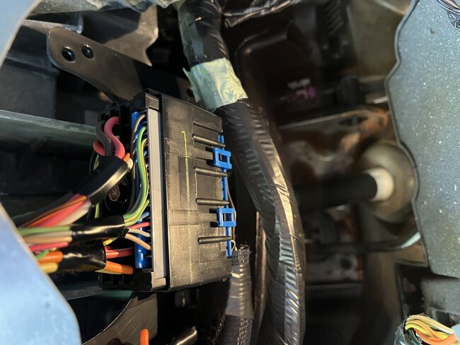

No problem. We need to first access the module which is under the dash on the driver's side of the vehicle.
I attached directions to access (or remove) the module. All we need to do is access it.
At the module, there will be three electrical connectors. Two will have several wires and one of them will only have four wires. One of them is the orange wire. See the last pic below.
If you can, back probe the orange wire to check for power. If you are unable to back probe it, remove only that connector and check the pin for the orange wire for power. You can use a voltmeter, multimeter, or test light for this test. Whichever you have will work.
Let me know what you find.
See pics below. Note: The directions indicate removing the vent tube (pic 4). I can't remember if that is necessary, so double-check before you give yourself more work. LOL
Oct 19, 2023 at 12:39 PM

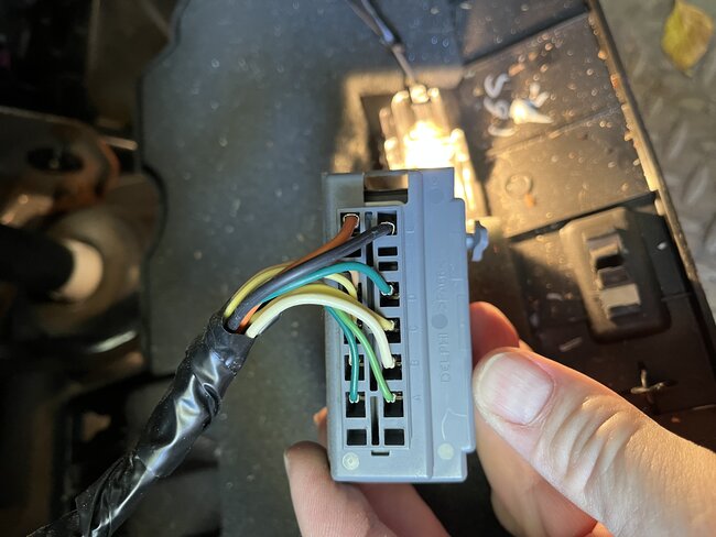

Okay, I got some things removed. I see 2 plugs that are roughly 3” long. (See pics).
Do I want to probe the orange wire from the grey plug?

Here are the pics.
Oct 20, 2023 at 2:57 AM
JIMMYPAGE
  • 40 POSTS
Update: probing the orange wire from the grey plug, my test light turns on.
Oct 20, 2023 at 3:01 AM
  • 110,240 POSTS
Thanks for the update. If you have power present, there is a chance the module itself has failed. Is your scan tool bi-directional? We need to see if the module can be actuated manually via a scan tool.
However, check to make sure the black wire has continuity to ground. It could be a ground issue as well.
Oct 20, 2023 at 7:47 AM
