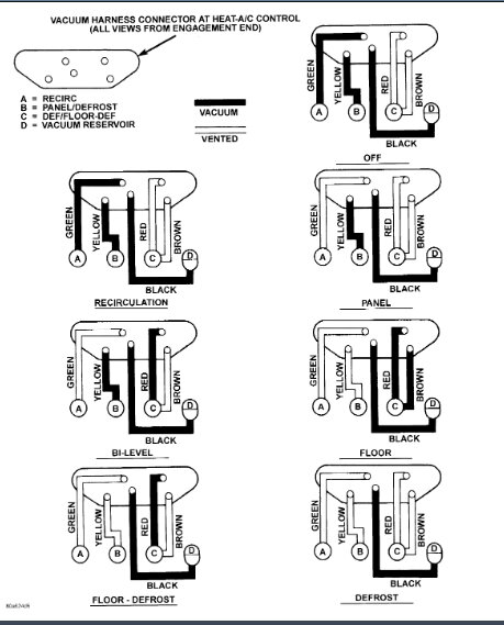

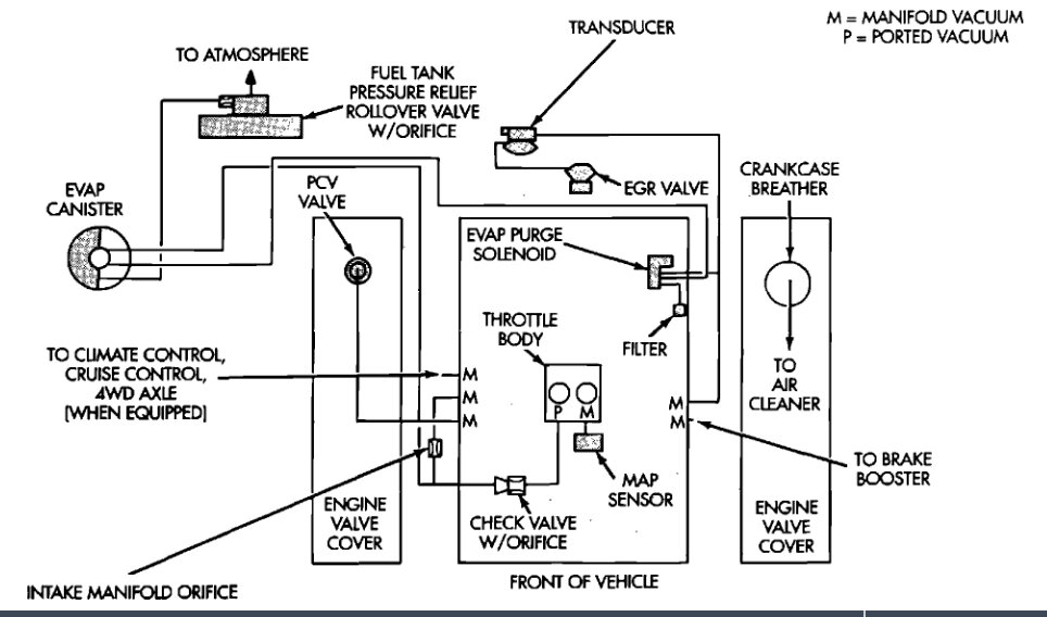

Small plastic vacuum lines replacement diagram needed?
300,000 MILES • 5.9L • V8 • 2WD • AUTOMATIC
OLLIE2022
  • 49 POSTS
Diagram or picture of the plastic vacuum line placement.
Dec 9, 2022 at 6:26 AM
  • 110,248 POSTS
I do have a vacuum schematic for the emissions control systems. Also, the HVAC actuators are controlled by an engine vacuum.
Pic 1 below is the emissions system schematic and pic 2 is related to the HVAC circuit.
