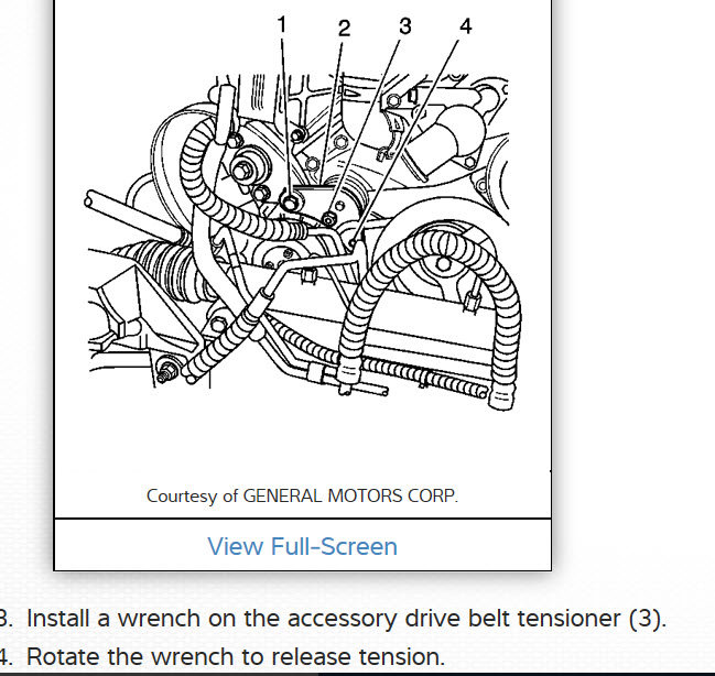

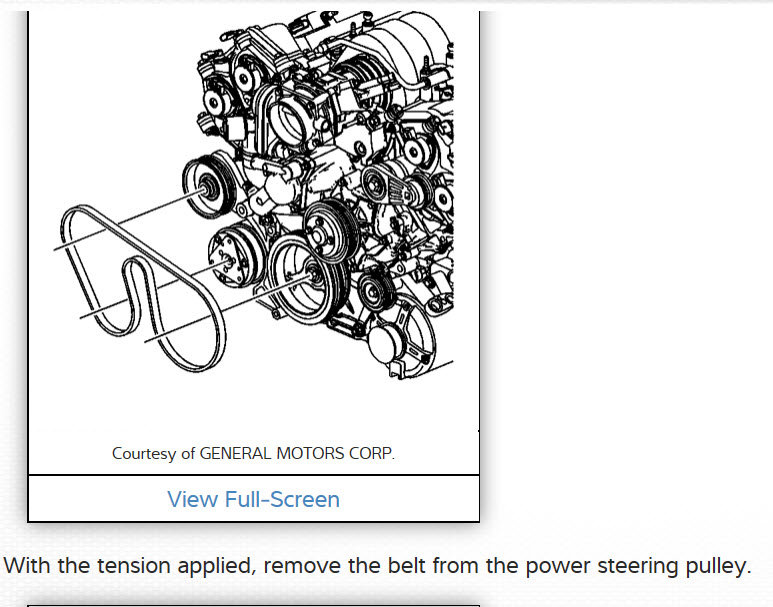

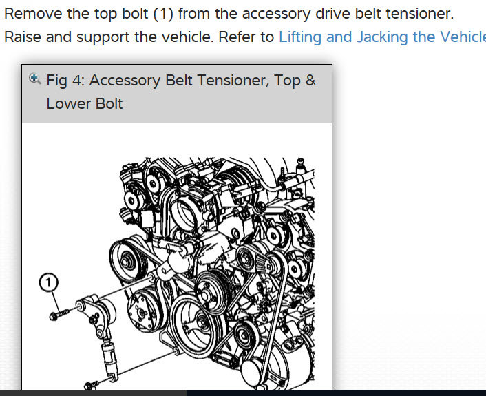

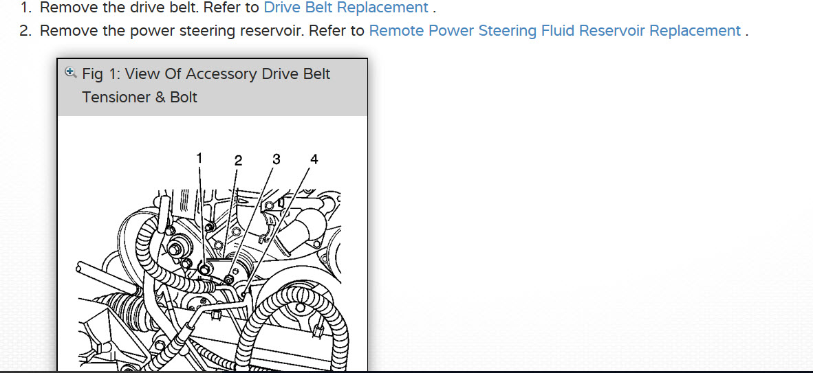

How to put on power steering belt?
Friday, January 13th, 2017 AT 8:01 PM
HMAC300
MECHANIC
48,601 POSTS
See pictures for instructions. Tensioner should be replaced along with belt. Assembly is reverse of removal.
