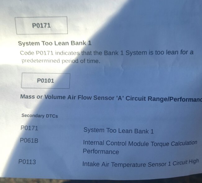

The car drives fine but it is a little sluggish when pressing the gas. It has a P0171 & P0101. I have already changed the MAF sensor & IAT sensor but it is still doing the same thing.

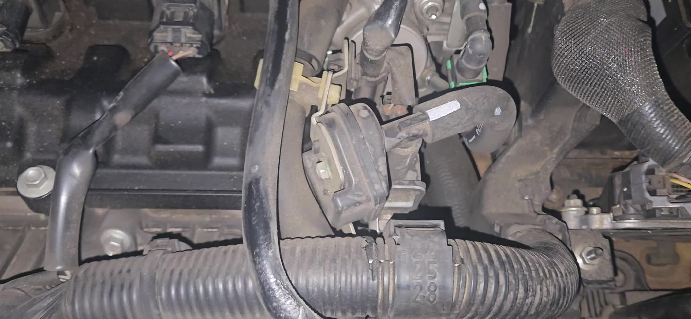

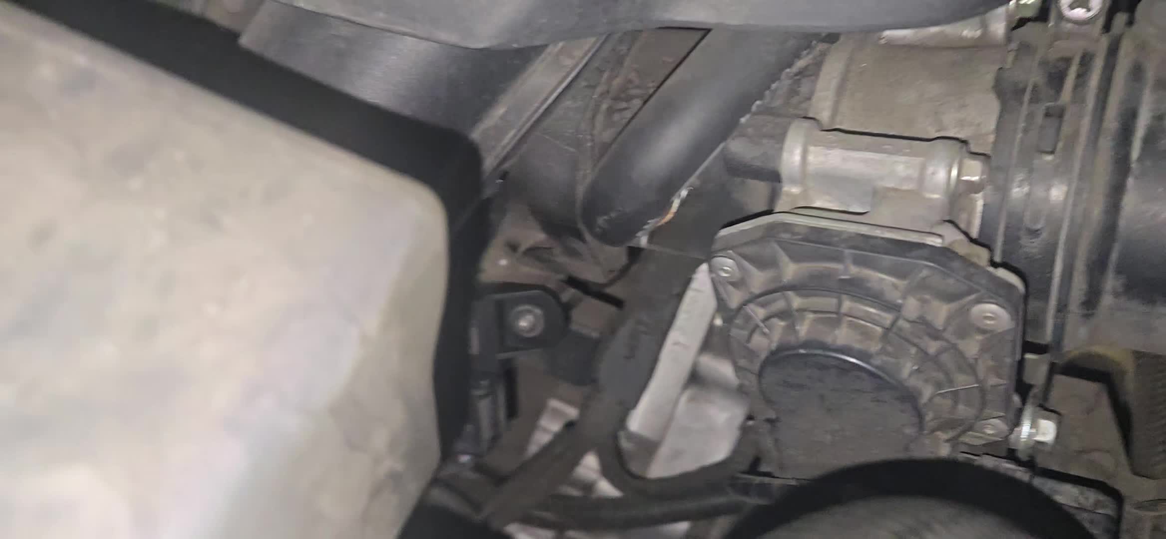

These are the codes that came up. I have cleaned & replaced the MAF sensor & the IAT sensor. I have also to the intake boot (according tube) to see if there was any kind of hole or tear in it & to clean the throttle plate (butterfly). It Idles fine in P, N & Drive. & it mostly drives fine, but sometimes it will stutter/hesitate when pressing the accelerator. (Especially going up a hill)

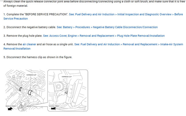

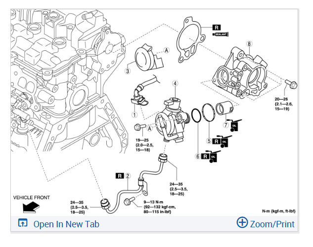

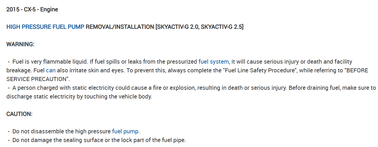

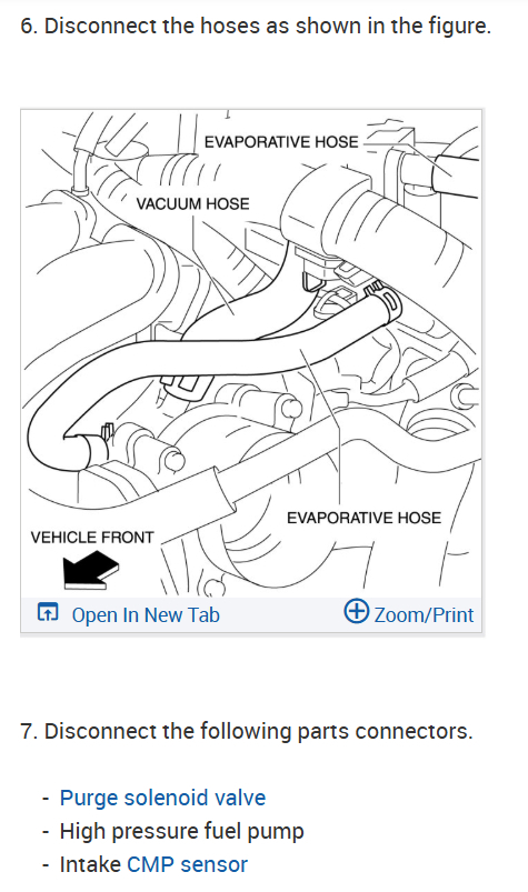

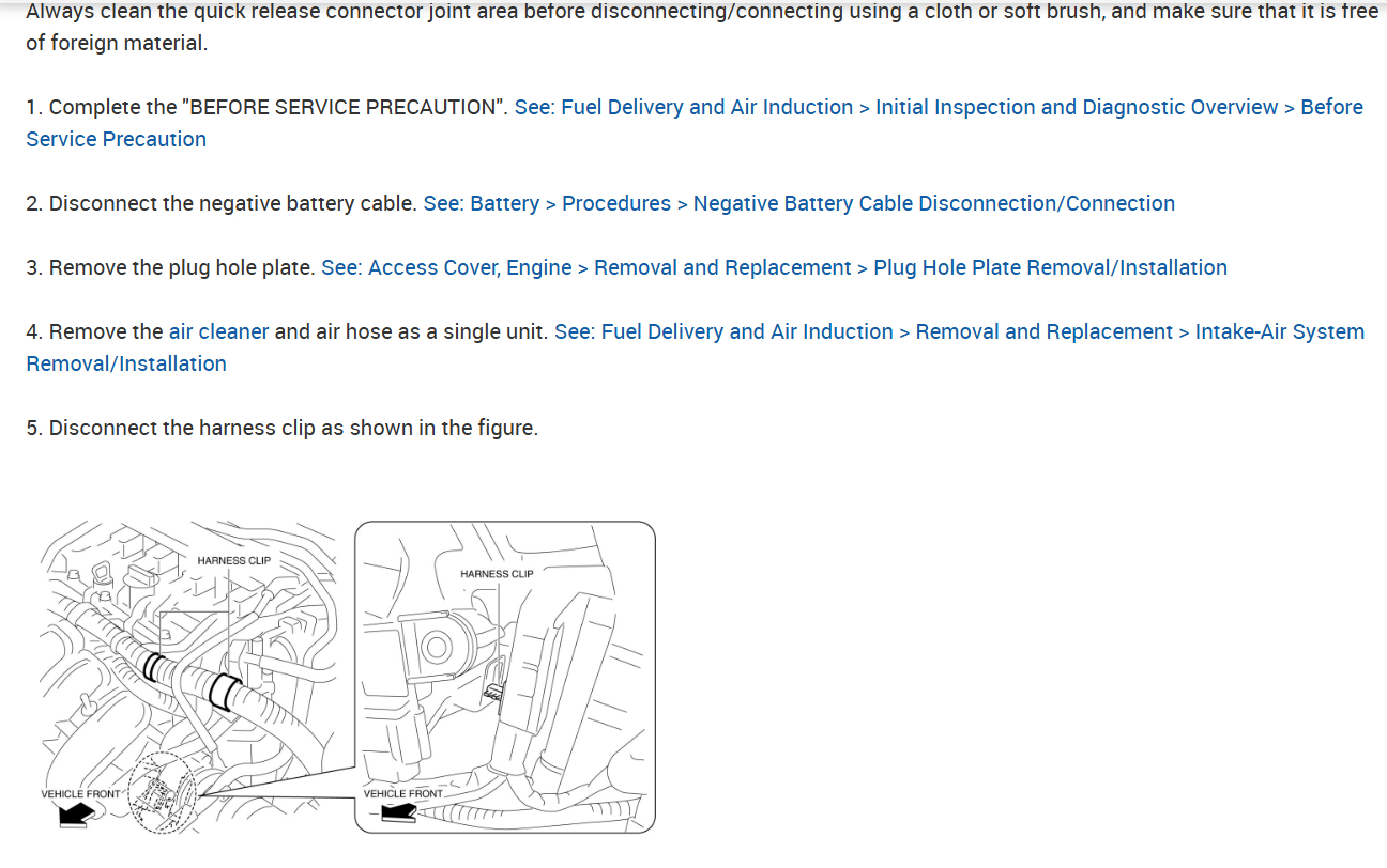

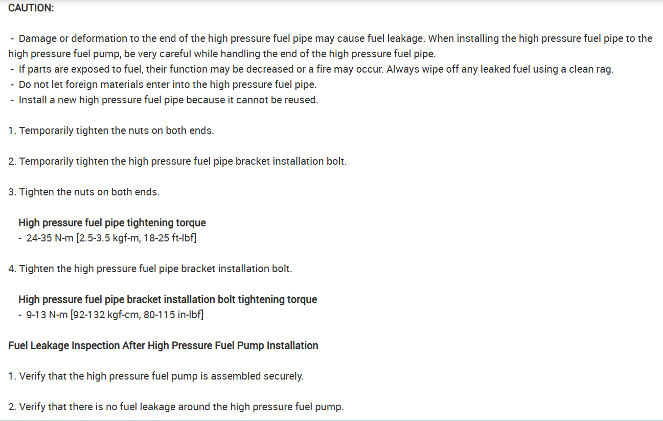

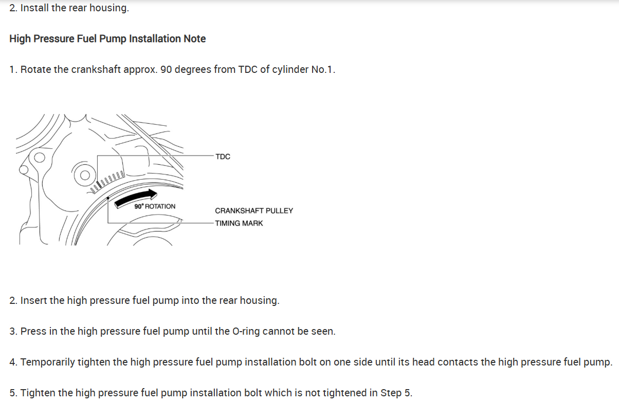

Thanks for the engine running video, do you hear that click noise it can be the high pressure fuel pump is going out. I would remove the pump for inspection/replacement, also, did you check the cat using the video?
Here is the location for the HPFP.
IF the MAF sensor code is still there after the sensor replacement, I would recheck the cat first.

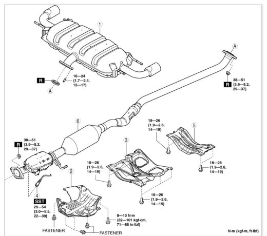

Here is the cat location as well
