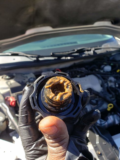

when i filled up the radiator to full the reservoir drained and after driving a block I noticed a sound of water in the dash. When I accelerated from. A stop is sounded like water and bubbles rushing back against the dash. The heater had a smell strange at first unless i got used to the smell. Then the heat started filling the car with fog. The window fogged up. Next day I figured I'd check the radiator again and it was caked with a brown sludge under the cap. Lots of it. Reading online saying it could be bad Dex coolant gone bad and turned to sludge. I have heard it can be a head gasket. A cracked block. I have heard it could be coolant leaking into the transmission cooler. I don't. Transmission fluid in the radiator. Doesn't overheat. Took it to the dealer and he said hes going to have his mechanic look at it but i'm lost as to what to do.

VERTIMUSMAXIMUS
Here is a photo of the radiator. There was more then this. The entire mouth was clogged into the cap like clay or gel.

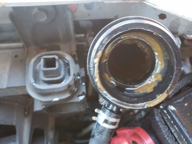

VERTIMUSMAXIMUS
here is another from a mechanic from another country, but it's hard to understand what he says so I was really lost after we spoke. His accent was hard for me. I could tell he was having a hard time hearing me too. He would stare at me when I spoke to him like he didn't understand me.

This is oil. We need to do the head gasket test from above. Let's start with that and go from there. Let me know if you have questions. Thanks.
