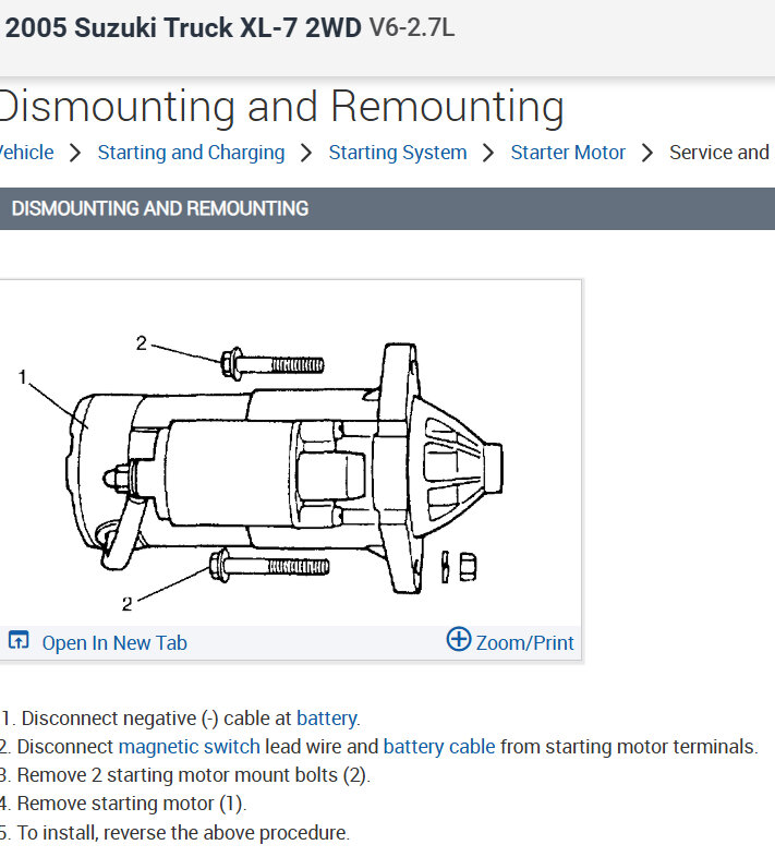

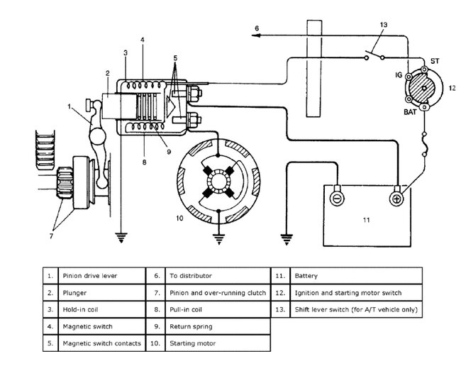

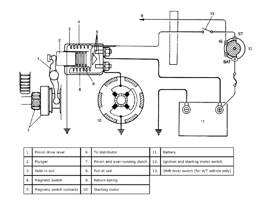

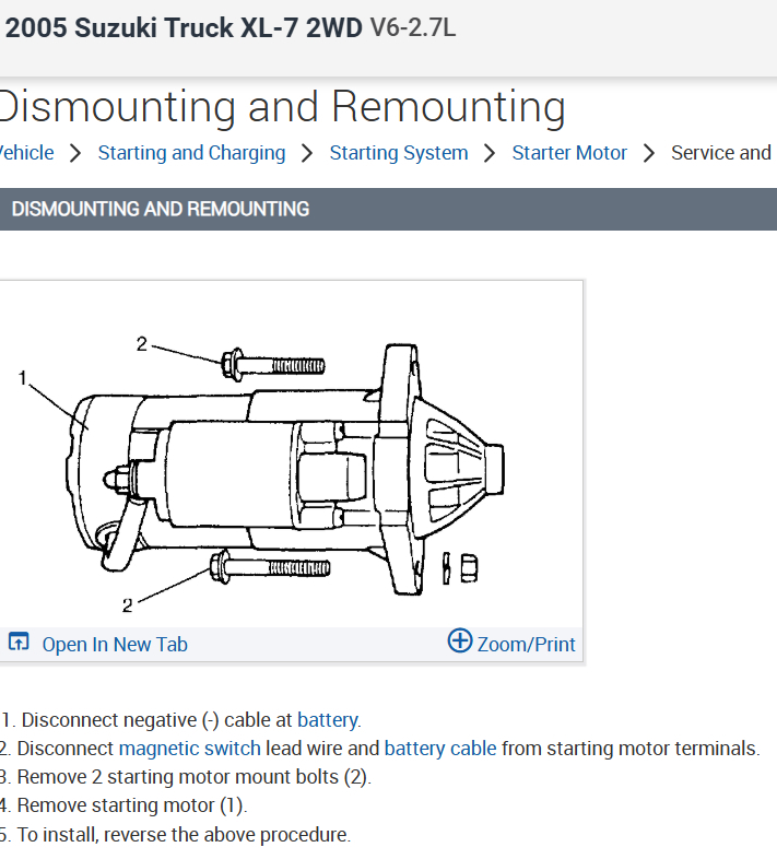

Thank you for the video, it helps. the first thing to do is make sure the battery cables have a good connection and the terminals are clean, this guide can help:
Next, make sure the battery ground to engine block/cylinder head and the ground to the chassis is good. If these are okay, I would replace the starter motor. Here is how in the images below. Check out the images (below). Let us know how it goes and please upload images of any cable or connection that is questionable.

Nice work, the grounds I speak of go from the battery to the engine and a smaller wiring going from the battery to the chassis. So, the engine will have a good ground as well as the car. You can depend on one cable to ground the car.
