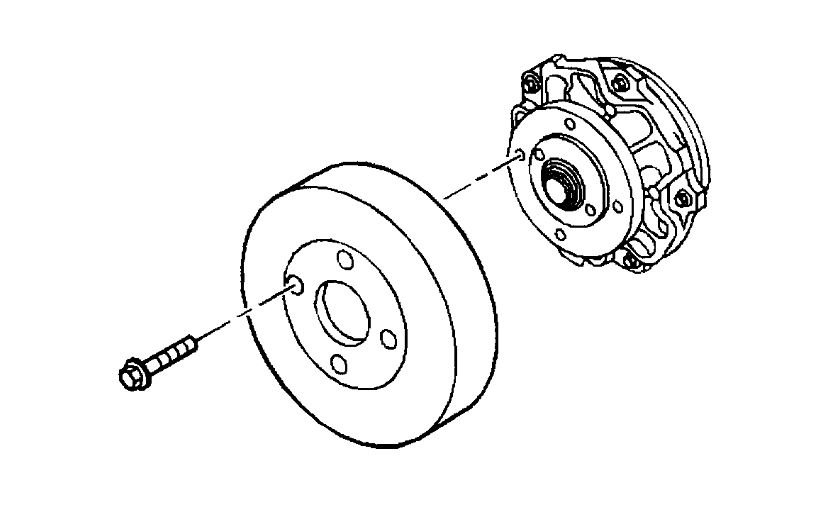

After I turn the car off there is a coolant leak from the area under the serpentine belt. Where do you think that it originates?

It sounds like you may need a water pump which is run by the belt.
You need to do a pressure test to verify.

2. Loosen the water pump pulley bolts.
3. Remove the drive belt.
4. Remove the water pump pulley bolts and pulley.

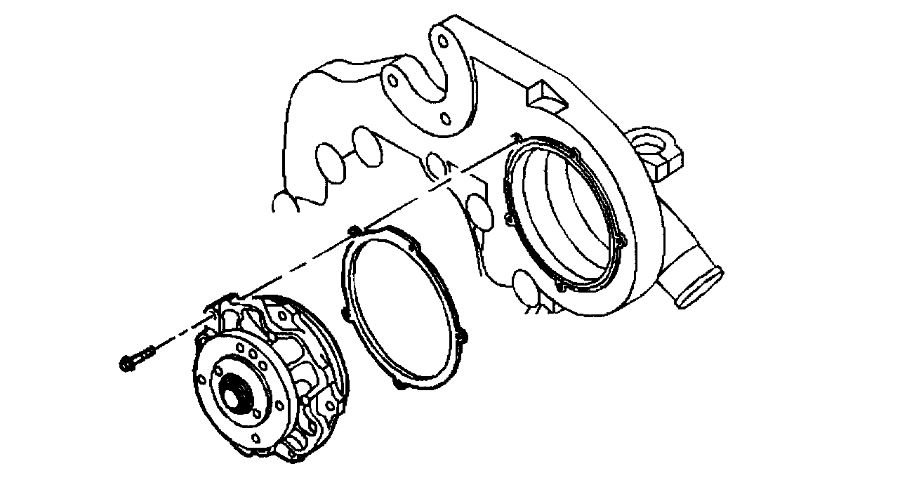

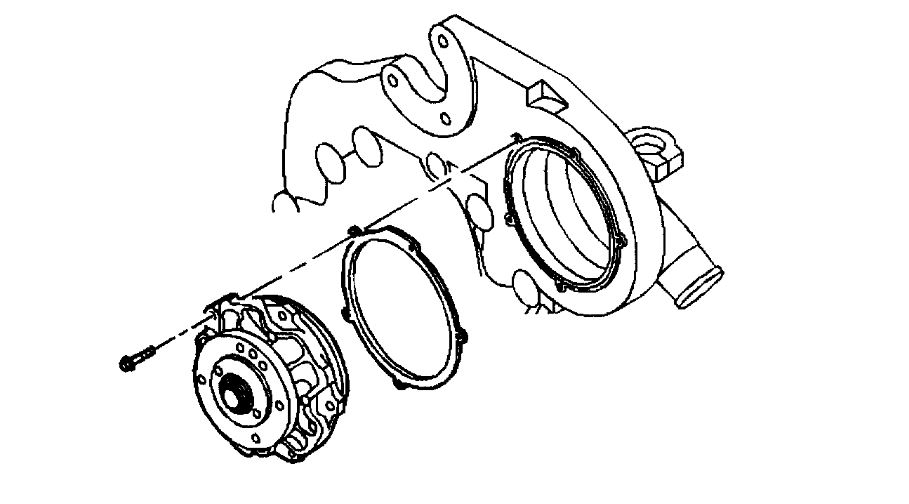

5. Remove the water pump bolts, pump and gasket.
6. Clean the water pump mating surfaces.
