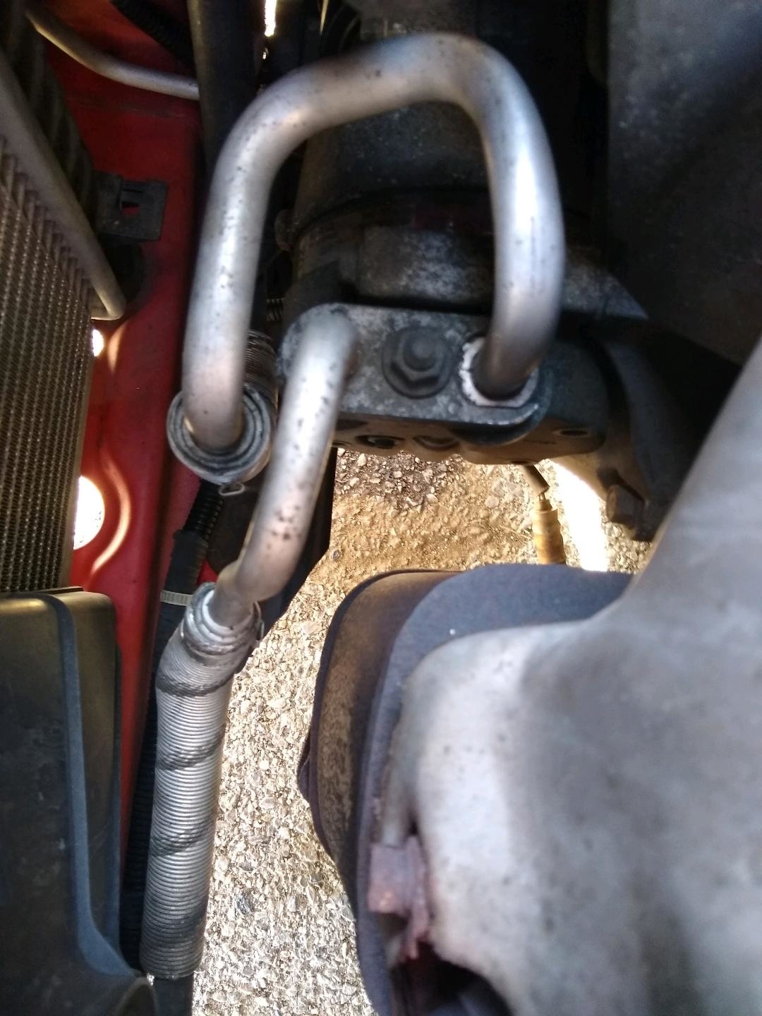

Just got a Water pump and TB job done. Noticed a leak near compressor or manifold pipe. Looks like a clear liquid, it's not oil, antifreeze or transmission fluid. No odor to fluid.
Any idea what this might be? The leak happens when the car has sat overnight. Gasket or seal? Leak is a very small drip.

Are you using the A/C or the defroster? Both of these will cause the compressor to engage which will and can cause condensation, specifically on the steel AC pressure lines. Since it is clean and odorless, this is what I suspect you are seeing.
Do me a favor. Take a pic of what you are seeing and upload of for me. Hopefully, I will be able to identify it.
Also, I don't know where you are, but if you could avoid using either the A/C or defroster for a day, you could check it the next day to see if there is anything there.

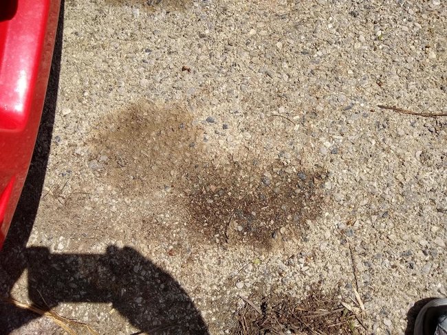

Hello, sorry to get back to you so late, life is busy! I have a picture of the area, it created a spot on the ground, water does not do that. It may be oil from the compressor, I placed my hand under where the compressor is, the splash guard is below it. Wiped away excess oil, I could not feel where the "leak" was, it is dry there. Maybe excess oil was spilled when the oil change was done? The darkest spot in picture is the "leak." Oil, transmission and coolant levels are fine, not losing any.

I do see it. Here is what I suggest. Place cardboard under it when parted to see if it is still leaking. It's nearly impossible to determine what that could be simply because it appears to have been absorbed into the concrete.
With a little luck, maybe they did spill some when the oil was changed, and the leak has stopped.

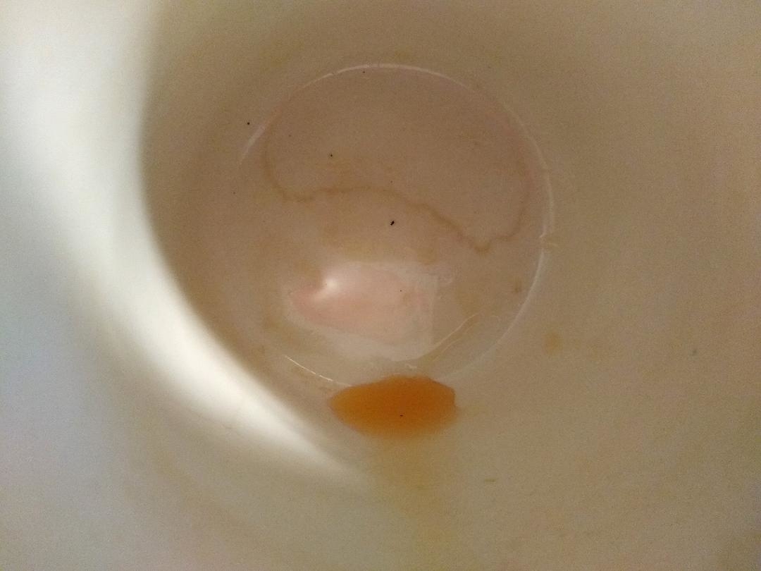

RPJ
  • 109 POSTS

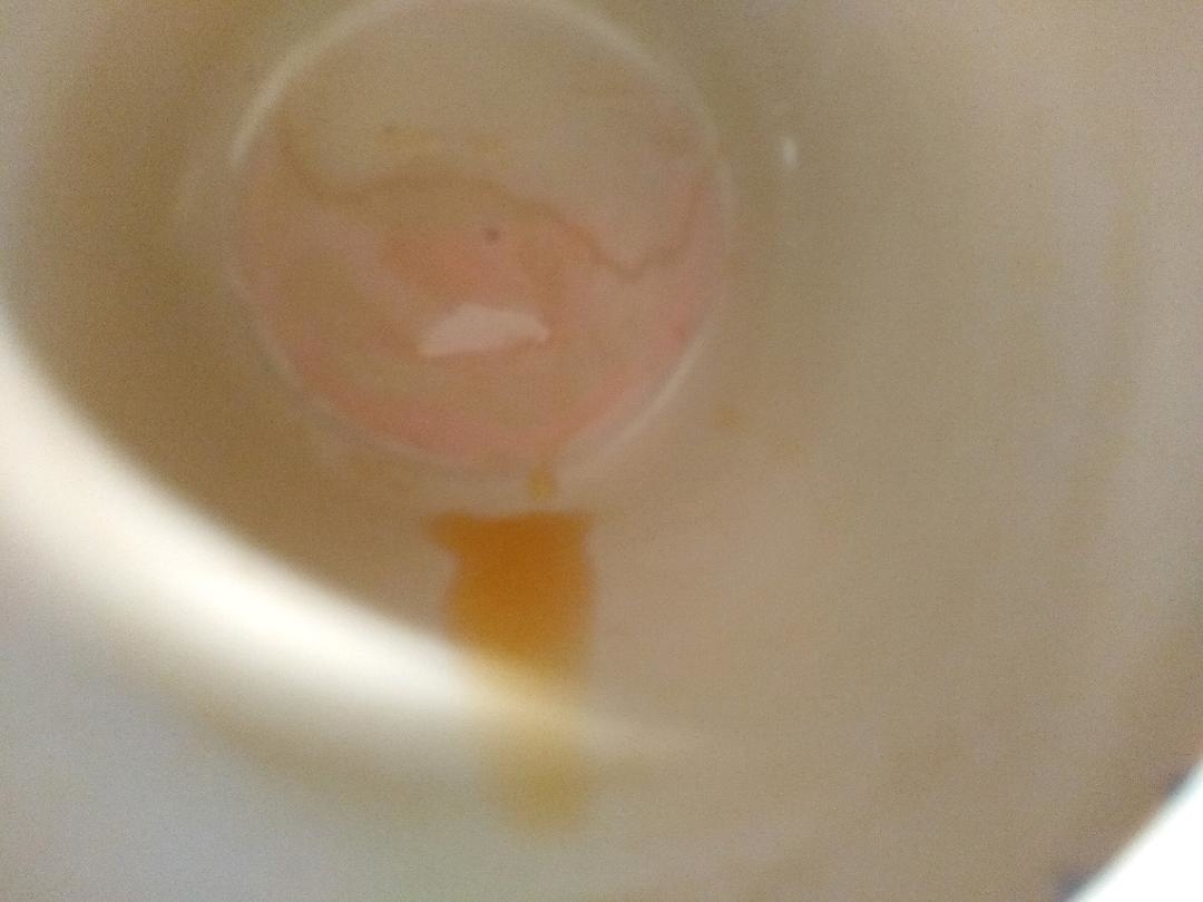

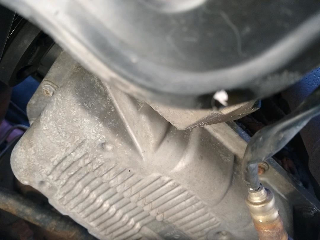

Hello Joe,
Here are some pictures from the vehicle, the slow leak is still happening when the vehicle sits overnight. I hope you can see them. Thanks for your help. Also, the last two pictures are the leak captured in a cup, the second picture, a drip is in the foreground.
Roosevelt.
Apr 28, 2022 at 7:50 AM
  • 110,240 POSTS
Is your oil that clean? If not, then it could be power steering fluid or coolant.
I am so sorry, but I can't find the drip in pic 2. LOL I looked at it for about 10 minutes with no luck.
The oil pan looks completely dry, so I don't suspect oil from there. Take your hand when the engine is cold and run it along the radiator hoses and the coolant reservoir bottom to see if anything is wet.
Also, if you can let me know where to look in pic 2, it may help.
I will watch for your reply.
Apr 28, 2022 at 11:58 AM
RPJ
  • 109 POSTS
The coolant reservoir is on the opposite side of the motor, which was changed about 2 years ago after a leak was found. The oil change was done at the same time as the TB/WP which is why the oil is so clean, but the oil level in the engine has not changed.
In pic 2, the black in the picture is the drip from the bottom of the engine, above the O2 sensor, the splash guard is where the leak is falling. I will check the hoses again, but I did not see a leak there when I checked before.
I will let you know, thanks again. Roosevelt.

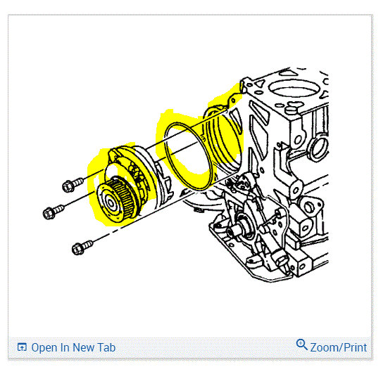

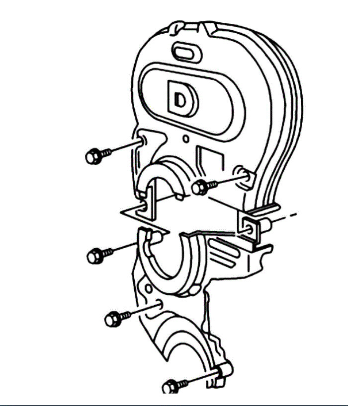

Check at the thermostat housing. Also, I'm wondering if it is coming from the water pump. The pump has a weep hole that coolant can leak from if the seal or bearing fails. This vehicle makes it somewhat difficult to replace if it is bad. The timing belt needs to be removed.
I attached a pic below showing the pump (pic 1). It will be behind the timing belt cover so check if any coolant is around the cover itself.
The cover is plastic and two-piece (pic 2). If you remove the bolts holding it in place, you may be able to tilt it enough to see if anything is wet on the timing belt or in that area. The serpentine belt will prevent it from moving too far, but that can be removed if needed.

Hello Joe,
The fluid that is leaking is the same color as the coolant in the reservoir. It's probably leaking from the weep hole as you stated. I will take it back to the mechanic on Monday, leave it overnight, with something to catch the coolant so he can check it.
I've had other seals on previous vehicles that leaked when the car sat overnight, so maybe this is the issue.

RPJ
  • 109 POSTS
Hello Joe,
Turns out it was the thermostat housing which is a one-piece unit. It is made of aluminum and had become corroded over time. It was replaced about 6 years ago but failed again. So far, there are no leaks, and everything is good.
