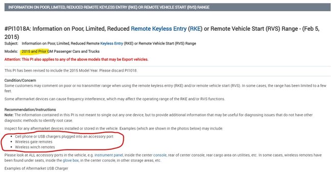

It takes at least 20 seconds holding the button on the key-fob to lock or unlock. The door buttons work just fine and function immediately. The key-fob is just extremely slow. I bought new batteries for both the fobs I own, and it is still extremely slow. Does anyone have any advice to try and diagnose the issue?
Mar 13, 2022 at 2:17 PM
WENDY W
  • 86 POSTS

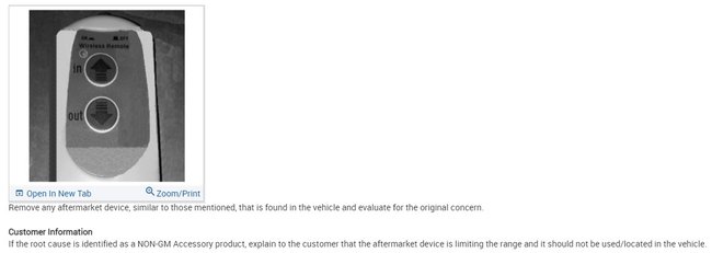

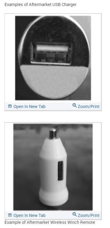

It sounds like there is possibly an aftermarket accessory interfering with the remote keyless entry system. I found that there was a TSB regarding this, which I've attached below. It advises checking for any aftermarket devices that may be causing interference, like cell phone chargers.
