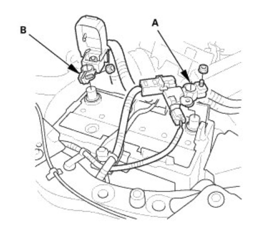

Here is a diagram to show the battery terminal service and you can see kind of where the cables go. Follow the cables to see where they lead to. Can you please shoot a quick video with your phone so we can see what's going on? that would be great. You can upload it here with your response. Check out the diagrams (below). Please let us know what happens.

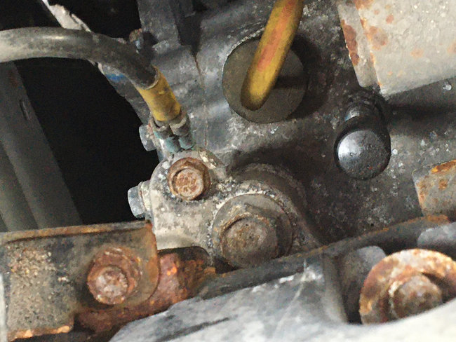

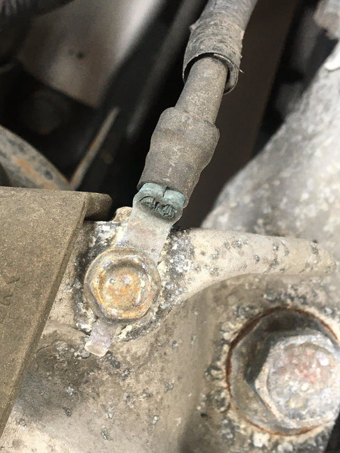

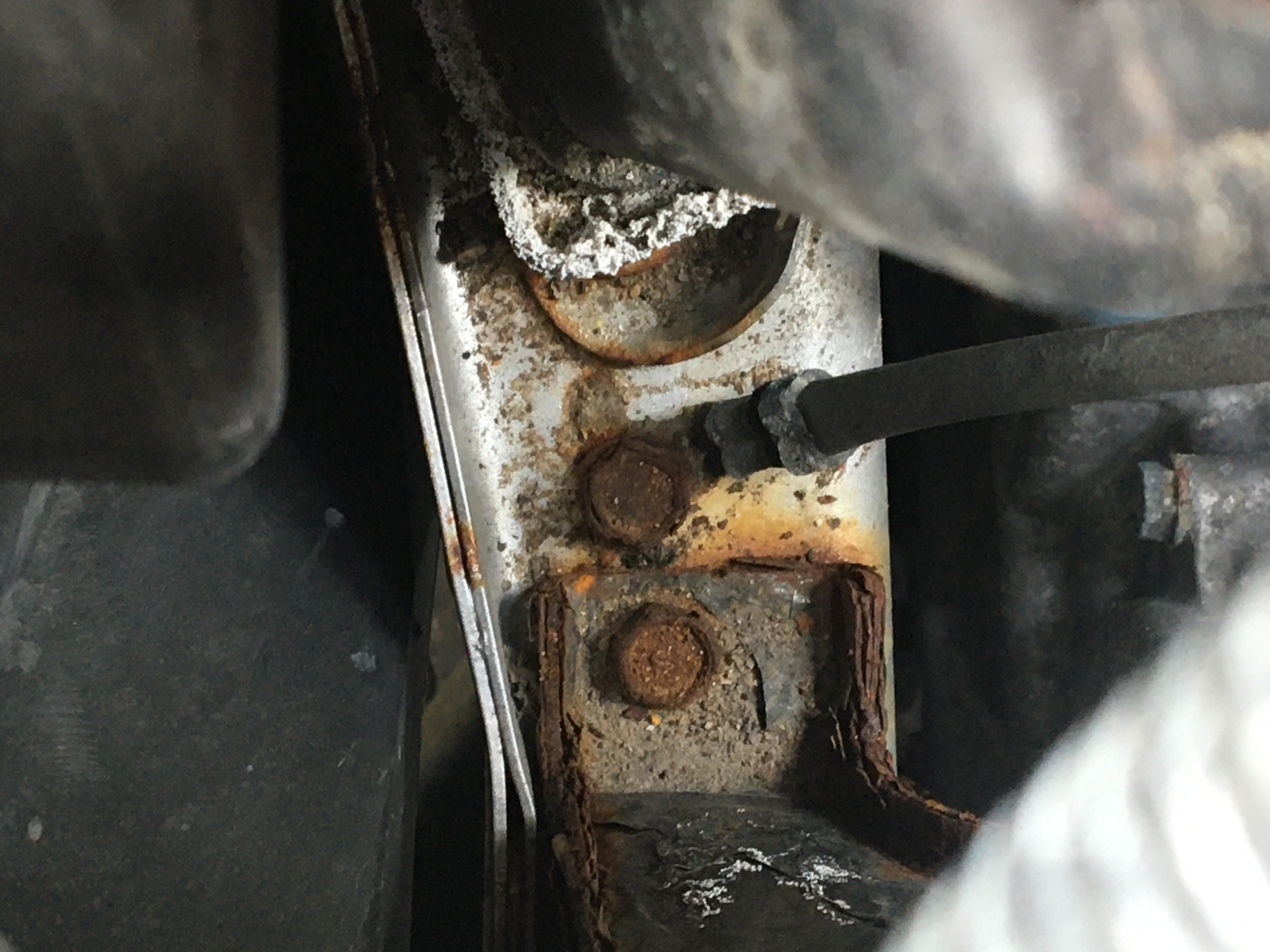

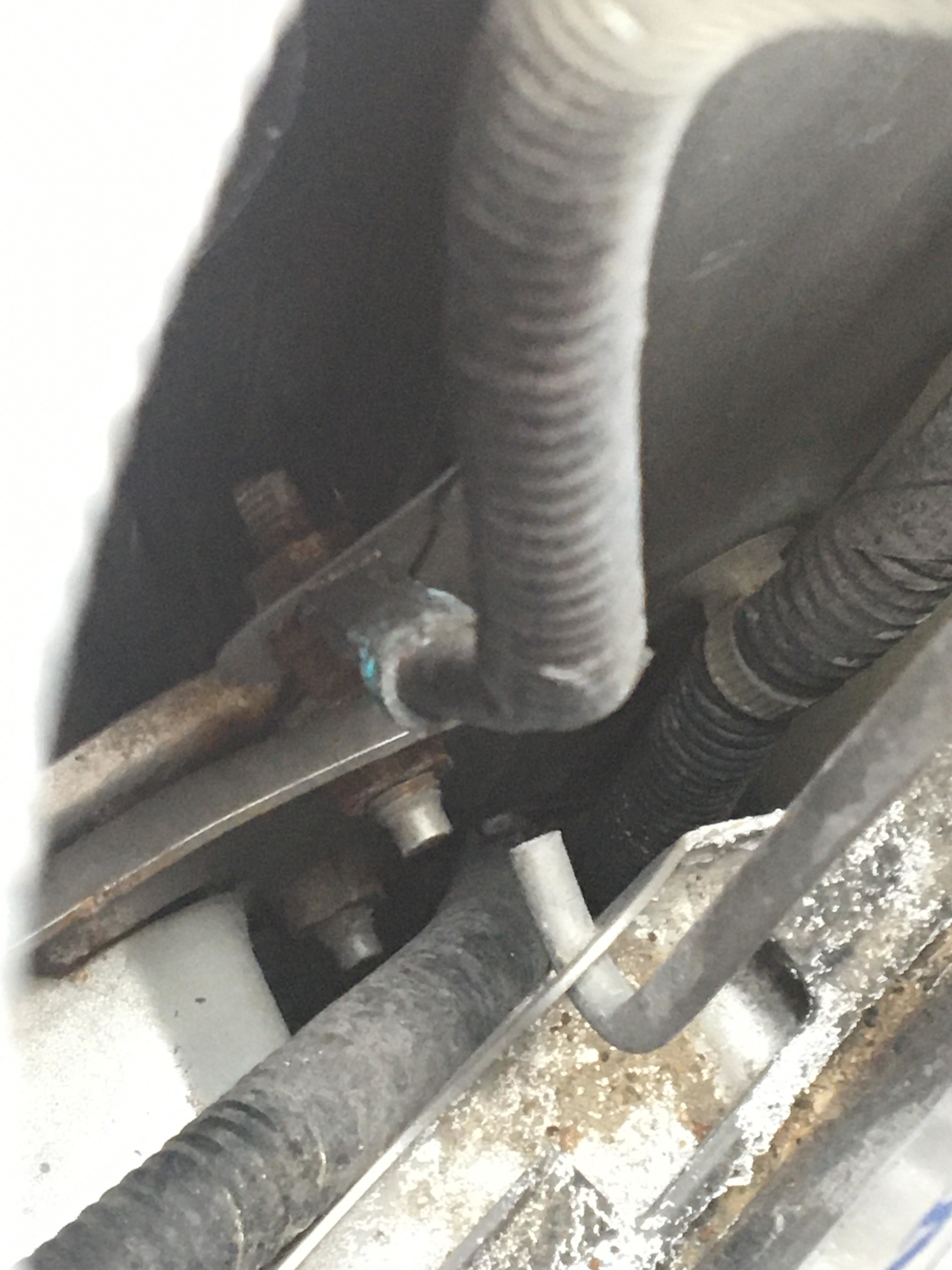

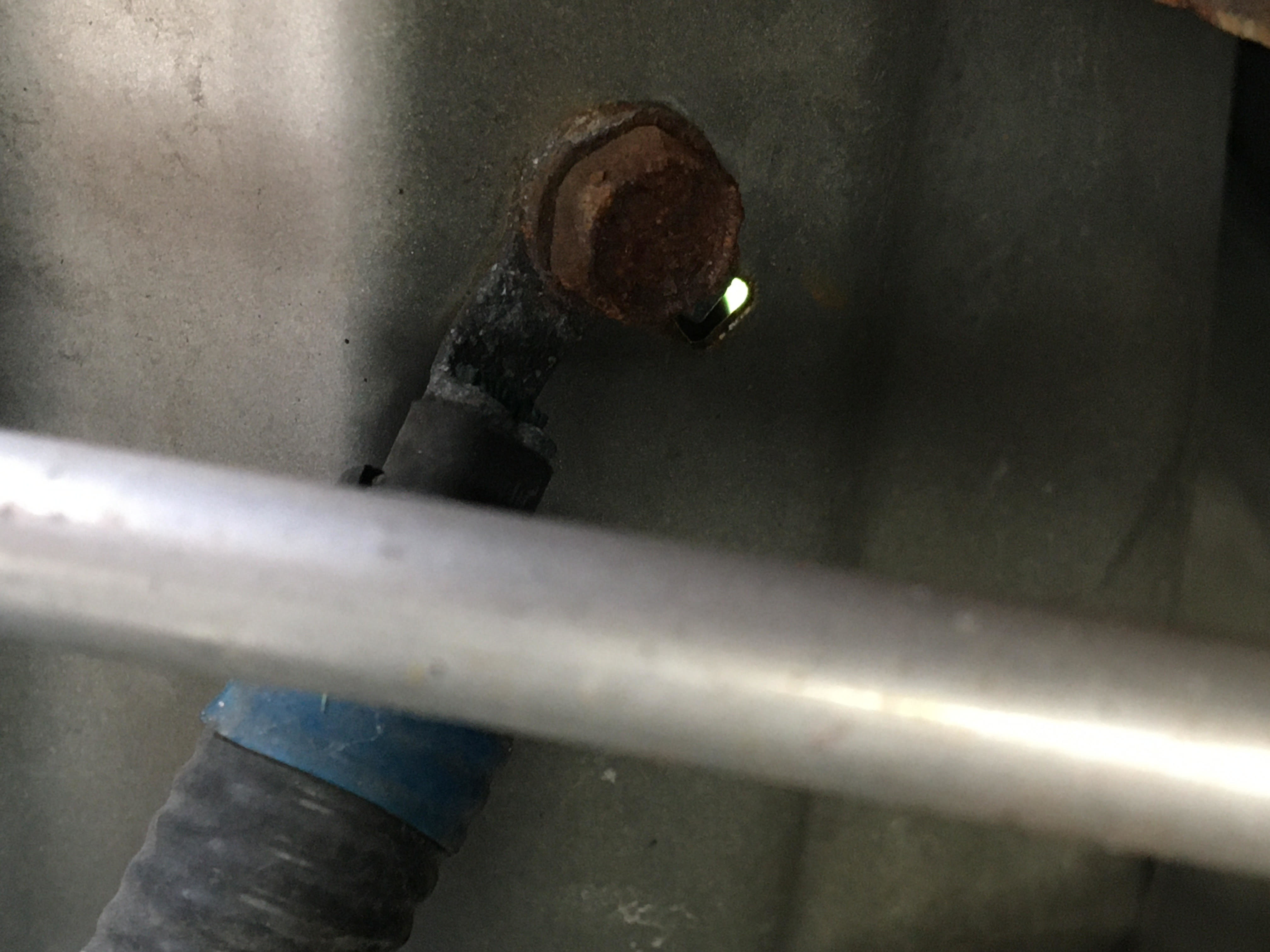

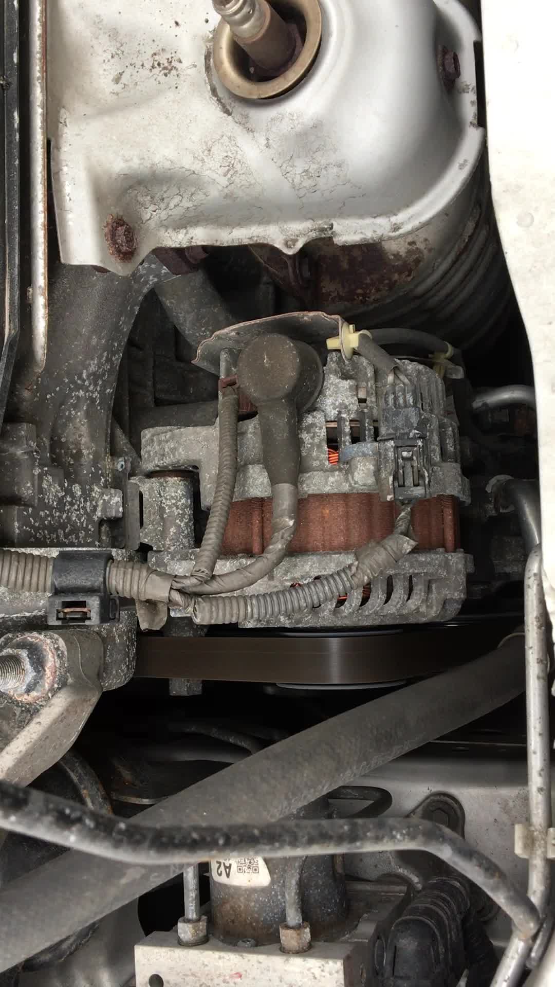

Here's photos of what I believe to be various grounds inside the engine bay. I haven't had a chance to test them with a multi-meter yet (cords are too short) but I was able to test the battery and it's at 12.05v when it's off and 14.05v when it's running. Since it's just me testing I wasn't able to see if it dips below 10.
I'll try to test the grounds in the coming days, but I have two questions about doing so: what resistance level should I be looking at? Meaning if I have my multi-meter set on ohm; should I be looking for always 0 or is there a range? and 2) to clean the grounds do I need to disconnect the battery (probably a dumb question, but I don't know).
I'm trying to eliminate everything else because to me it seems odd that the starter would only have trouble on the first try each day but all other attempts there are no issues.
Jan 4, 2021 at 3:07 AM
  • 55,433 POSTS
I would clean each of those grounds and then replace the starter if that does not help. Starters go bad in many different ways. Let me know what happens.

Posting an update since the issue has been resolved.
I had the starter replaced and for the last two weeks I've had no issues starting the car, even when it hasn't been started in several days. I ended up taking the car to a local repair shop since I don't have jack stands or the space to work. They said everything tested fine and that the starter didn't need to be replaced. Knowing it was most likely the culprit I had the starter replaced anyways and am glad I did.

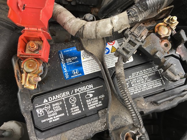

GOLDENDAVE
  • 51 POSTS

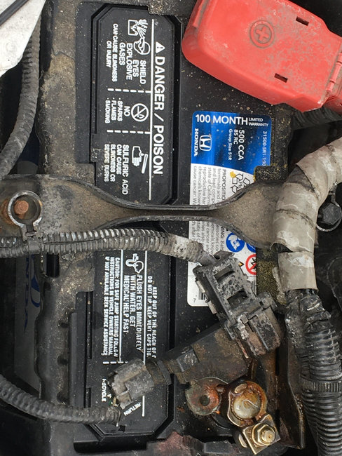

Joe,

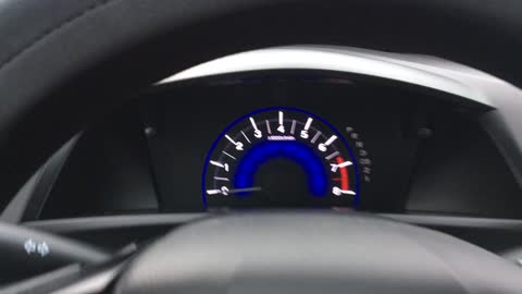

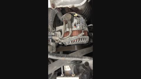

The terminals are clean/in good condition and I haven't heard the clicking sound usually associated with a dead starter. I've uploaded a photo of the terminals as well as two videos; one showing under the hood as the engine is running and the other showing a failed start from the driver's seat.
In the first video you'll be able to hear the engine crank three before stopping at the 9 second mark. Here's a timeline of that first video:
- 4-9 seconds - key is turned to the accessory position to allow the fuel pump to run.
- 9-10 seconds - engine cranks three times then stops.
- At 15 seconds the engine turns over on the third crank.
I should add it was 16 degrees outside when the engine failed to start this morning.

GOLDENDAVE
  • 51 POSTS
Failed start video.
Jan 25, 2021 at 2:59 AM (Merged)
GOLDENDAVE
  • 51 POSTS
Running engine.

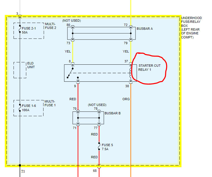

  • 110,244 POSTS

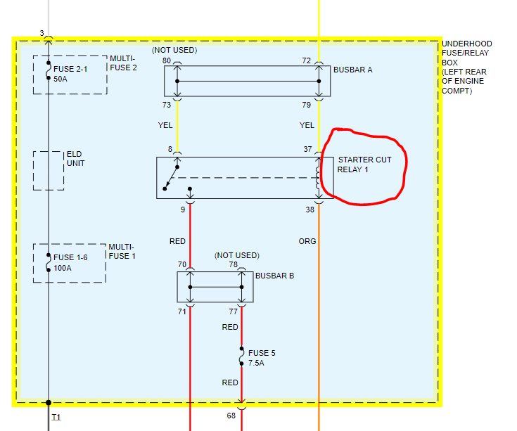

I have to be honest, even when it started, it sounded like it turned slowly. I want you to check something for me. Drive the vehicle to a parts store and ask them to load test the battery. Most do it free of charge. If it passes, there is a relay under the hood called the starter cut relay. I'm questioning if it is bad. I attached a pic of the component. The reasoning is it stopped itself from cranking and other times you get nothing.
Here is a test for checking relays:
Here are a few other links you may find helpful:
_____________________
If the relay is good, the battery is good as well as all connections, my next step would be the starter. Here is a link that explains in general how one is replaced:
Here are the directions specific to your vehicle for both replacement and testing of the starter. The attached pics correlate with the directions.

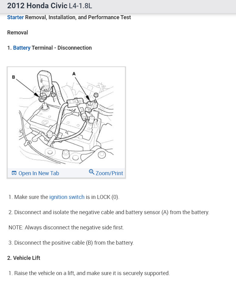

Removal
1. Battery Terminal - Disconnection
pic 2
1. Make sure the ignition switch is in LOCK (0).
2. Disconnect and isolate the negative cable and battery sensor (A) from the battery.
NOTE: Always disconnect the negative side first.
3. Disconnect the positive cable (B) from the battery.

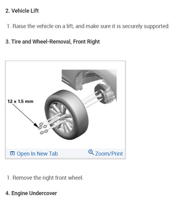

2. Vehicle Lift
1. Raise the vehicle on a lift, and make sure it is securely supported.
3. Tire and Wheel-Removal, Front Right
pic 3
1. Remove the right front wheel.

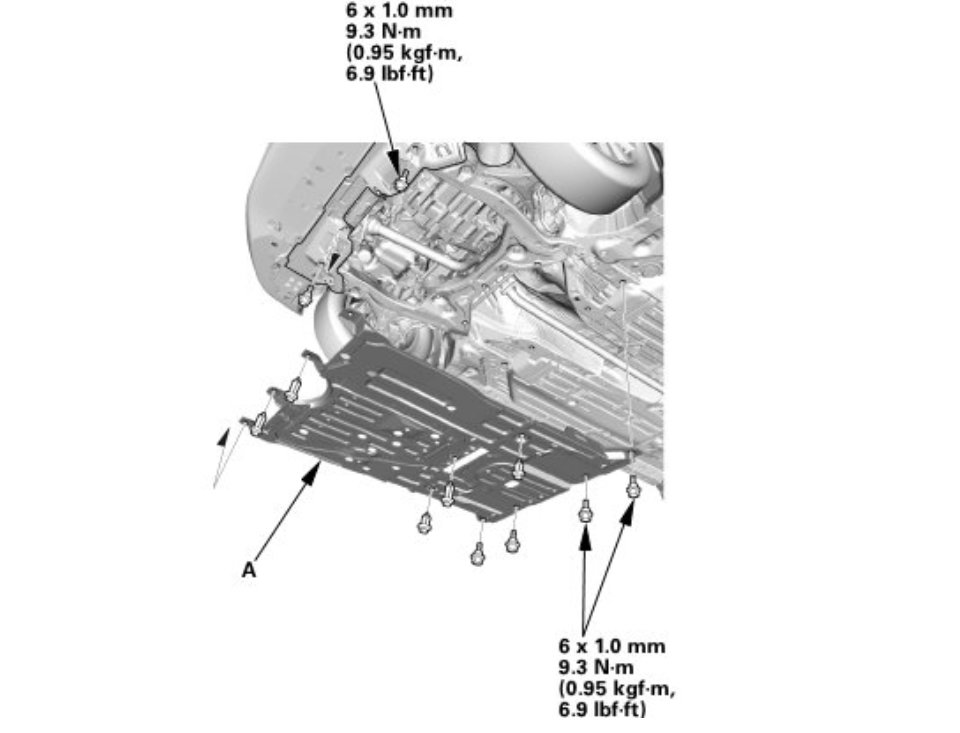

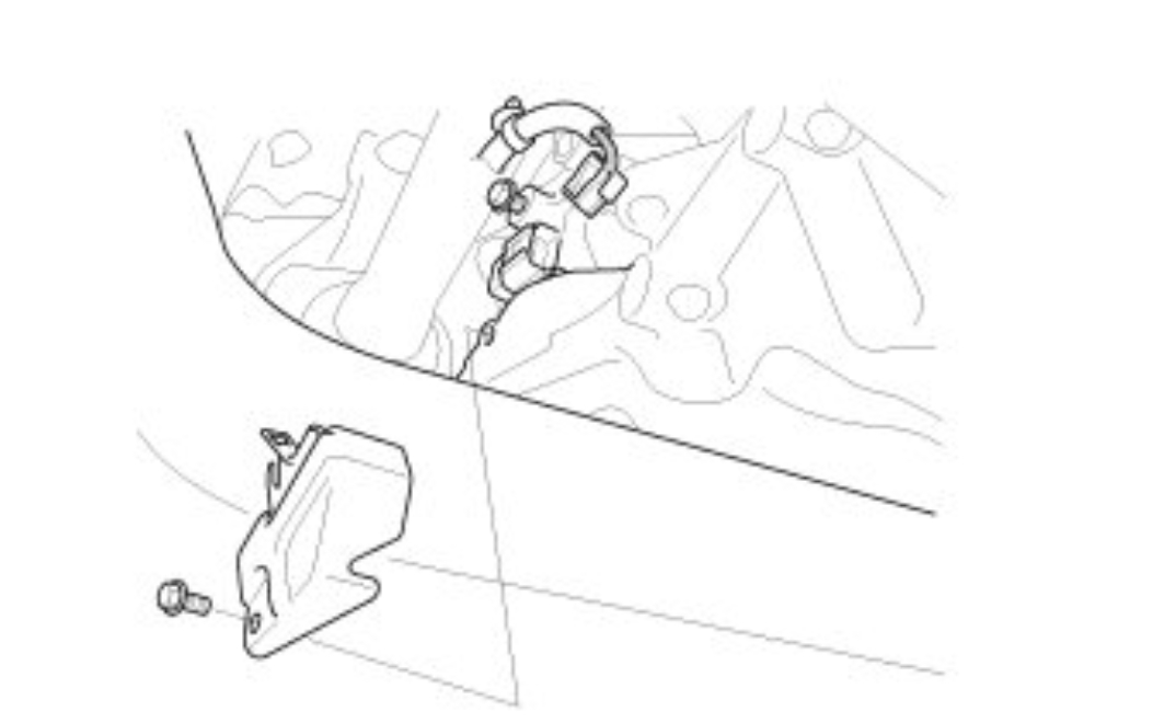

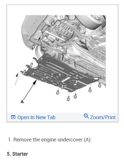

4. Engine Undercover
pic 4
1. Remove the engine undercover (A).

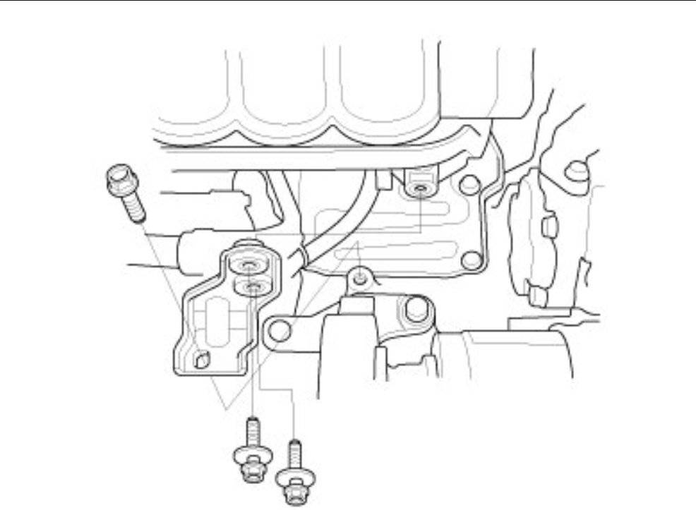

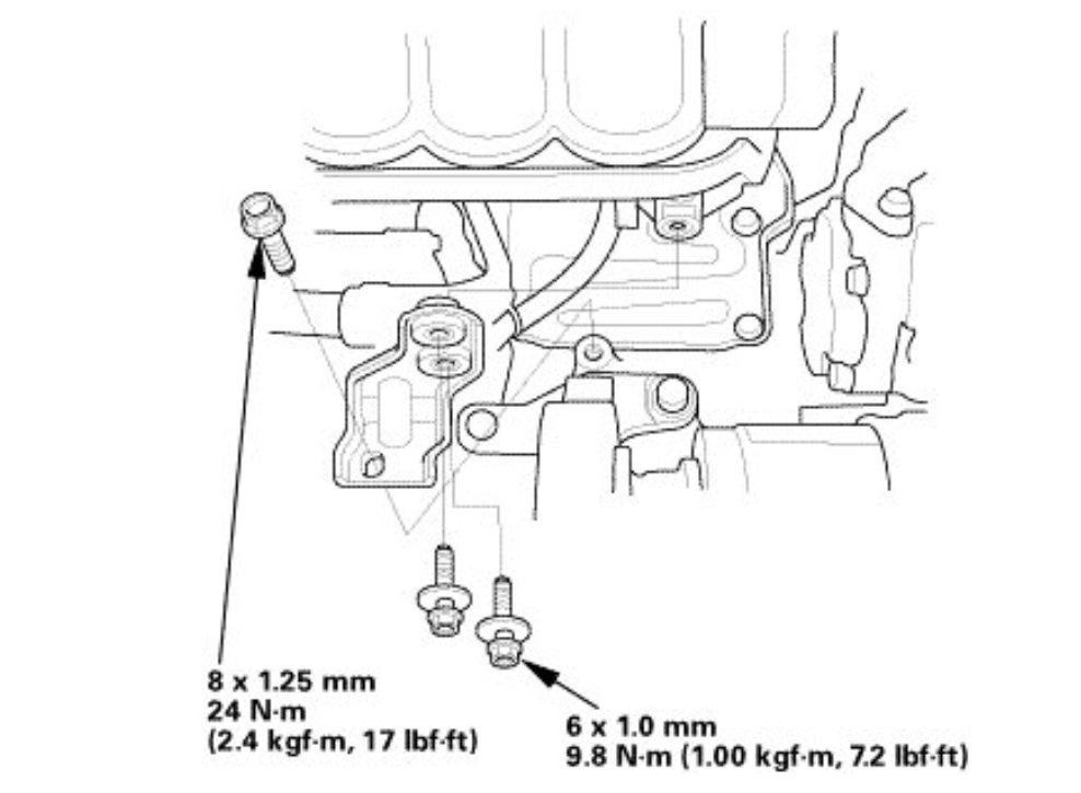

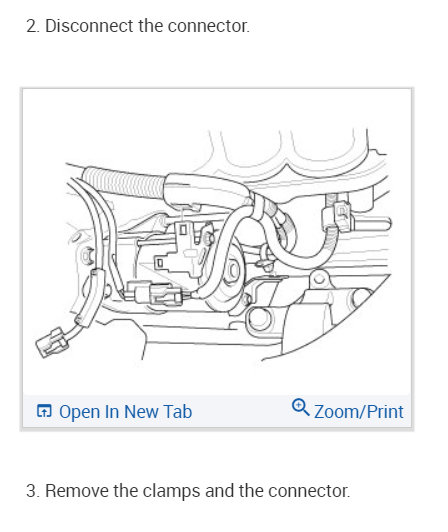

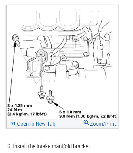

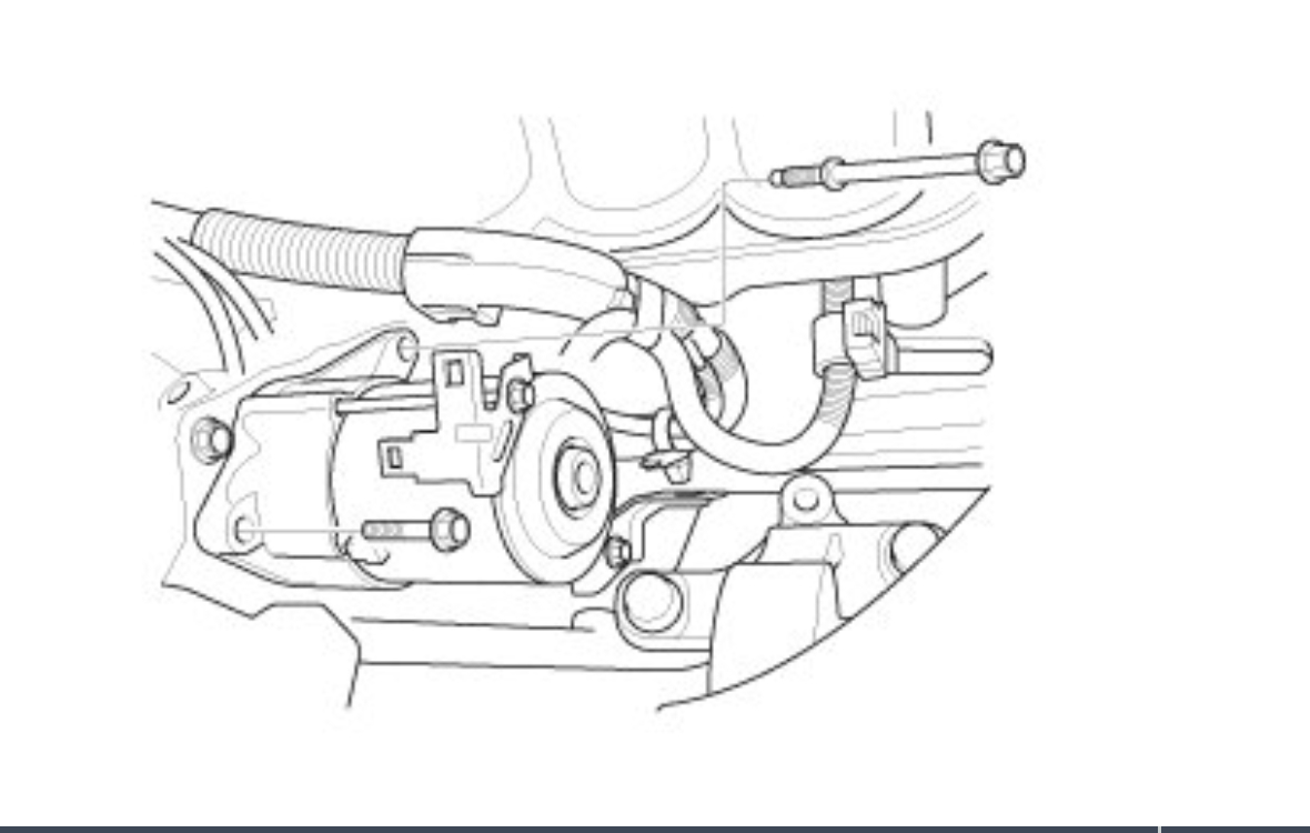

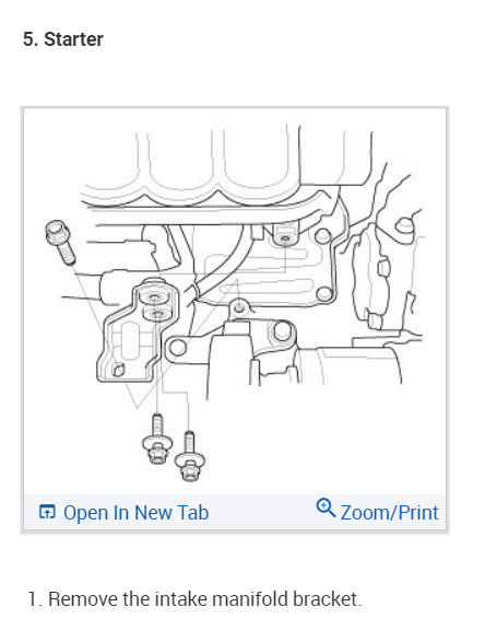

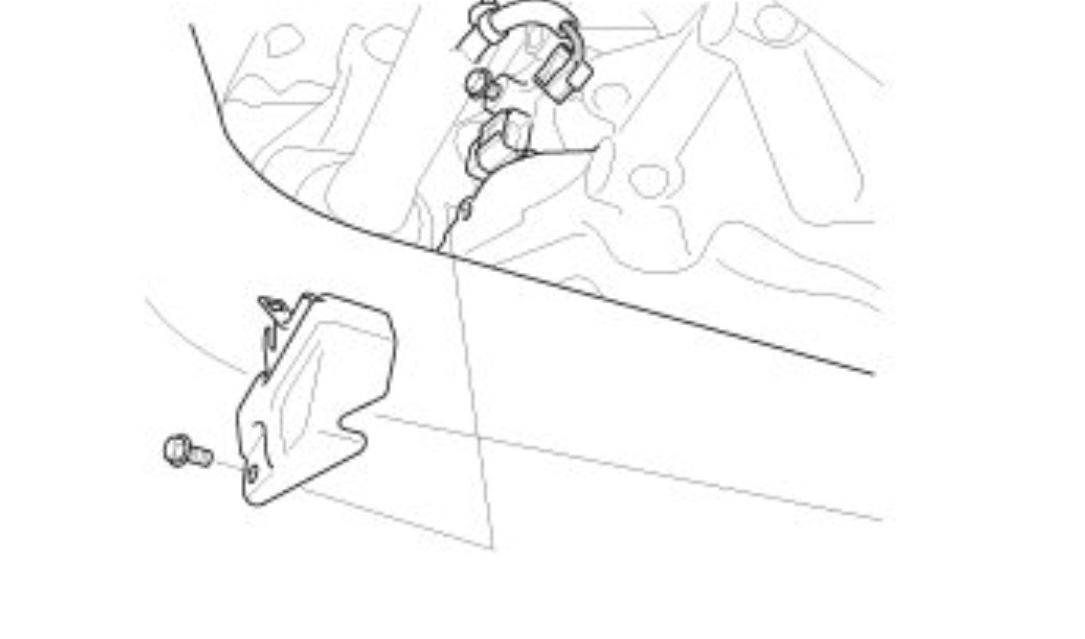

5. Starter
pic 5

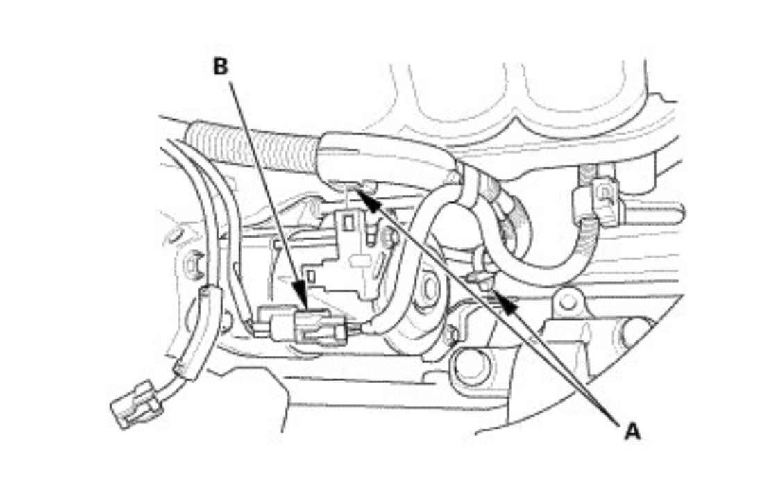

1. Remove the intake manifold bracket.

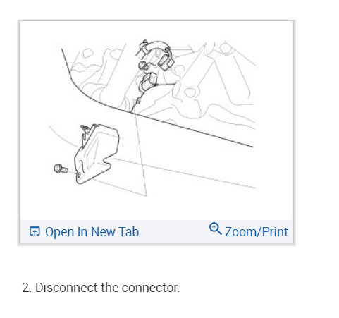

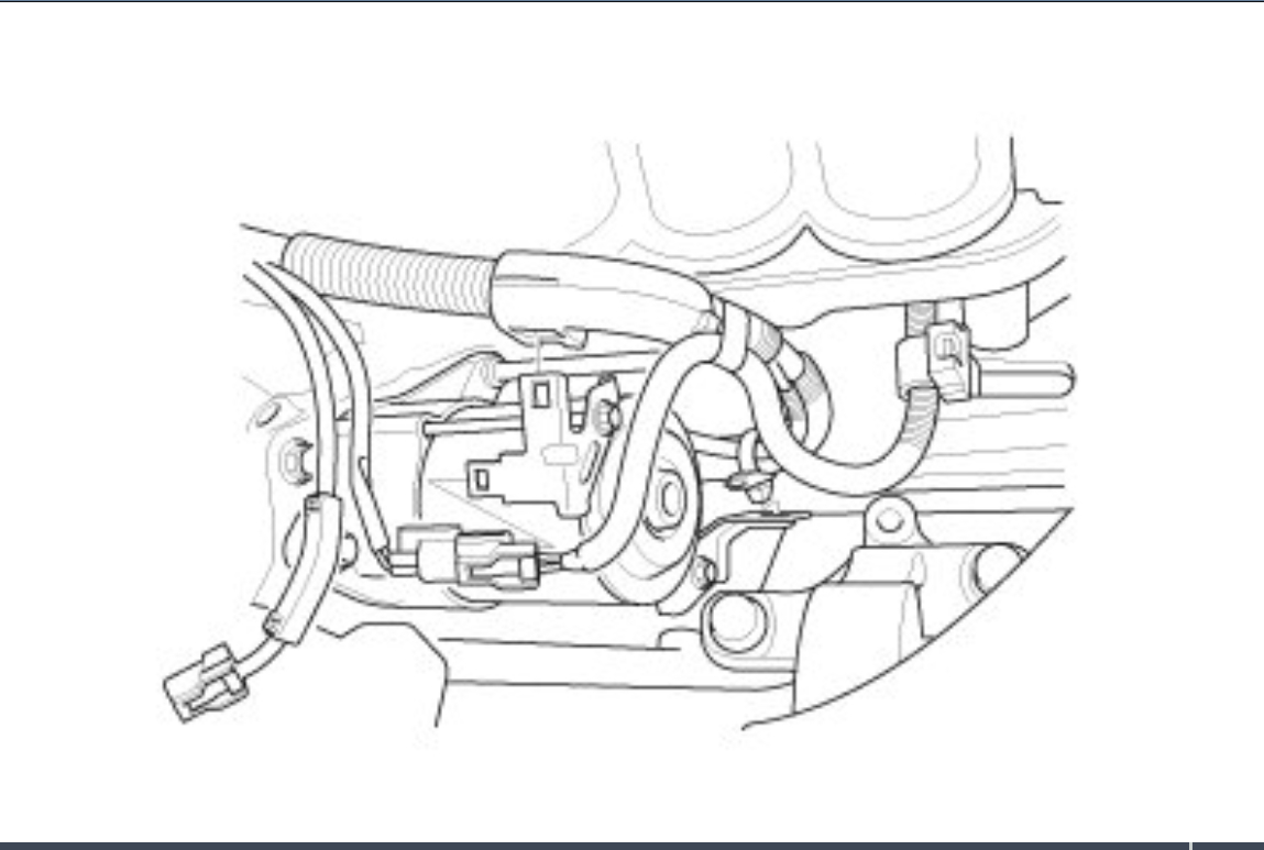

pic 6

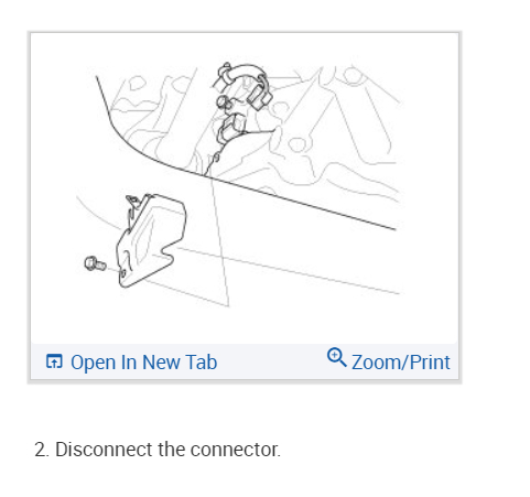

2. Disconnect the connector.
pic 7
3. Remove the clamps and the connector.

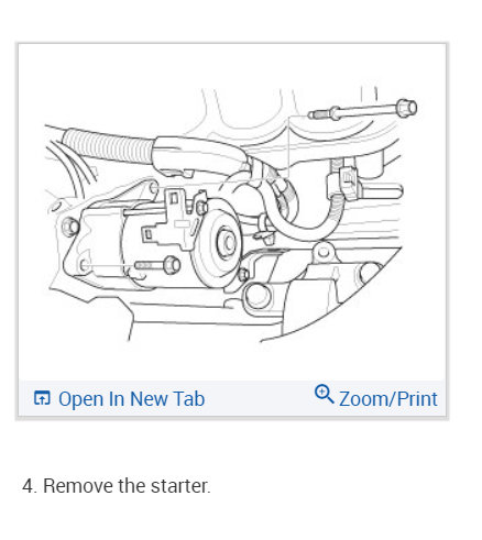

pic 8

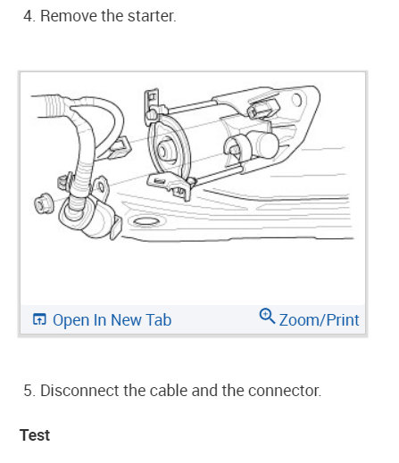

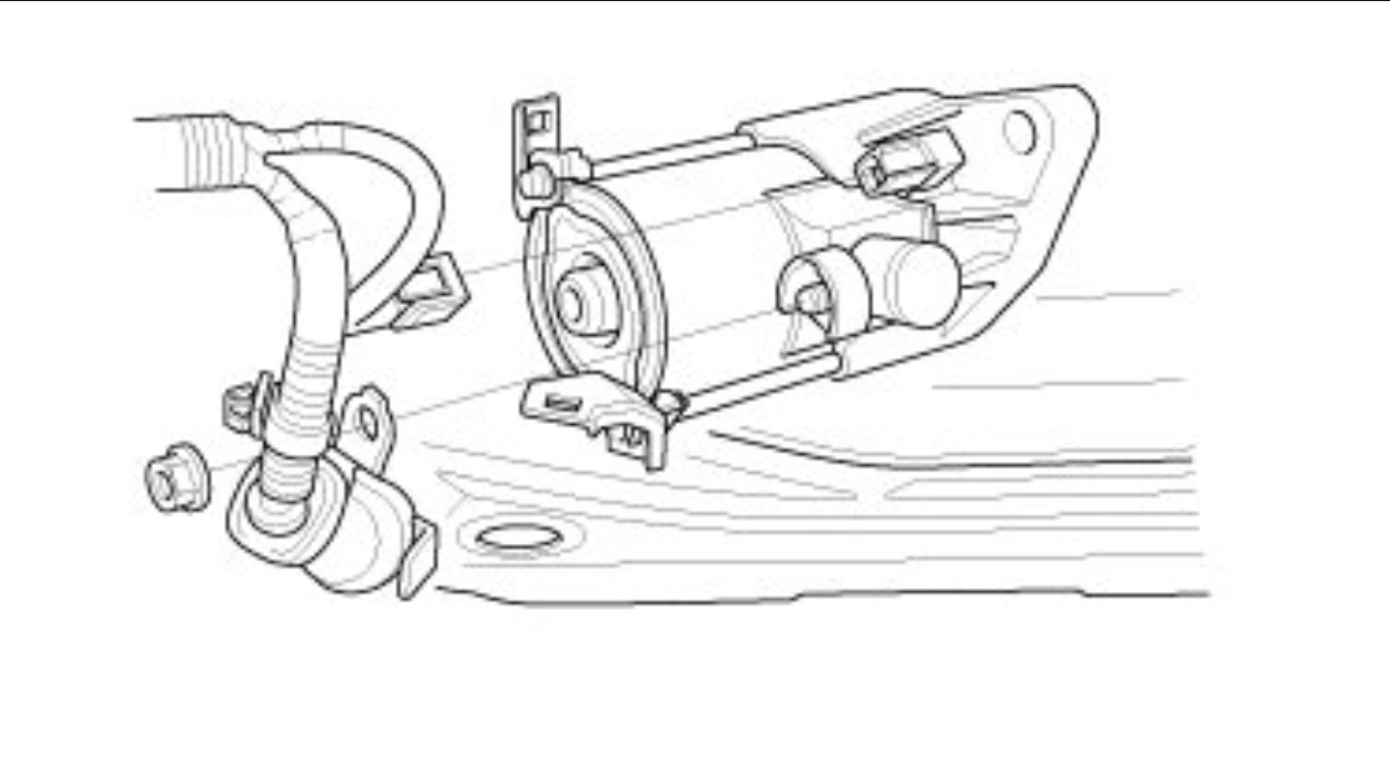

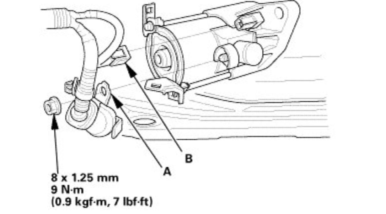

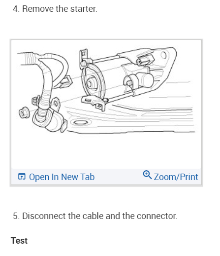

4. Remove the starter.
pic 9
5. Disconnect the cable and the connector.

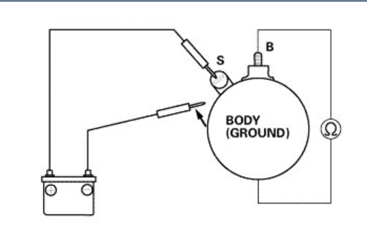

Test
1. Starter Performance - Test
pic 10

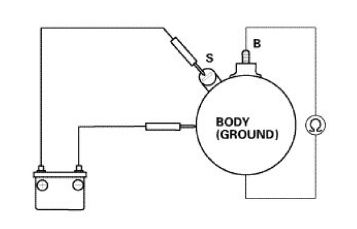

1. Clamp the starter firmly in a vise.
2. Make the connections for this test using the thickest (gauge) wire possible (preferably the same gauge as used on the vehicle).
NOTE: To avoid damaging the starter, never leave the battery connected for more than 5 seconds.
3. Connect the battery as shown, and check for continuity between the B terminal and the starter body. If there is continuity, it is working properly.
pic 11
4. Disconnect the battery from the starter body, and check for continuity between the B terminal and the starter body. If there is no continuity, it is working properly.
pic 12

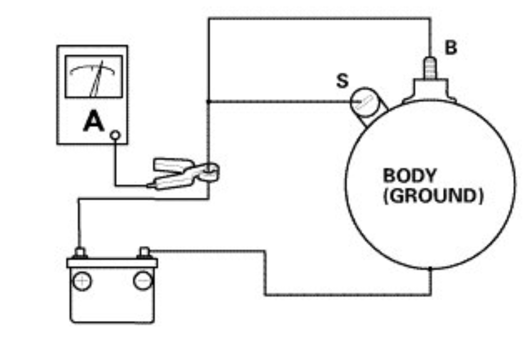

5. Connect the starter to the battery as shown, and confirm that the motor runs.
6. If the electric current meets the specification when the battery voltage is at 11.5 V, the starter is working properly.

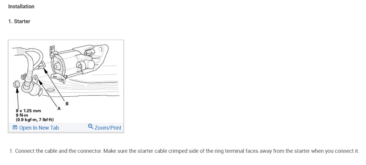

Installation

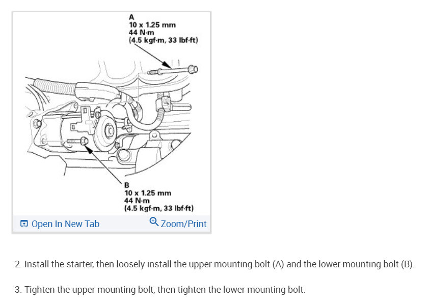

1. Starter

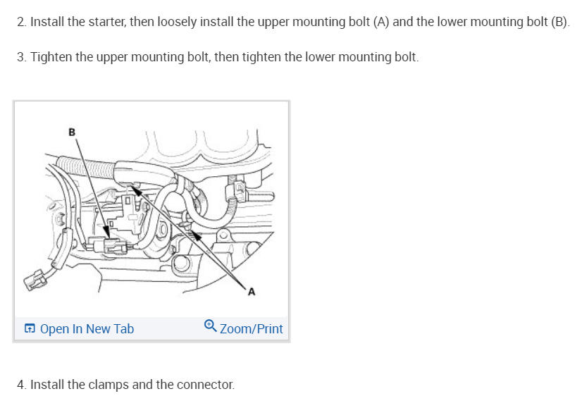

pic 14
1. Connect the cable and the connector. Make sure the starter cable crimped side of the ring terminal faces away from the starter when you connect it.
pic 15

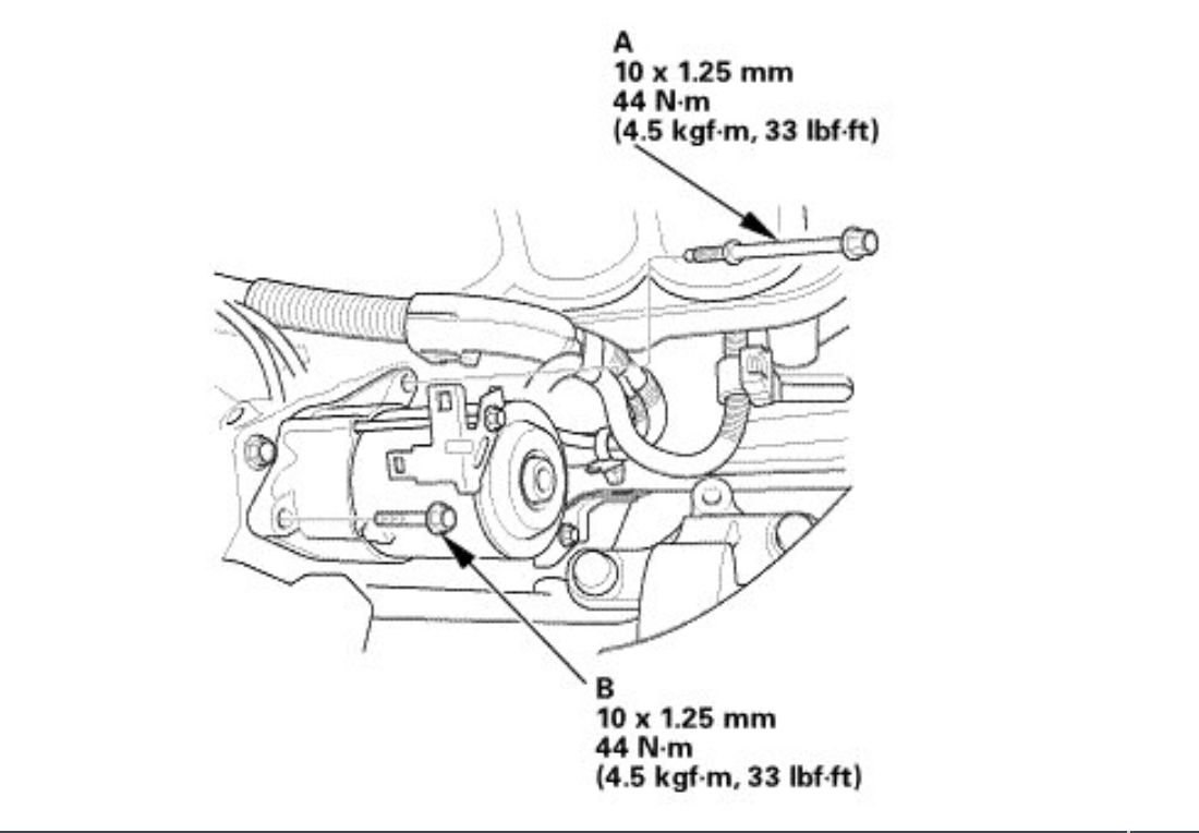

2. Install the starter, then loosely install the upper mounting bolt (A) and the lower mounting bolt (B).
3. Tighten the upper mounting bolt, then tighten the lower mounting bolt.

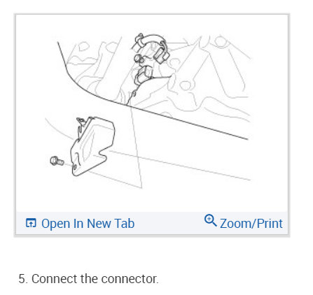

pic 17
5. Connect the connector.
pic 18
6. Install the intake manifold bracket.

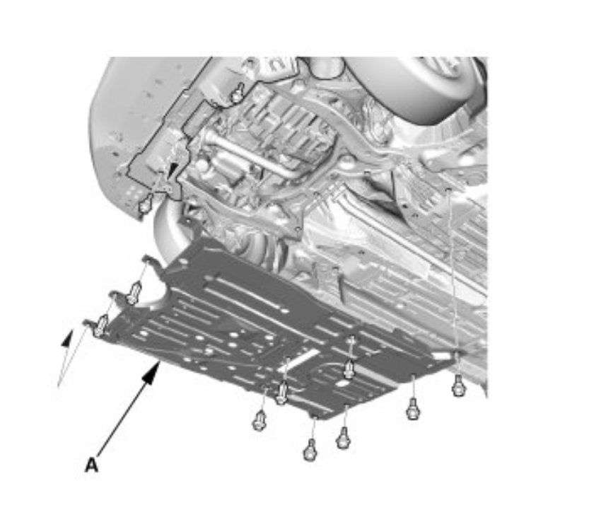

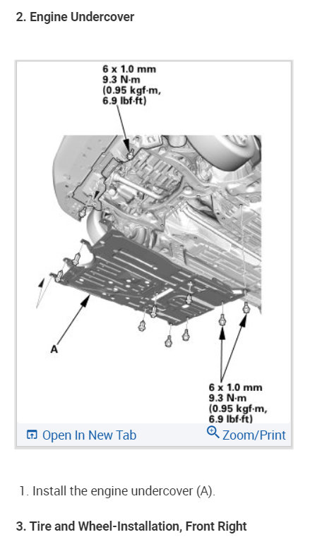

2. Engine Undercover
pic 19
1. Install the engine undercover (A).

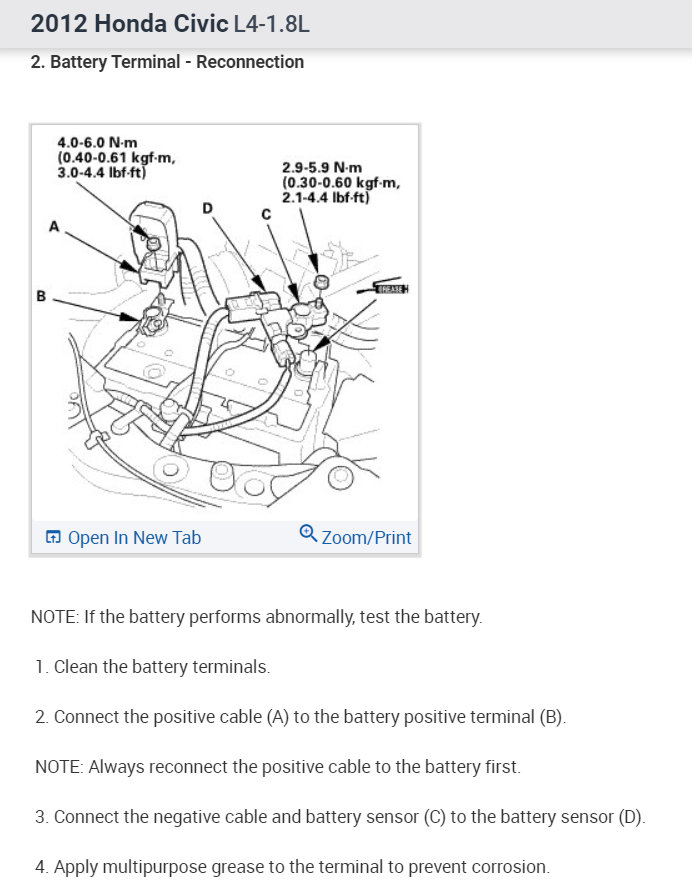

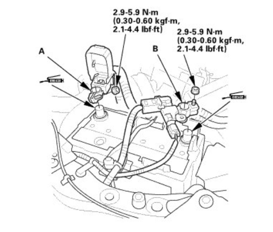

4. Battery Terminal - Reconnection
pic 21
NOTE: If the battery performs abnormally, test the battery.
1. Clean the battery terminals.
2. Connect the positive cable (A) to the battery.
NOTE: Always connect the positive side first.
3. Connect the negative cable and battery sensor (B) to the battery.
4. Apply multipurpose grease to the terminals to prevent corrosion.
