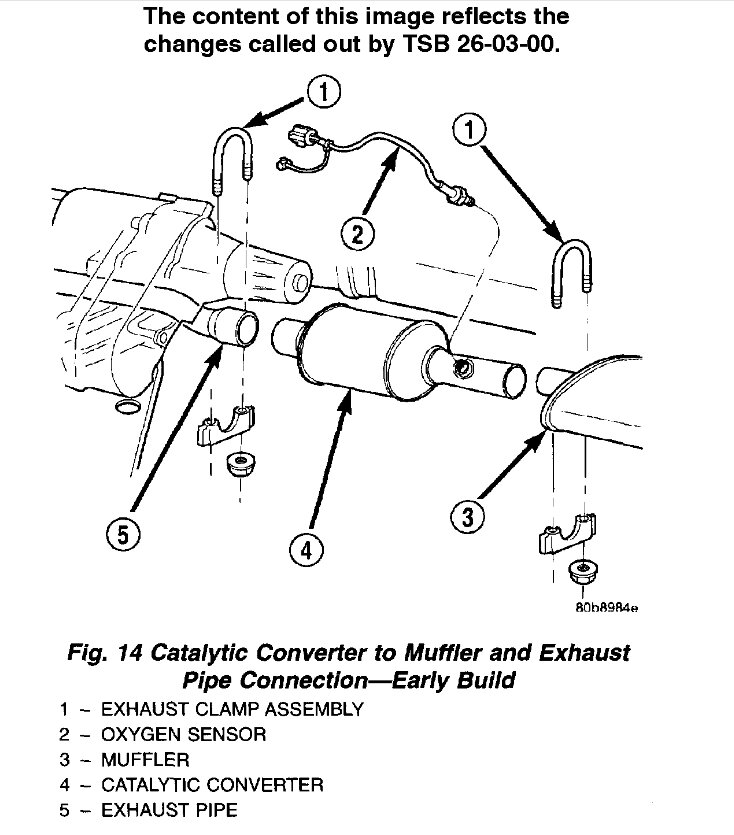

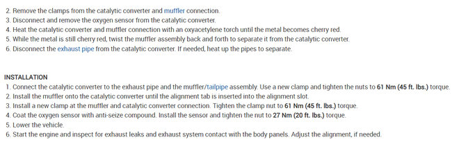

Can I get the code numbers please? To me it sounds like the catalytic converter is partially clogged which will cause a low vacuum which can tell the computer you are going up a hill when you are not, which will make the transmission shift way late.
This guide can help you check:
