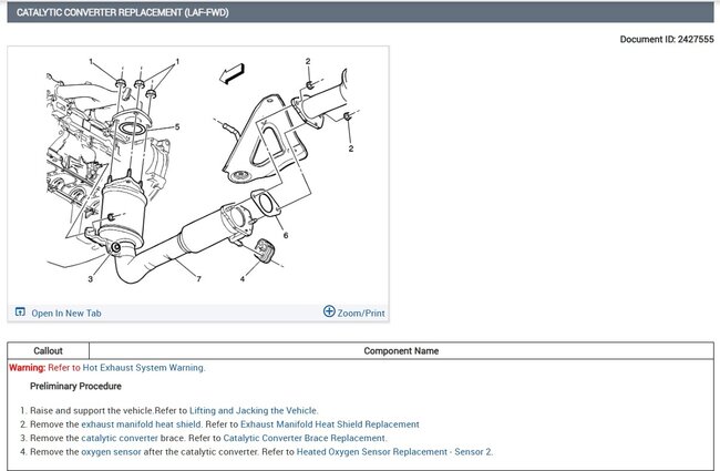

About a month ago my equinox started not wanting to accelerate. It has had a CEL with code P0420 so I Replace the cat, pre and post O2 sensors, put new plugs in it, new air filter, removed the intake to clean the PCV hole out to make sure oil didn't ruin the new cat and I am still having the same problems with no CEL now. I have used a scanner to check live data and everything seems to be normal fuel pressure stays between 45-60psi, fuel rail pressure averages around 500psi at idle going up to around 1800 at wide open throttle, MAF show around .75lbs a min going up to around 10lbs at WOT, MAP is around 28inHG with the key off which matches ambient air then once started goes to around 10in if I remember right, O2 sensors are showing to be working as well that I replaced. Everything seems in range from what I can come up with the engine just keeps acting like its suffocating and can't pull itself. I am at a complete loss on what to try next with it not throwing a CEL now. Any help would be greatly appreciated. Thank you!

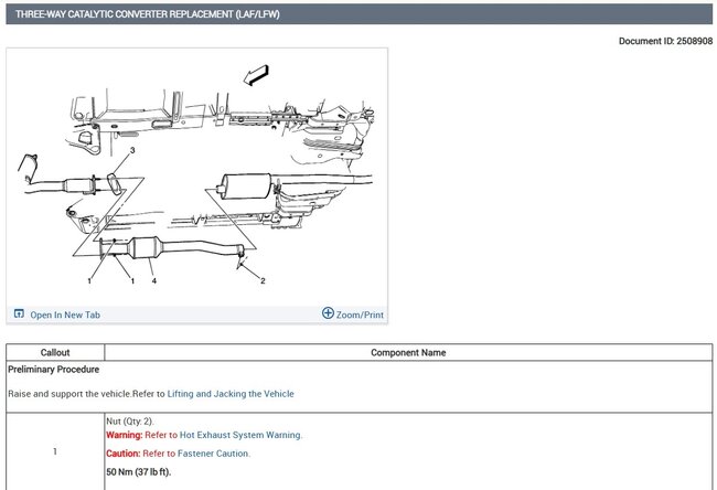

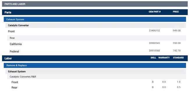

Hello, so this setup is kind of deceiving, there is a 2nd 3-way Catalytic converter about mid-way down the vehicle. It's a real bummer that they don't have another oxygen sensor behind it to monitor its performance. I will post the part numbers as well because they are different for California Emissions and Federal Emissions for the rear cat. The 2nd cat is the mid pipe just before the muffler. You correct on your diagnosis though.

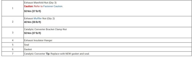

Here's the part numbers and I included the front cat info as well, the 2nd cat (diagrams 4,5) shows its location, and if the front cat came out broken up due to it melting down, make sure to check for junks of the old cat in the rest of the exhaust. I'm really sorry they don't make this more apparent; I know how frustrating it is after all that work. Hopefully its possibly just pieces of the old cat restricting the exhaust.
