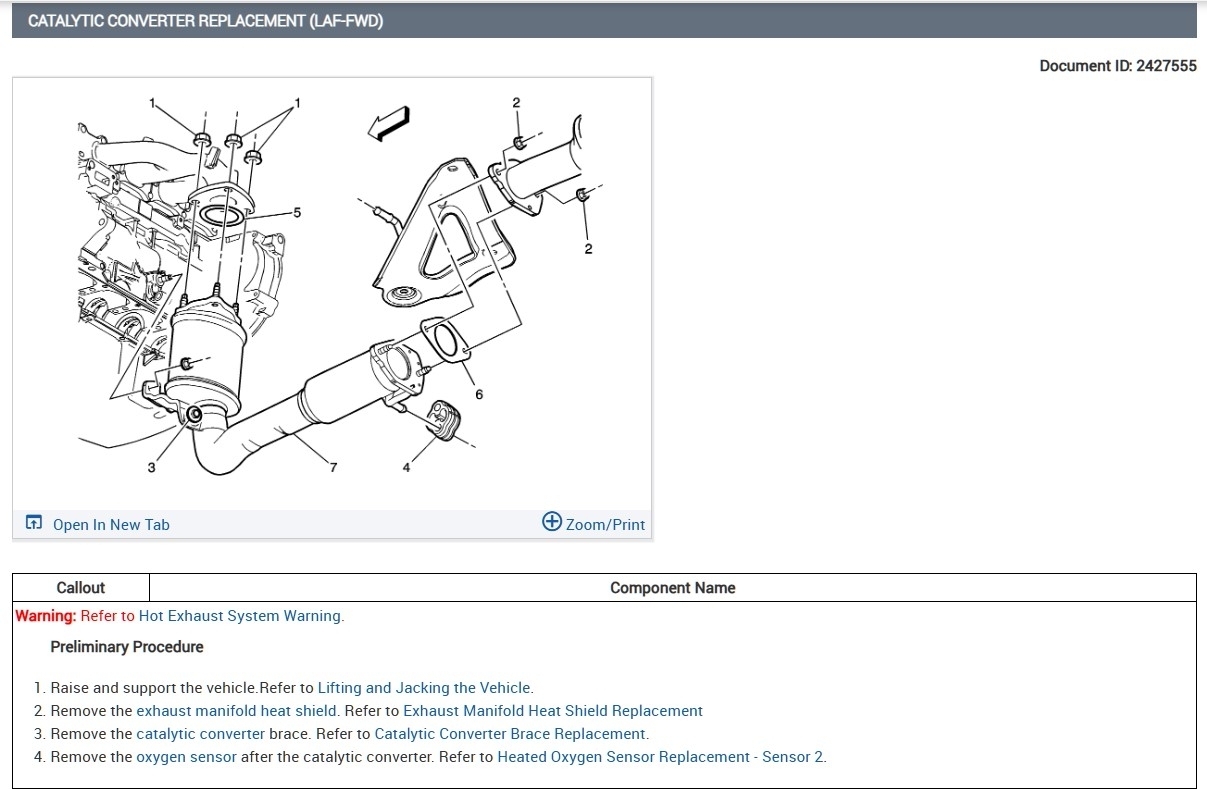

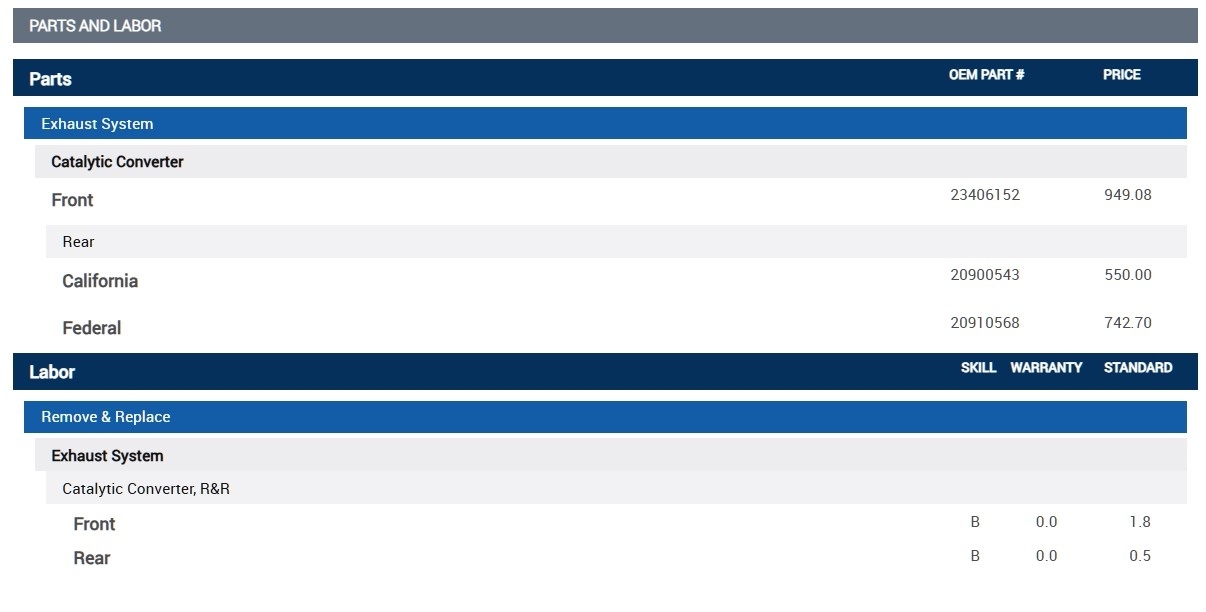

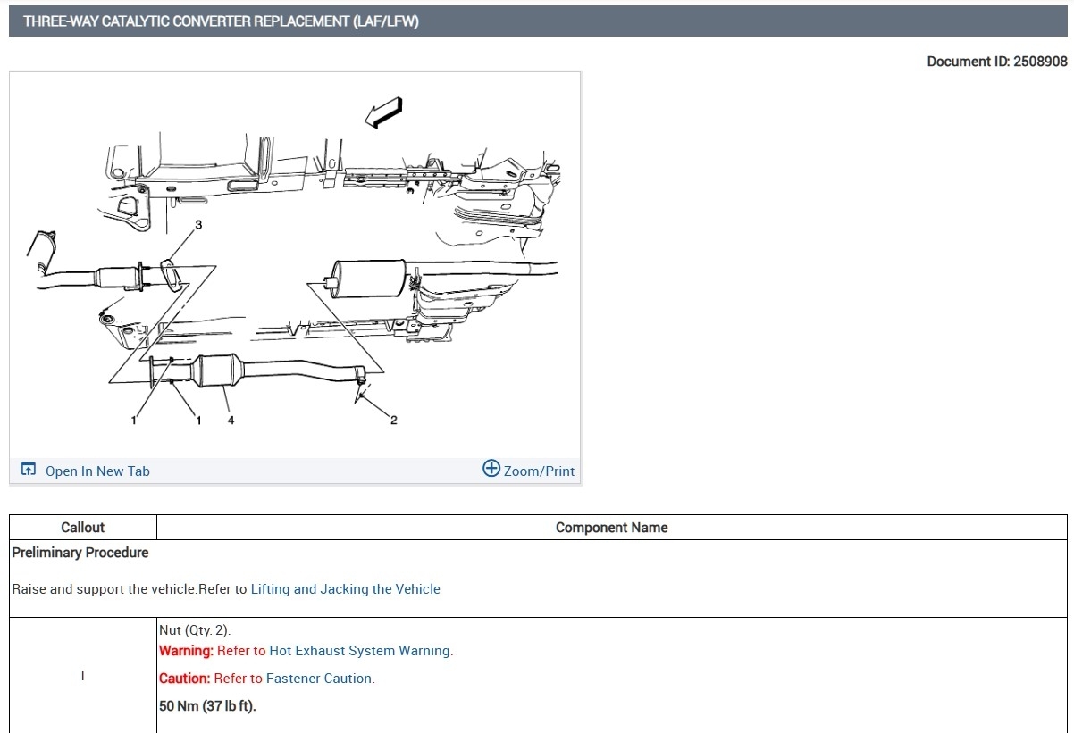

Hello, so this setup is kind of deceiving, there is a 2nd 3-way Catalytic converter about mid-way down the vehicle. It's a real bummer that they don't have another oxygen sensor behind it to monitor its performance. I will post the part numbers as well because they are different for California Emissions and Federal Emissions for the rear cat. The 2nd cat is the mid pipe just before the muffler. You correct on your diagnosis though.

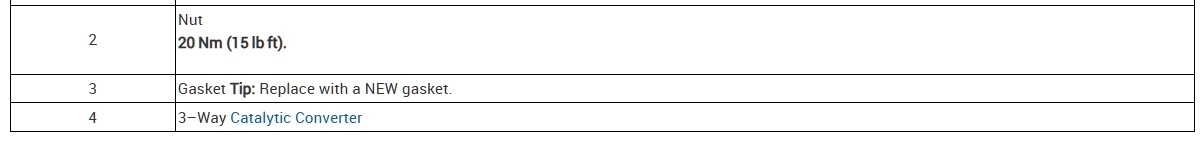

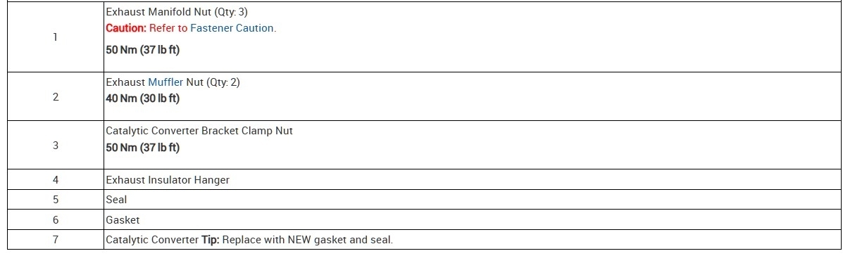

Here's the part numbers and I included the front cat info as well, the 2nd cat (diagrams 4,5) shows its location, and if the front cat came out broken up due to it melting down, make sure to check for junks of the old cat in the rest of the exhaust. I'm really sorry they don't make this more apparent; I know how frustrating it is after all that work. Hopefully its possibly just pieces of the old cat restricting the exhaust.
