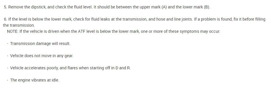

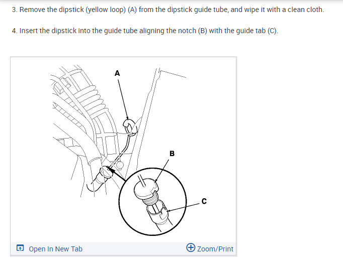

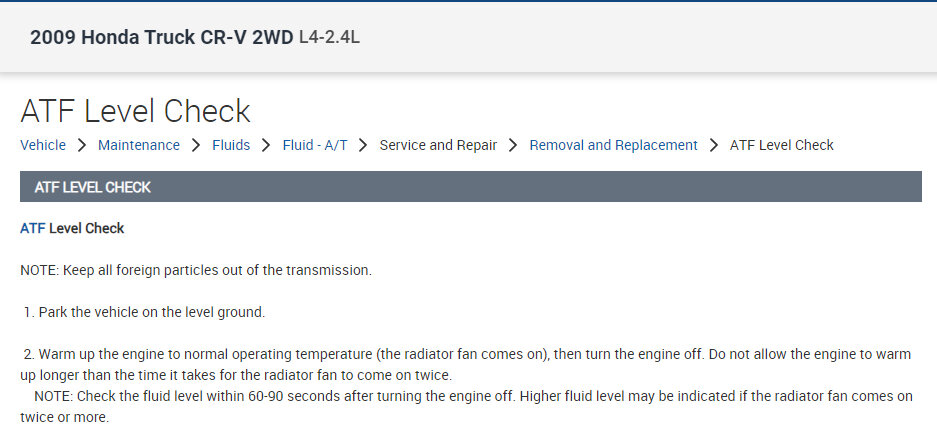

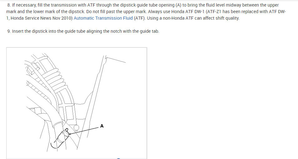

Based on your description, it sounds like the transmission is slipping. If the engine RPM's increase, but the vehicle doesn't accelerate in relationship of the engine speed, it is likely slipping.
Do me a favor. First, I attached the directions below specific to your vehicle for checking the transmission fluid. Do this first.
Next, since the check engine light is on, stop at a local parts store such as AutoZone and have them scan to computer for diagnostic trouble codes. Normally (don't know where you are located), this is a free service they offer.
Have them check it and print out the results or you and let me know what they find.

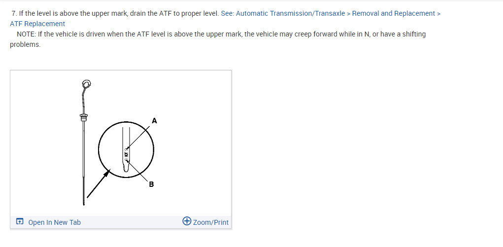

Thank you for the response. I did what you suggested, and tx oil was way above the upper limit. I wonder if the engine was too hot. The check engine code was P2422 - EVAP CVS stuck shut, so nothing to do with the tx.

Yep, that is one of the first things I mentioned. It sounds like it is slipping. However, my question is why would the fluid be over full? Do me a favor. First, when the engine is cold, check the engine coolant to see if it appears that anything could be mixing with it. Also, inspect the transmission fluid again. It should be a pinkish color. Let me know what it looks like.
