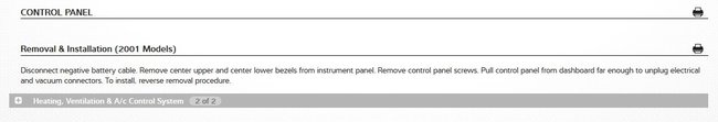

Ok, thank you. The recirculation button on mine was broken so a friend pulled the entire assembly from another jeep including the control board....so I'll purge the coolant and get rid of the sloshing, see if I get any heat, if not I'll swap out the control module.
Thank you so much. Any chance you have access to the install diagram of the module!
Feb 7, 2018 at 6:40 AM
HARRY P
  • 2,292 POSTS
It's pretty straightforward. Pull the plastic bezels off, undo *I think* 4 screws/bolts, and slide it out and unplug. Installation is the reverse. I'll double check though and see what I can find more specific information.

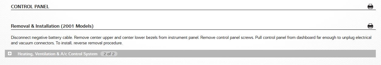

HARRY P
  • 2,292 POSTS
I looked it up on Prodemand and am attaching a screenshot. It says pretty much what I said. Not very specific and no pictures. You might try a youtube search though if you really want to. Sometimes you can find great information on there.
