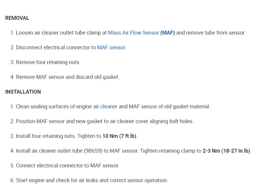

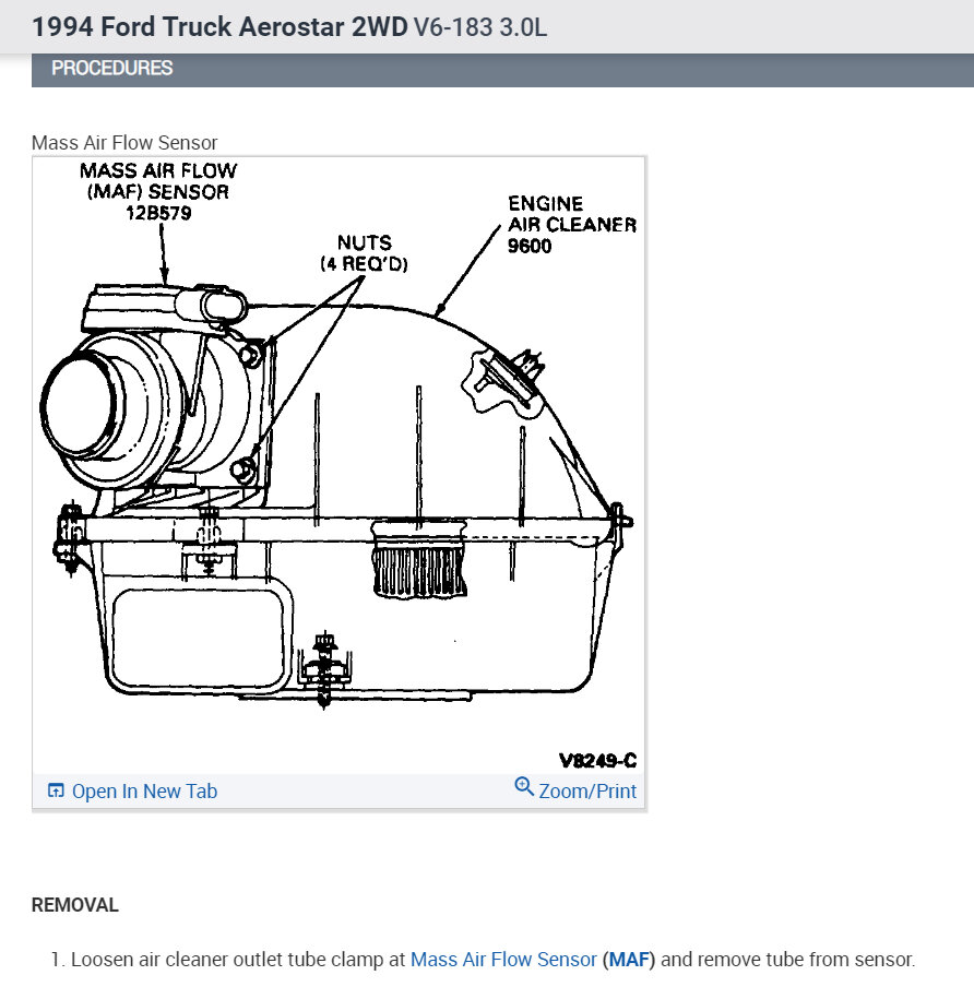

So, there are two things that can cause this to happen, either the MAF sensor is off making the computer think there is less air going into the engine (load) or the catalytic converter is getting clogged causing eh same effect. Here is a guide and the location of the MAF sensor so you can check it out:
These problems will not set a trouble code. Check out the images (below). Please let us know what you find. We are interested to see what it is.

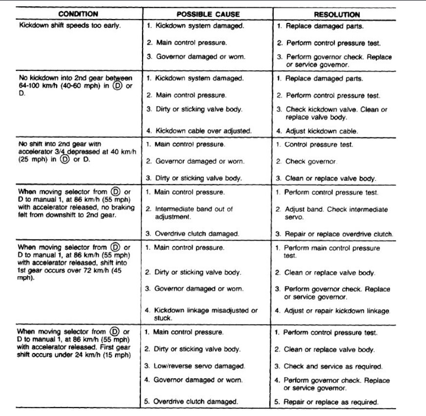

Yep, they don't say much about the pressure regulating solenoid, but I did find information on the OD gear issue.
From OD or D to 1 at 55 MPH Coasting, shift to first under 15 MPH See: Automatic Transmission-Transaxle - Symptom Related Diagnostic Procedures - Kickdown Shift Speeds Too Early
1. Main control pressure malfunction.
2. Sticking or dirty valve body.
3. Low/reverse servo damaged.
4. Governor damaged or worn.
5. Overdrive clutch damaged.
