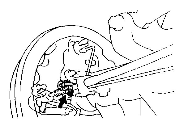

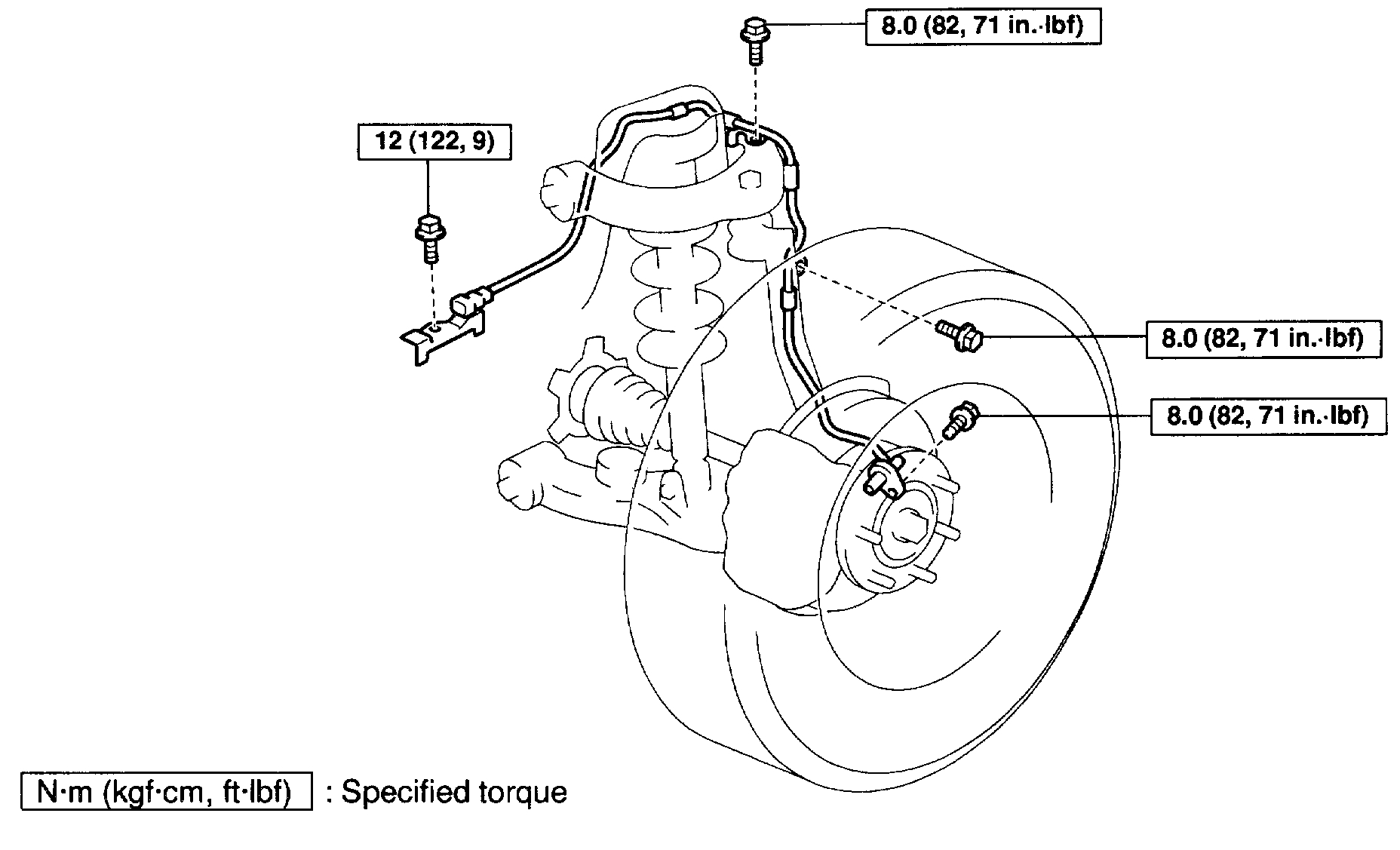

SPEED SENSOR, FRONT
Front Wheel Speed Sensor
See Pic 1
REMOVAL

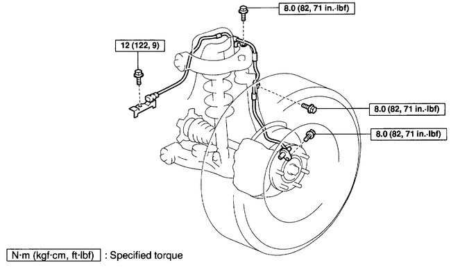

REMOVE SPEED SENSOR
See Pic 2
a. Disconnect the speed sensor connector.
b. Remove the 4 resin clips and 3 clamp bolts holding the sensor harness from the steering knuckle, upper arm and side rail.
Torque:
Steering knuckle and upper arm: 8.0 Nm (82 kgf-cm, 71 inch lbs.)
Side rail: 12 Nm (122 kgf-cm, 9 ft. lbs.)
c. Remove the speed sensor installation bolt from the steering knuckle.
Torque: 8.0 Nm (82 kgf-cm, 71 inch lbs.)
INSTALLATION
Installation is in the reverse order of removal.
CAUTION:
^ There are no foreign objects on the sensor or the part of the knuckle to which the sensor is to be installed.
^ The sensor is installed flat against the knuckle when you tighten the bolt.
HINT: After installation, check the speed sensor signal.

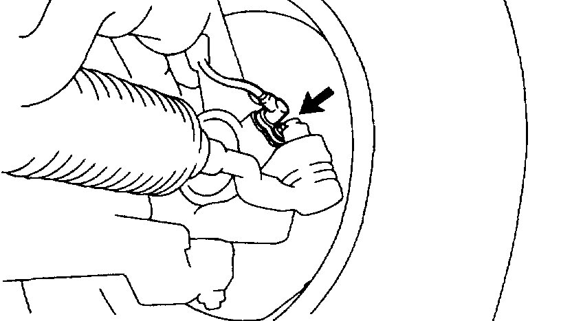

Rear sensor:
SPEED SENSOR, REAR
Rear Wheel Speed Sensor
See Pic 3
REMOVAL
REMOVE SPEED SENSOR
a. Disconnect the speed sensor connector, and pull out the sensor wire harness with grommet.
b. Remove the 5 resin clips, holding the sensor wire harness from the frame, upper control arm and axle housing.

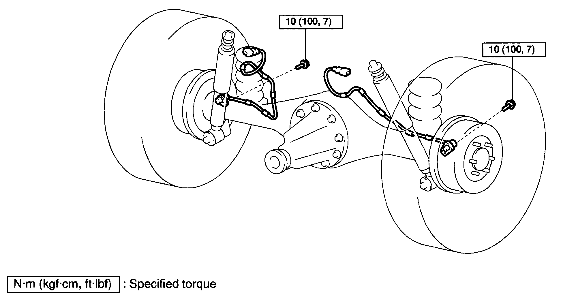

See Pic 4
c. Remove the mounting bolt and speed sensor.
Torque: 10 Nm (100 kgf-cm, 7 ft. lbs.)
INSTALLATION
NOTICE: Make sure that
