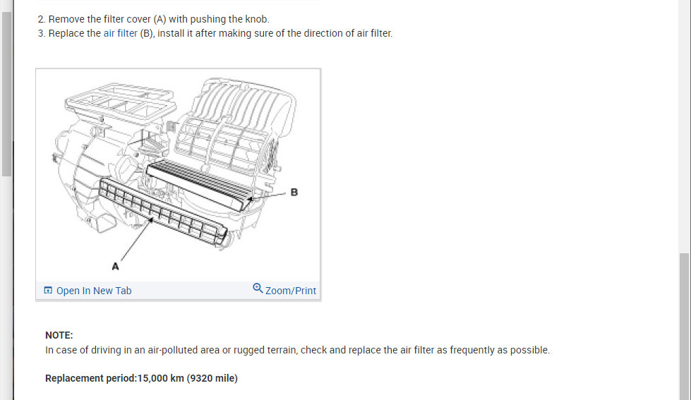

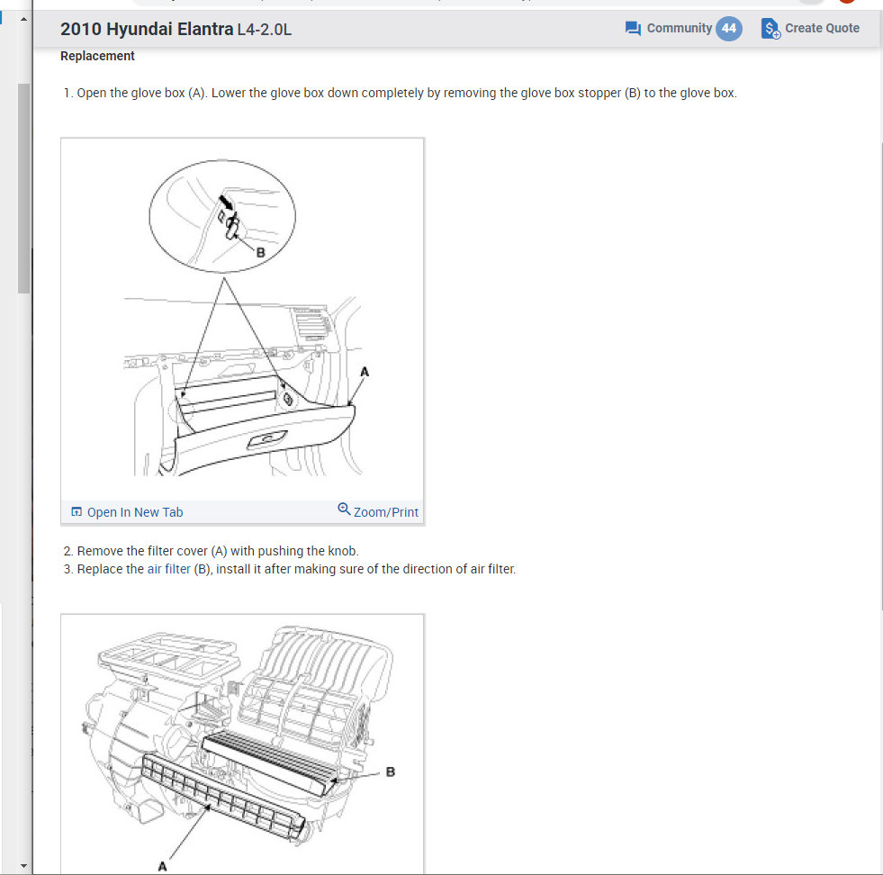

I would start with replacing the cabin air filter before you do anything else.
Here is a guide that will help with this:
https://www.2carpros.com/articles/how-to-change-an-air-cabin-filter
Below you will find the process from the manual that will give the specific info needed to replace this.

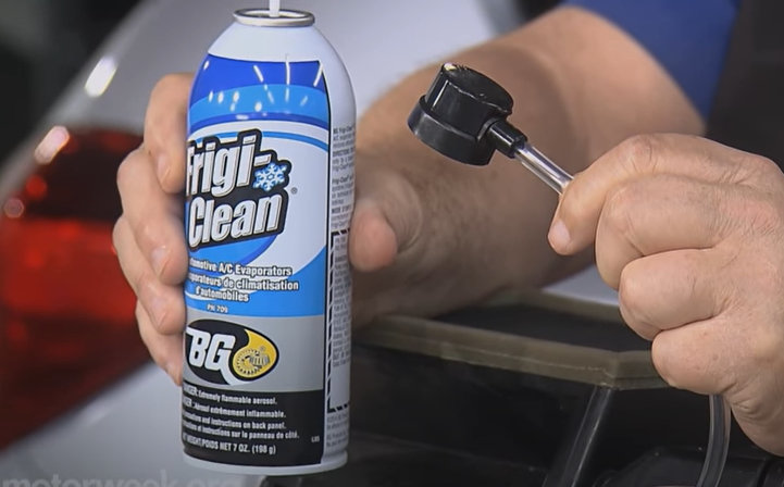

You can also try and clean HVAC housing using a chemical. These are not the easiest as you have to drill a hole in the housing and then install a fitting and spray it in.
There are many videos online. Just Google Clean your Automotive HVAC system
