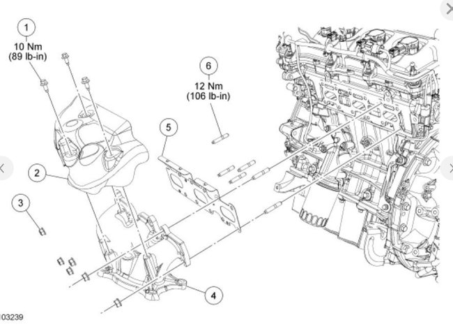

It almost sounds like the exhaust heat shield rattling. There is a heat shield on the exhaust manifold it makes similar noise when loose.
