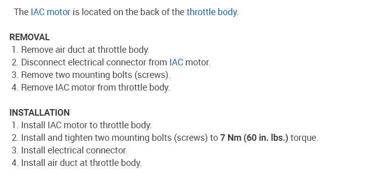

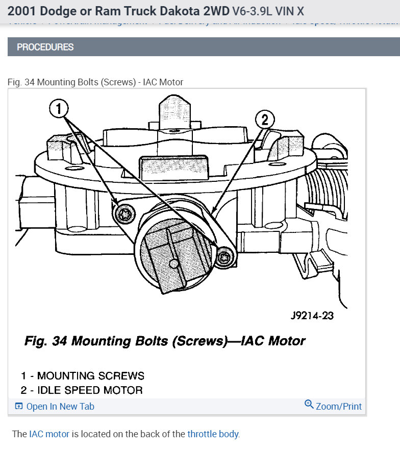

As I'm sitting at a light at times but not always. The truck kind of advances forward a tad. It only happens after about 45 seconds. I've changed the plugs wires, distributor cap, button, and cleaned up the IAC. It never does it in park and i went a day and it never did it all day. But it's back. Not often though.
What should i look at?

Why does it advance forward so hard if air leak?
Apr 29, 2023 at 6:11 AM
  • 55,443 POSTS
Because the computer system will surge while it is trying to make adjustments. I did notice you said you cleaned up the IAC and did not replace it, I would get a new unit because sometimes they can "glitch" causing the situation you have. Check out the images (below). Please let us know what happens.

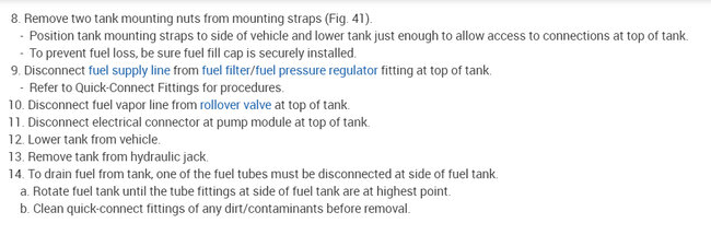

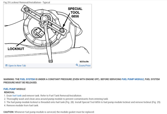

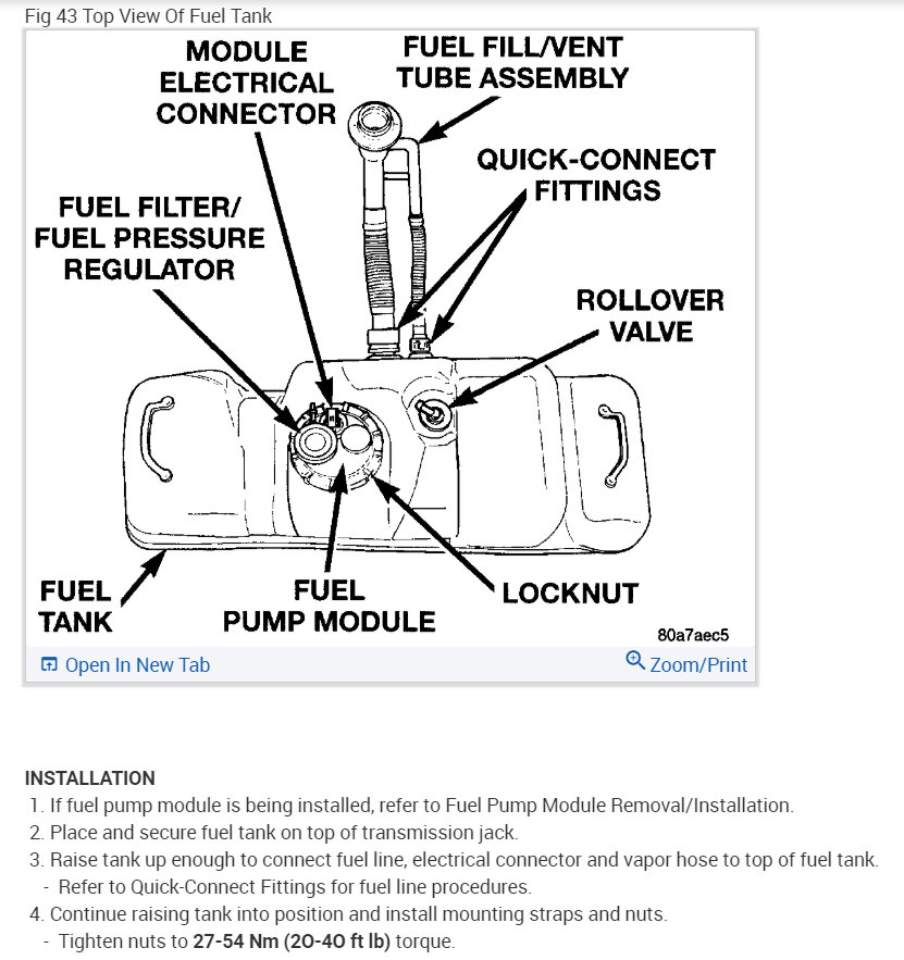

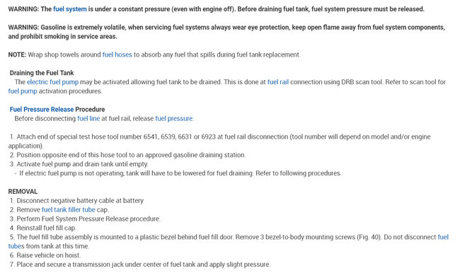

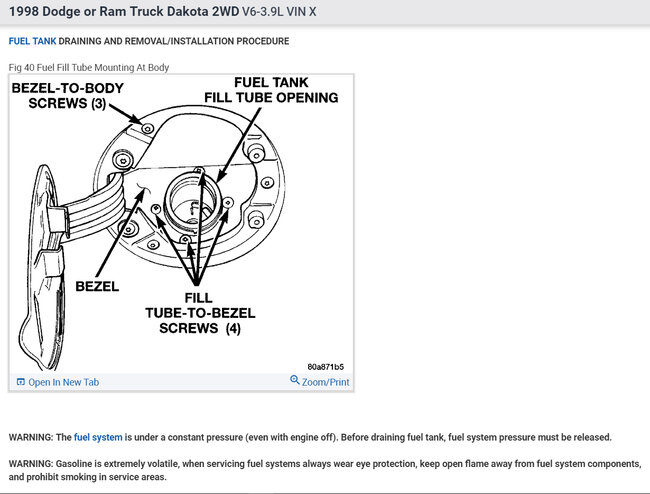

I noticed something and wanted to ask...It seems like the level of fuel in tank factors if. I didn't see it happen all day yesterday in traffic off on all day, then later. As fuel level got to a low level where light comes on it started doing that again. I just put half tank of fuel bk in and will see if it does anything. Can that be the fuel pump? I didn't get to check air leaks, but it would have happened yesterday if it was.
May 3, 2023 at 4:01 AM
  • 55,443 POSTS

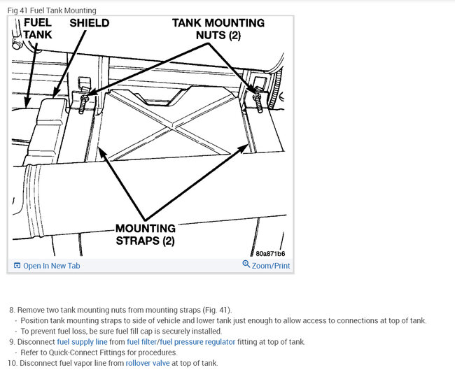

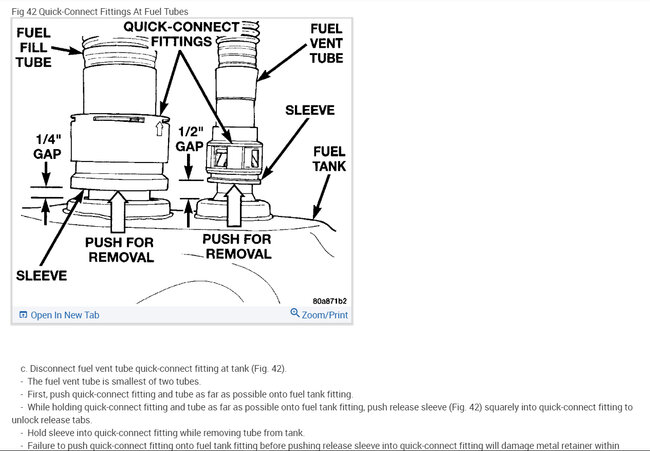

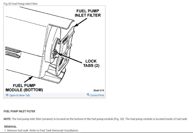

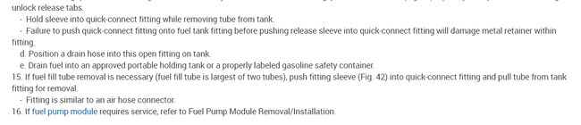

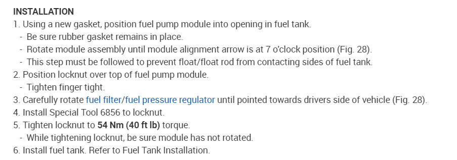

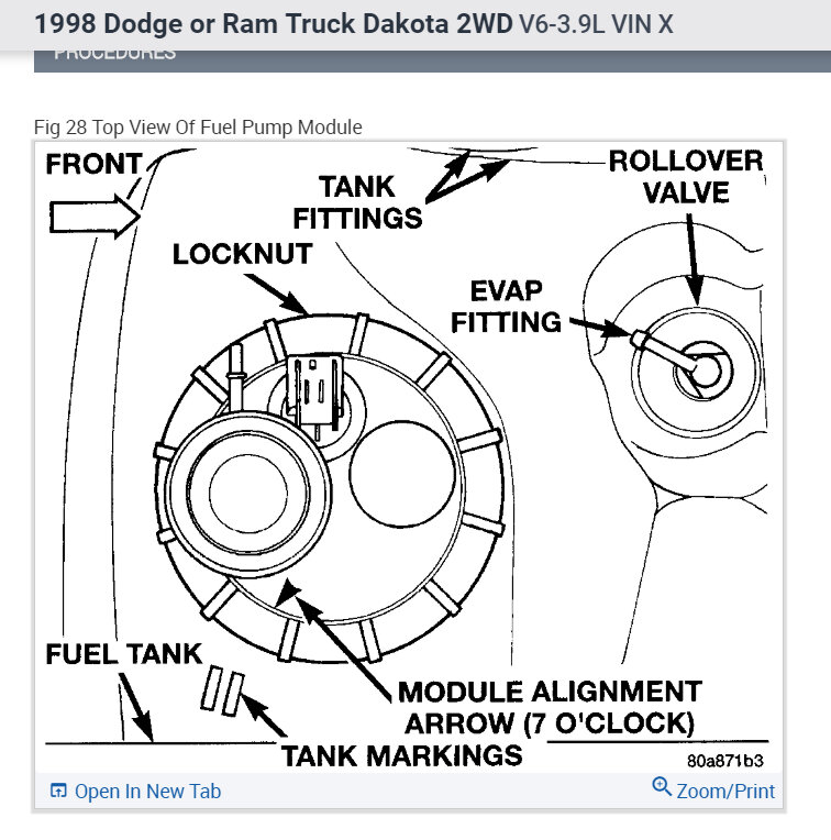

Yes, a weak fuel pump can cause this issue. Here is how to test the pump to confirm this is the issue. You can rent a fuel pressure gauge at the local auto parts store for cheap or free.
This guide can help walk you through the steps:
Regulated Pressure 339 +/- 34 kpa (49.2 +/- 5 psi)
Here is how to change the pump out in case you need it. Check out the images (below). Please let us know what happens.
May 4, 2023 at 3:49 AM

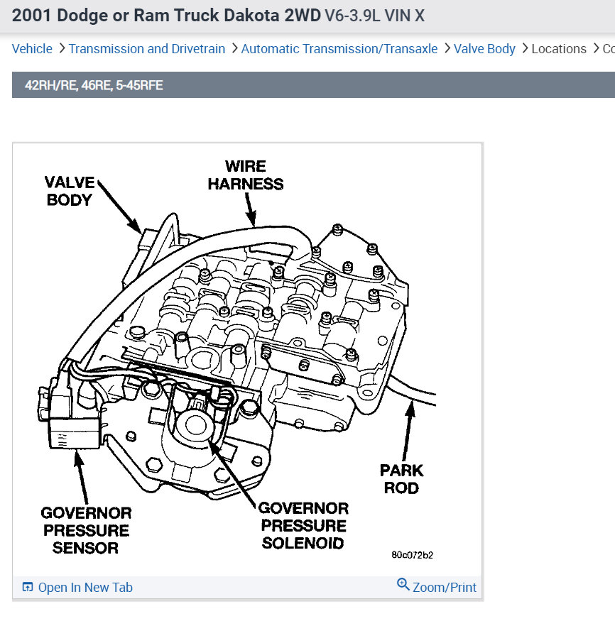

Turned out to be transmission code p1767.what sensor is it and how would i check circuit?
May 5, 2023 at 7:27 AM
  • 55,443 POSTS
Here is what is said: The P1767 code in a 2001 Dodge Dakota indicates a problem with the transmission's governor pressure solenoid circuit. This code is set when the Powertrain Control Module (PCM) detects that the governor pressure is not within the expected range.
The governor pressure solenoid is responsible for regulating the pressure in the transmission's hydraulic circuit, which controls the shifting of gears. When the solenoid malfunctions or its circuit has a fault, it can cause issues with the transmission's performance, including harsh shifting, slippage, and poor fuel economy.
I would check out the pressure control solenoid. Here is the location. Check out the images (below). Please let us know what happens.
May 6, 2023 at 4:21 AM

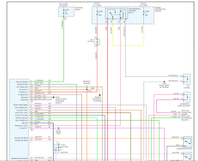

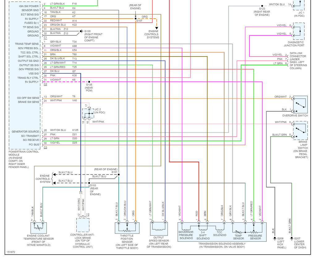

You must remove the pan to check the circuit. If the circuit is okay replace the solenoid. Here is a guide and the transmission wiring diagrams so you can test the connections:

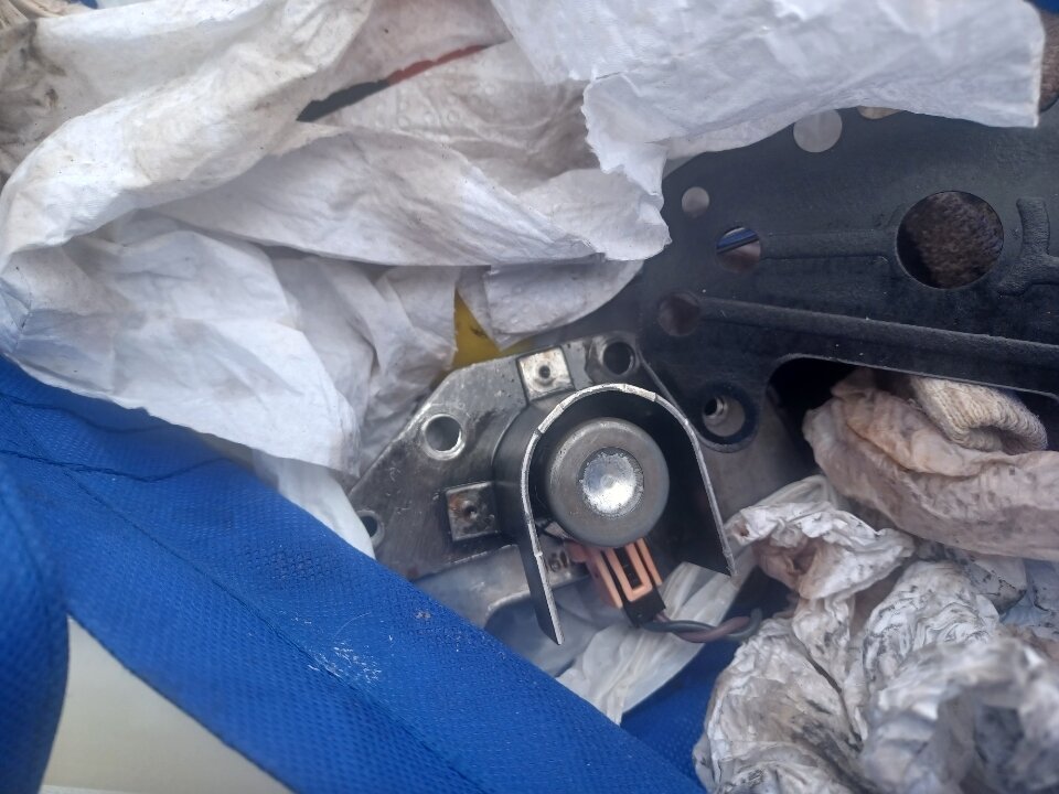

HIDDEN4321
  • 62 POSTS
Got it, what's the torque for each bolt and the torque screws to gov pressure body?
And to the pan gasket.
May 13, 2023 at 3:42 AM
HIDDEN4321
  • 62 POSTS
Better pic. should i go ahead with replacing both transducer and gov press solenoid and just switch out the body. Which have both intact already?
Any way to test them when off?
May 13, 2023 at 3:43 AM
  • 55,443 POSTS
I would test the continuity through the coil. Please let me know if that fixes it.
