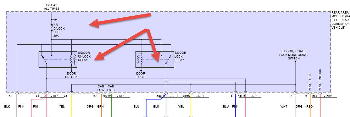

my left sliding door just completely stopped working. it do not even move or anything. it is stuck I cannot even open it using my hand and my right sliding door the only way we can open it. sometimes is by using the hand, it does not even use the motor sometimes to open it automatically. so I was wondering is there a fuse that I can replace or both the motors gone and the doors? Do I need to replace the motors?

check items in pic then have a mechanic scan for codes as it could be the modules in the doors.
