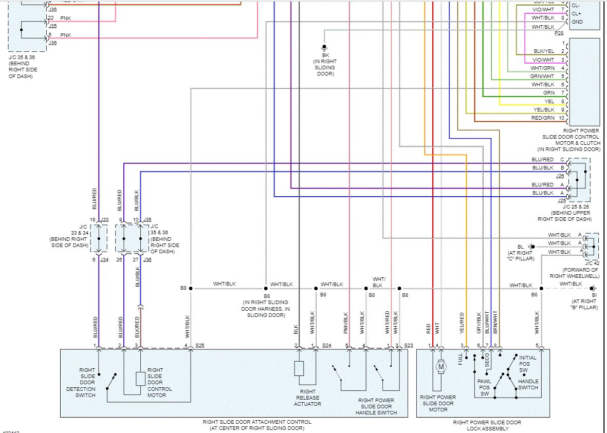

Do you have an schematic of the sliding doors? Just want to check out the mechanism on the glass window function. The window goes down but towards the bottom it makes a cracking noise. Then I just roll it right up before anything "breaks".

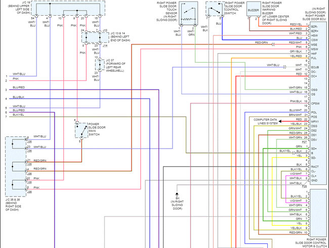

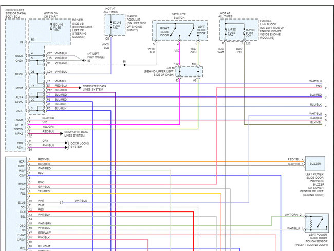

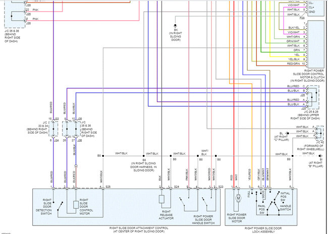

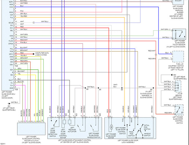

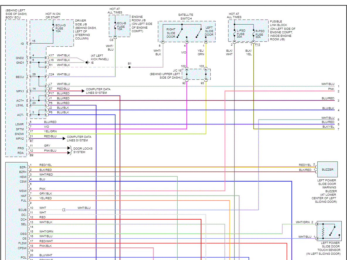

I'm not sure I understand what you are asking for. When you say schematic, I think electrical. So, I have attached the entire wiring schematic for the sliding doors. It that isn't what you needed, let me know.
Note that I had to cut each page in half to make it readable. However, I did overlap them so you can follow.
Let me know if this helps.

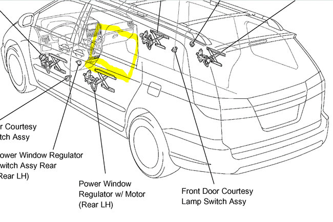

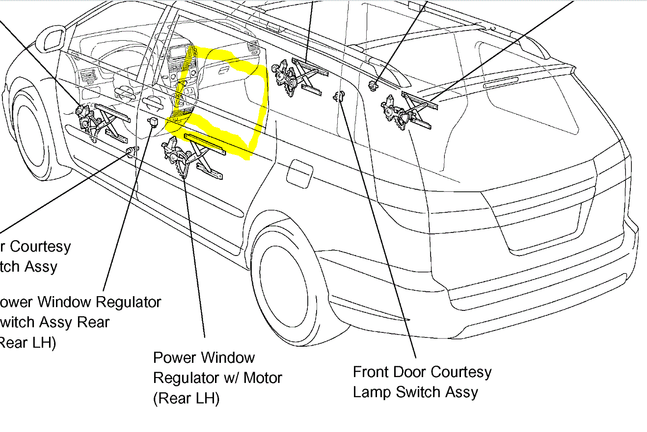

Yes, I mis-communicated my request. I meant to say an actual photo of the door panel with the aesthetic cover off. I just want to see where the tracking harnesses are that hold the window up and down, if this makes sense.

I have pics for the front, but not the rear. The only one I was able to find was a general pic that shows how the window motor and regulator are in the door. Don't laugh, but in yellow is where the glass would be. I tried to help you see where the glass attaches to the regulator.
Now, if you are having a noise when you lower it, I would remove the panel and see if something is loose or hitting when the glass is put down. I have a feeling once the panel is removed, you will see what is making the noise simply because there isn't a lot there.
Let me know if this helps. Sorry for the first poor coloring. LOL Let me know if I can help.
