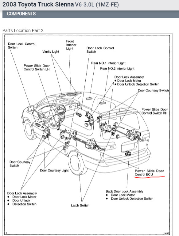

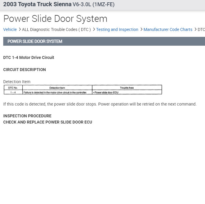

If the reset procedure fails, then the module needs to be replaced.
I have attached the diagrams for the door module for anyone might be looking to replace it.
Let me know of any questions.
