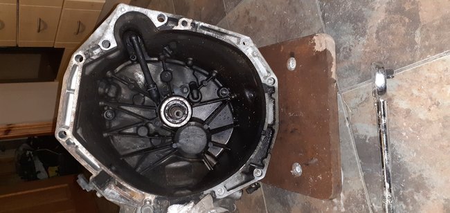

The clutch pedal went to the floor and stayed there and there was clutch fluid leaking from the housing where the slave cylinder is.
I talked to a few garages, and they all said that the slave cylinder was gone inside the engine and gave quotes that were double what the car was worth, so I said I'd have a go myself, I'm no mechanic, but I am handy around engines.
I took out the old slave cylinder and it looked okay, but I fitted a new one just to be sure and put it all together and it worked I was delighted. but a few weeks I noticed a small drop of oil coming from the same place the clutch housing, but it was running okay. I topped it up very little. It showed it was slightly under max level and three months later the clutch pedal went to the floor and stayed there again, but if I top it up with clutch fluid it will work for about a week and go again. any ideas? the clutch fluid drops every time the pedal is pressed. could I be unlucky and got a fault one? It looked perfect when I took it out again but so did the original one. please help

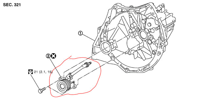

This vehicle isn't offered in the US, but I believe it is very similar to the Nissan Sentra we have.
I attached a pic below of the Sentra's slave cylinder. Is that what you have? Also, make sure there are no leaks at connectors as well.

Thanks for your reply. It looks like the same one I have. I tried your suggestion a few times and it leaks out of a notch in the housing for the slave cylinder when the clutch pedal is pressed down.

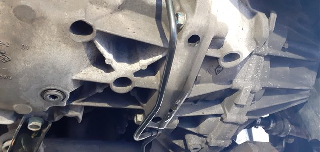

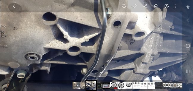

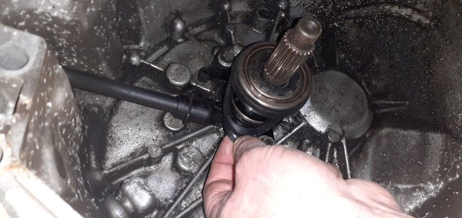

I can't seem to add any more than one photo at a time, but this is where it is leaking from. If you zoom in on the photo so you can see exactly where it is leaking from.
Feb 24, 2022 at 6:10 AM

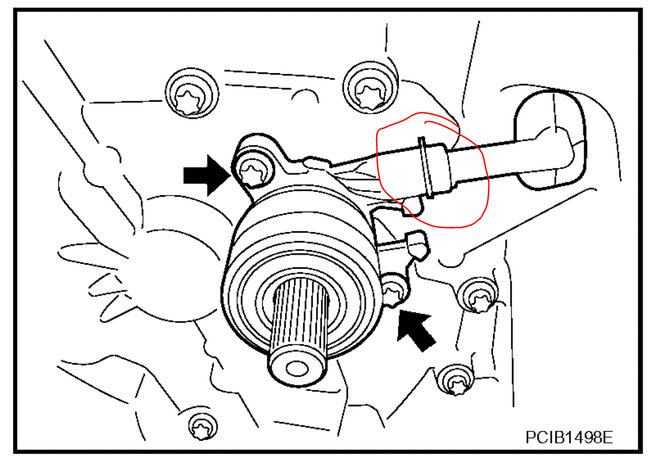

Based on where you see the leak, it is likely in the bell housing. Do you have the transmission out as shown in pic 1? If not, I attached a pic below of the part in a Sentra. I circled my first suspect area for a leak.

Thanks Joe. I have it back together now, but I still have the old one and it is exactly like the one you have circled in the picture. so, do you think the new one i got was faulty? Because the old one was working fine for 3 years i had the car and started leaking the same way. Is there any way I can fix it or do I have to buy another new one? I hope it doesn't start leaking after 3 months. Do you have any idea what I can do? Thanks very much for your speedy reply.

You are very welcome. I don't like to ask, but where did you get the replacement? I ask because a lot of people sell parts online at low prices and provide poorly made parts. I have seen so many imported electrical and mechanical components that are truly junk.
As far as repair, if it isn't at the connection, get a new one. There isn't a way to repair the crimps where it is put together.
Have you already removed it? If not, there is a chance it is at the connector.

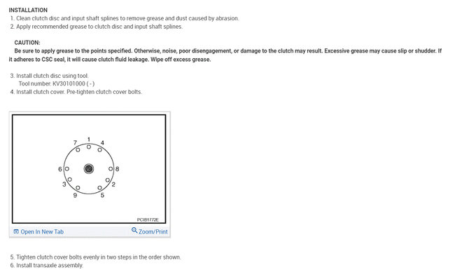

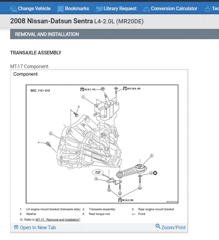

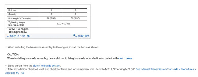

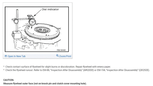

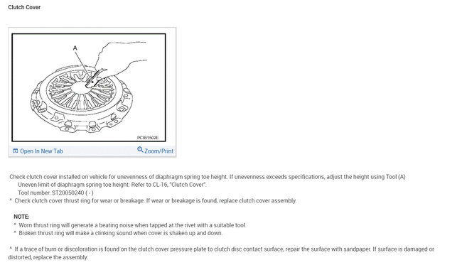

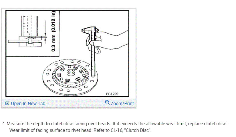

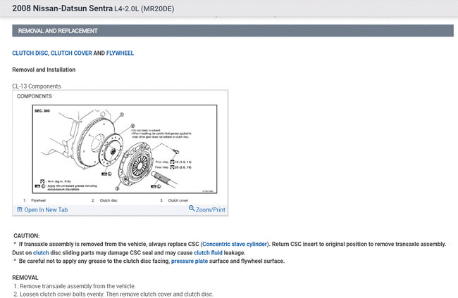

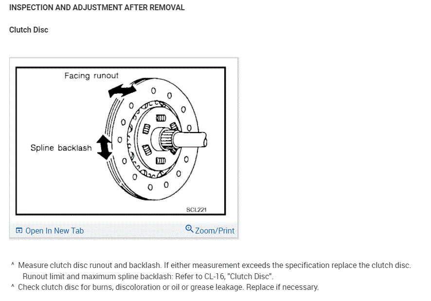

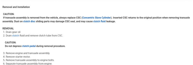

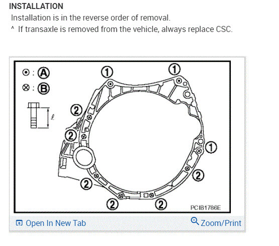

As far as the clutch, the first 6 pics below are removal/replacement of the clutch and inspection. The remaining pics are for the removal and installation of the transmission.

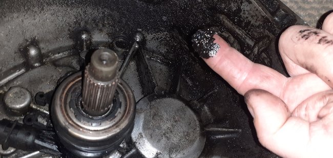

Hi Joe, I tuck the bell housing and gear box out this weekend to find the whole slave cylinder had burst inside the bell housing and made a right mess inside it. The new one won't be in until tomorrow. I'm getting it from Nissan hoping it would be better quality. When the pedal is hard to push down do you think it is something wrong with the clutch side or the gearbox side? I've never taken any of them apart before, what do you think I don't want to fit the new one and it goes as well?

This is what it looks like but when I fitted that one the bell housing was as clean as if it was new, I hope you can see how much muck that is in there and where it came from it not just oil that is in there it is thick gritty muck. Where do you think it came from?
Mar 6, 2022 at 4:07 AM
  • 110,248 POSTS
Wow, that is a mess. Is it just dirt collected with the fluid leaking from the slave?
As far as the clutch, that wouldn't be related to the transmission, but rather the pressure plate.

That doesn't seem too bad. However, you have already gone to a lot of work removing the transmission. You may want to replace the pressure plate and clutch disc while it is out.
A bit of play is normal because it isn't installed, but that seems a bit excessive.
