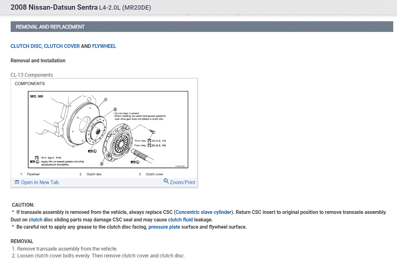

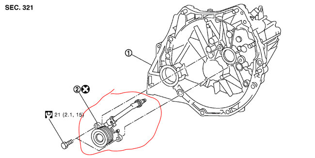

This vehicle isn't offered in the US, but I believe it is very similar to the Nissan Sentra we have.
I attached a pic below of the Sentra's slave cylinder. Is that what you have? Also, make sure there are no leaks at connectors as well.
Let me know what you find.
See pic below.

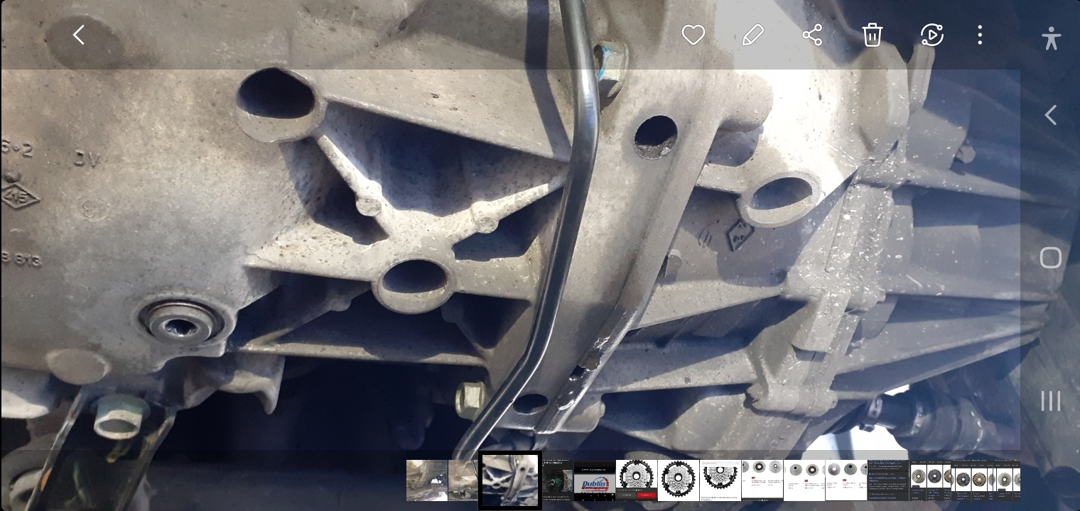

TONY BERRY
  • 22 POSTS
Thanks for your reply. It looks like the same one I have. I tried your suggestion a few times and it leaks out of a notch in the housing for the slave cylinder when the clutch pedal is pressed down.

TONY BERRY
  • 22 POSTS

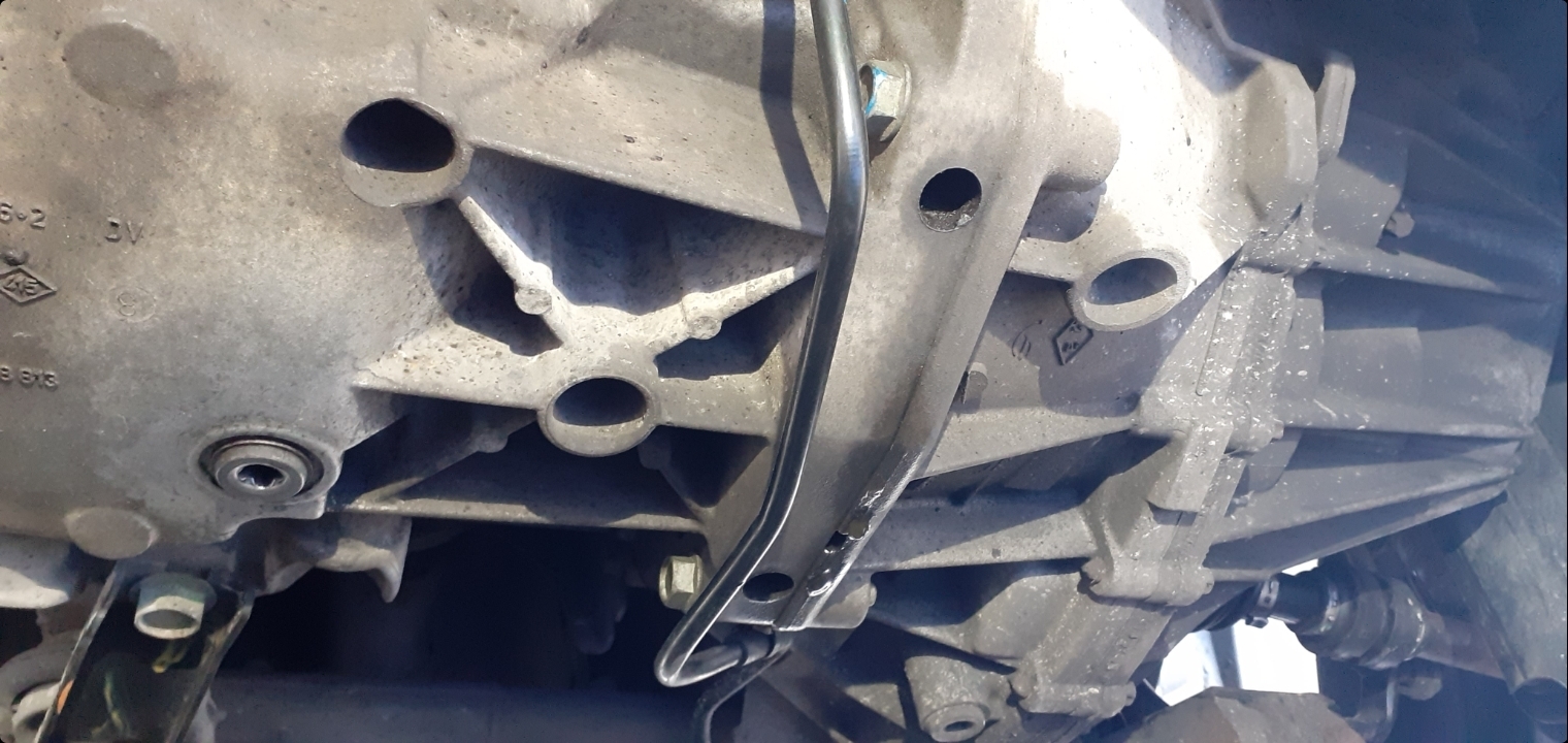

I can't seem to add any more than one photo at a time, but this is where it is leaking from. If you zoom in on the photo so you can see exactly where it is leaking from.

TONY BERRY
  • 22 POSTS
Hope these photos make it easier to diagnosis. I wasn't able to upload any more than one at a time but I'm probably doing it wrong.

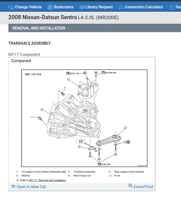

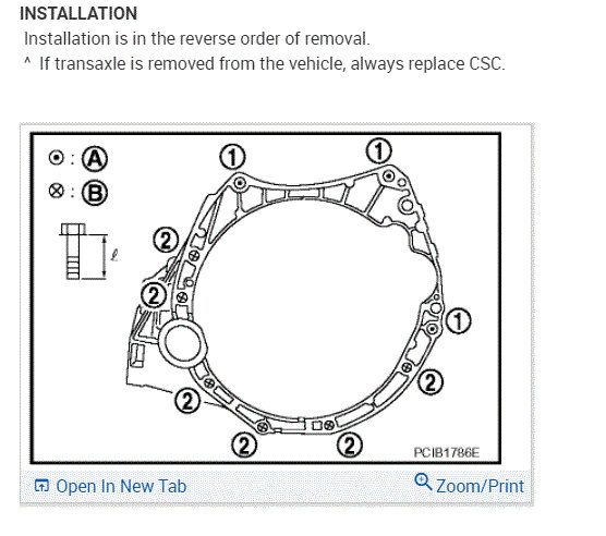

  • 110,240 POSTS
Tony,

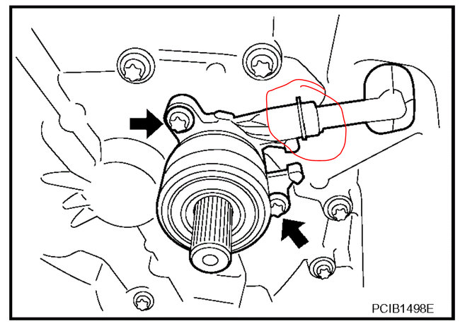

Based on where you see the leak, it is likely in the bell housing. Do you have the transmission out as shown in pic 1? If not, I attached a pic below of the part in a Sentra. I circled my first suspect area for a leak.
Feb 24, 2022 at 10:53 AM

Thanks Joe. I have it back together now, but I still have the old one and it is exactly like the one you have circled in the picture. so, do you think the new one i got was faulty? Because the old one was working fine for 3 years i had the car and started leaking the same way. Is there any way I can fix it or do I have to buy another new one? I hope it doesn't start leaking after 3 months. Do you have any idea what I can do? Thanks very much for your speedy reply.

You are very welcome. I don't like to ask, but where did you get the replacement? I ask because a lot of people sell parts online at low prices and provide poorly made parts. I have seen so many imported electrical and mechanical components that are truly junk.
As far as repair, if it isn't at the connection, get a new one. There isn't a way to repair the crimps where it is put together.
Have you already removed it? If not, there is a chance it is at the connector.

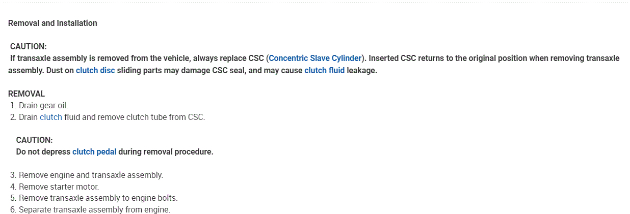

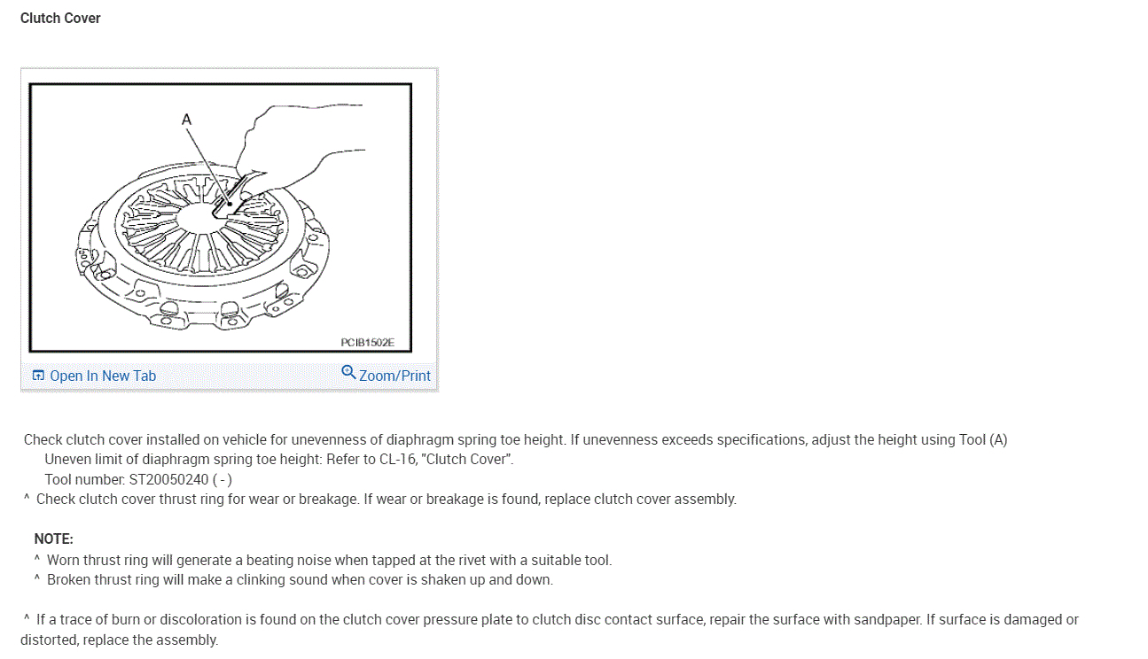

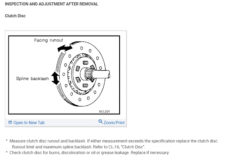

  • 110,240 POSTS
No problem whatsoever. Take your time. You're lucky it wasn't worse.

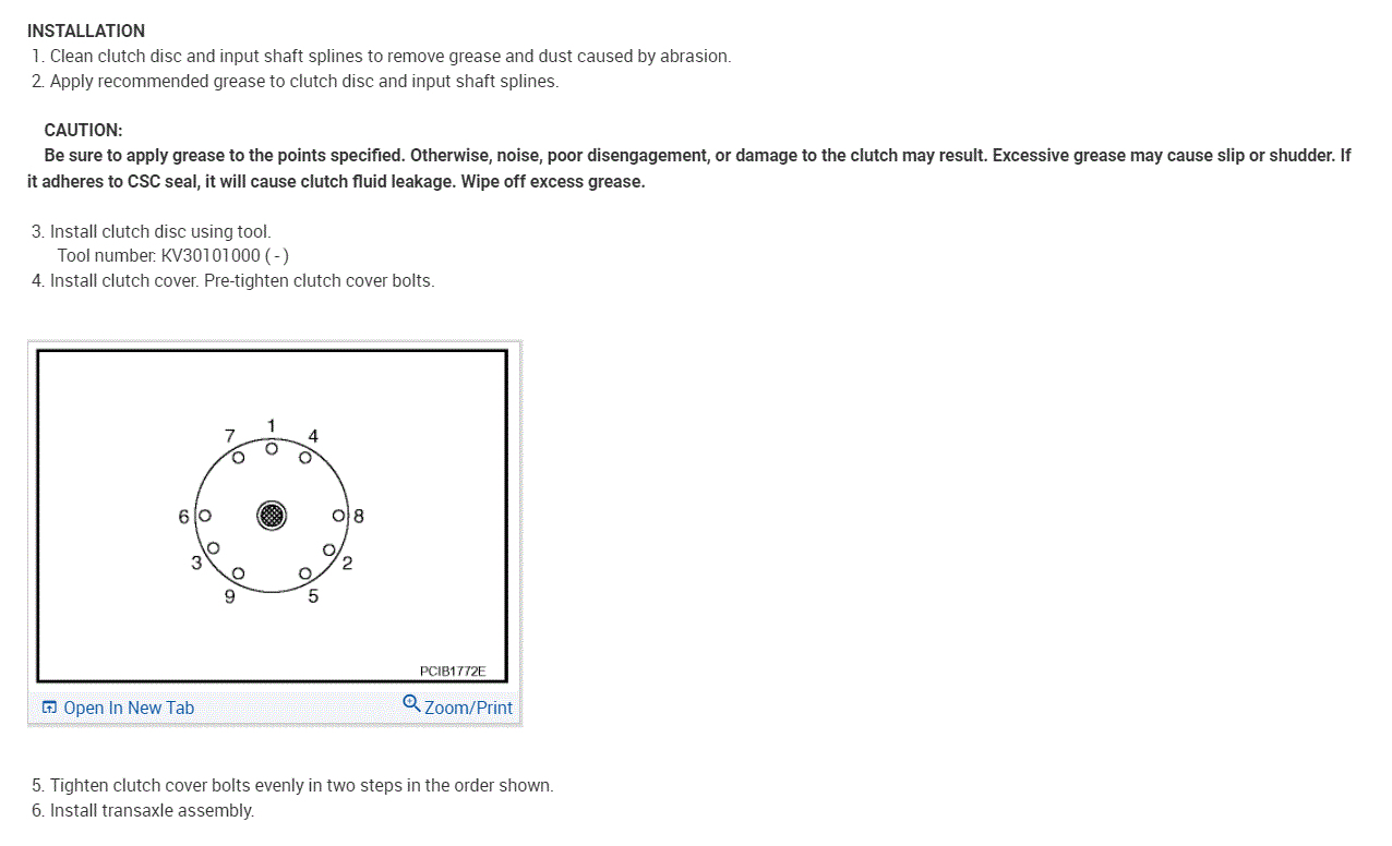

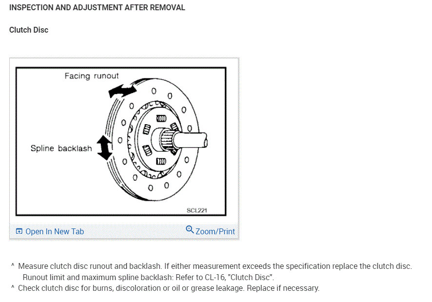

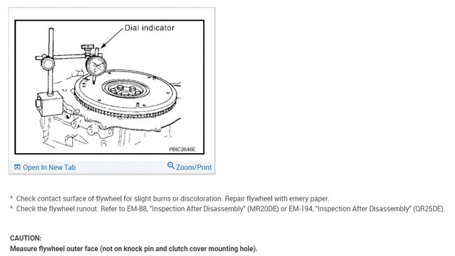

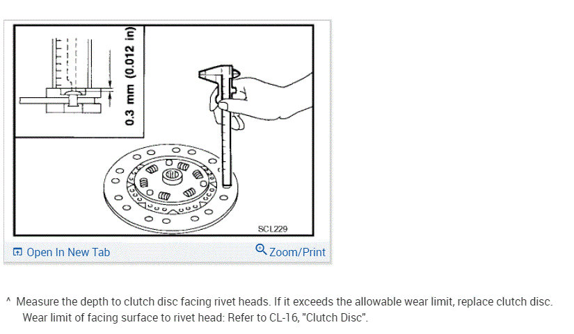

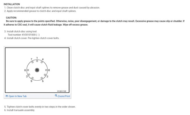

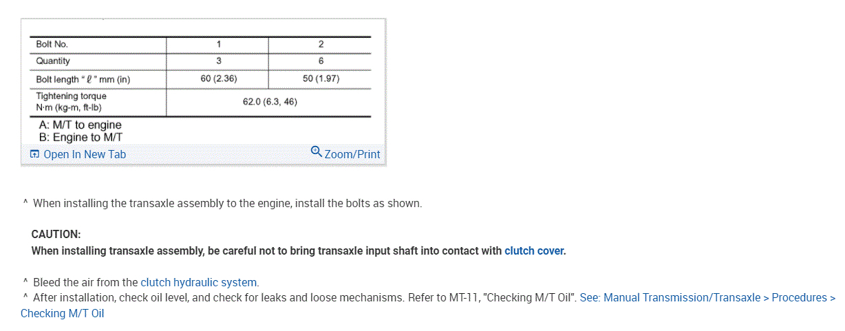

As far as the clutch, the first 6 pics below are removal/replacement of the clutch and inspection. The remaining pics are for the removal and installation of the transmission.

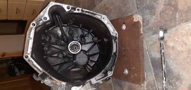

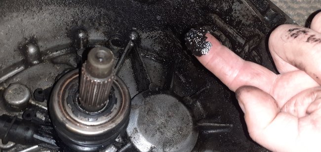

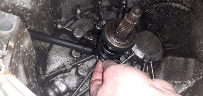

Hi Joe, I tuck the bell housing and gear box out this weekend to find the whole slave cylinder had burst inside the bell housing and made a right mess inside it. The new one won't be in until tomorrow. I'm getting it from Nissan hoping it would be better quality. When the pedal is hard to push down do you think it is something wrong with the clutch side or the gearbox side? I've never taken any of them apart before, what do you think I don't want to fit the new one and it goes as well?

This is what it looks like but when I fitted that one the bell housing was as clean as if it was new, I hope you can see how much muck that is in there and where it came from it not just oil that is in there it is thick gritty muck. Where do you think it came from?
Mar 6, 2022 at 4:07 AM
  • 110,240 POSTS
Wow, that is a mess. Is it just dirt collected with the fluid leaking from the slave?
As far as the clutch, that wouldn't be related to the transmission, but rather the pressure plate.

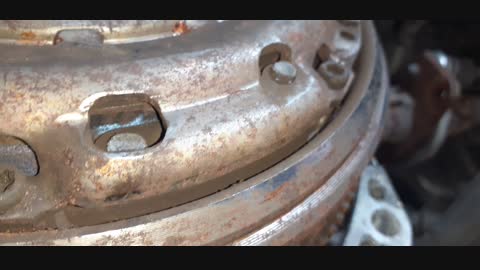

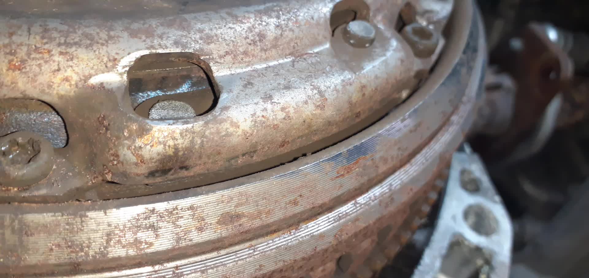

Thanks Joe, but when you said the pressure plate, do you mean I should take out the clutch and replace the pressure plate as well?

Should there be play like in the short video I have attached or is something like the clutch plate worn-out?
I haven't put in the new slave cylinder yet. When I saw the movement where the fingers are in the outer plate is, I said I'd ask your advice first. Thanks Joe.
Mar 6, 2022 at 8:54 PM
  • 110,240 POSTS
That doesn't seem too bad. However, you have already gone to a lot of work removing the transmission. You may want to replace the pressure plate and clutch disc while it is out.
A bit of play is normal because it isn't installed, but that seems a bit excessive.
