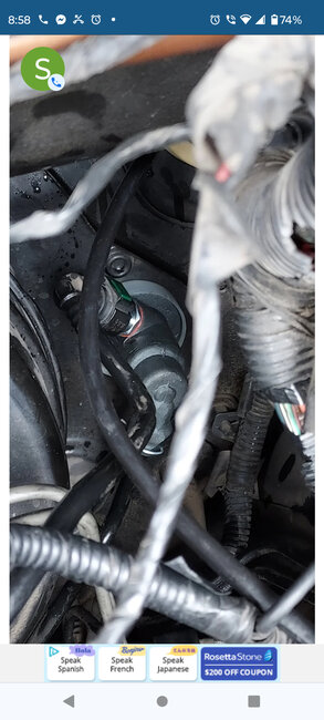

Having a hard time to extract the slave or master cylinder out, I've tried turn it clockwise and nothing happens.

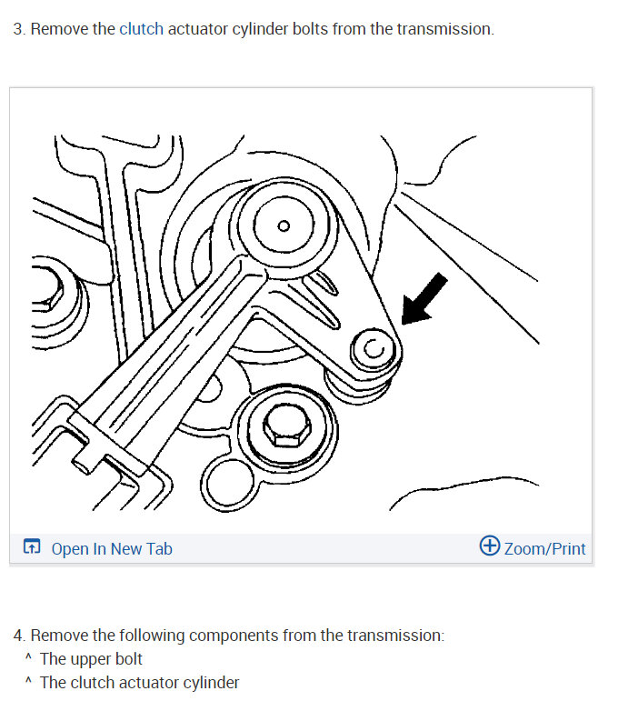

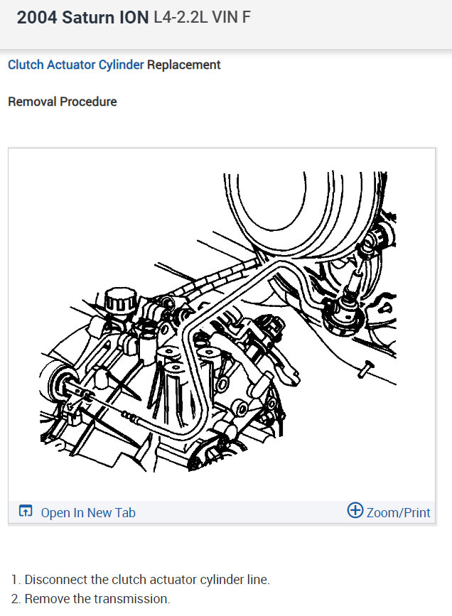

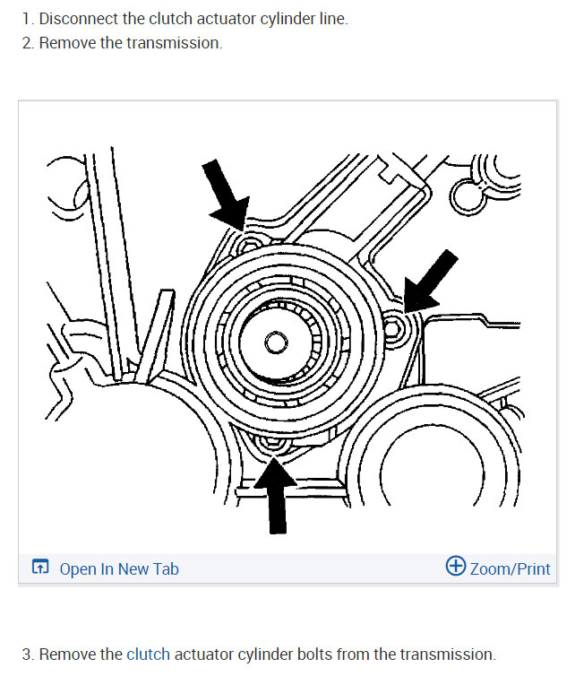

You must remove the transmission of the car to replace the clutch slave cylinder, here is a video of the job being done on a similar car so you can see what I am talking about please I have including diagrams in the images below to show you how the job is done on your car.
https://youtu.be/6N6b5F2ChyE?si=XfnVpmEL4nFAQyVr
Check out the images (below). Let us know if you need anything else.

LUIS7160
I have replaced the slave cylinder, but I have no pressure at all is a Saturn ion 2004, Pedal goes to the bottom and stays there.
Sep 4, 2024 at 6:12 AM
LUIS7160
That's the slave cylinder.
Sep 4, 2024 at 6:15 AM
  • 55,694 POSTS
That's the clutch master cylinder. It should self-bleed, I would make sure it is full of fluid and then pump it about 50 times you should get a good clutch pedal. Let me know.
Sep 5, 2024 at 1:02 AM
LUIS7160
I just replaced the slave cylinder but still no pressure at all, it could be bubbles? How do I purge it? Or could it be another problem?
