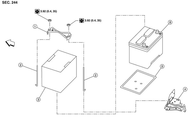

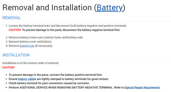

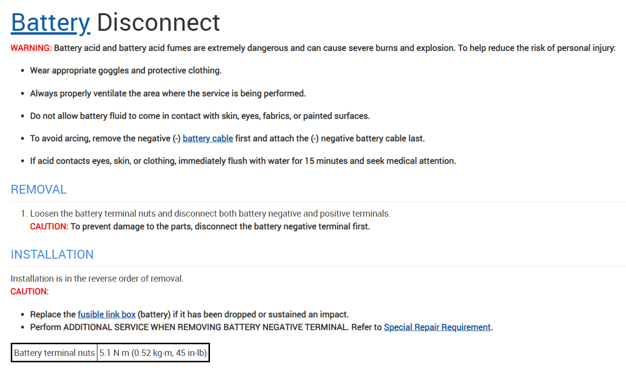

Yep, it sounds like the julot caused the battery to short our internally or you have a bad connection at the battery either way here are guides to help us fix the problem and directions for your car in the images below.
and
https://www.2carpros.com/articles/how-to-replace-a-car-battery
To be sure you can remove the battery and take it to an auto parts store for testing. Check out the images (below). Please upload pictures or videos in your response of the problem so we can see what's going on.
