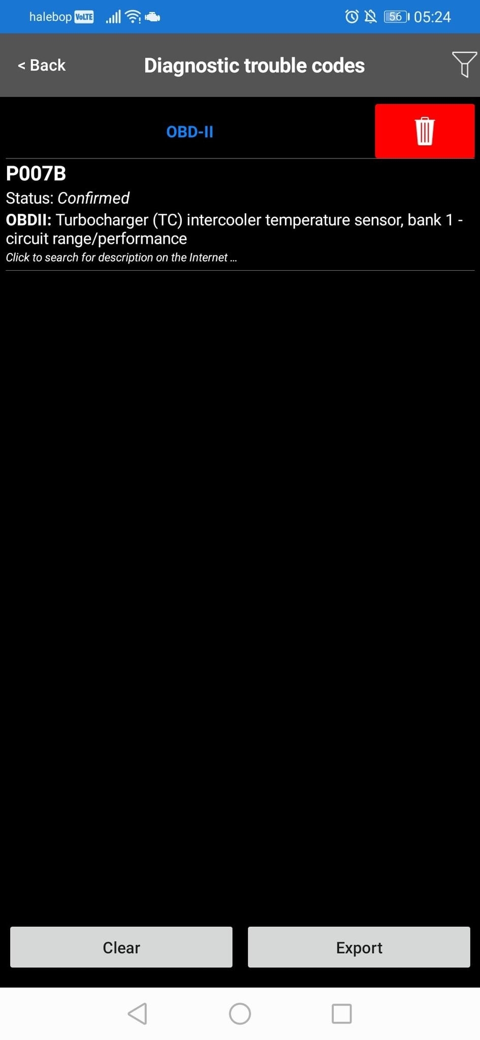

I'm getting this trouble code and wonder where can i find that sensor. Any diagram or picture where it's located.
Error code i get is P007B see picture attached.
Skoda Octavia 1.0 TSI.

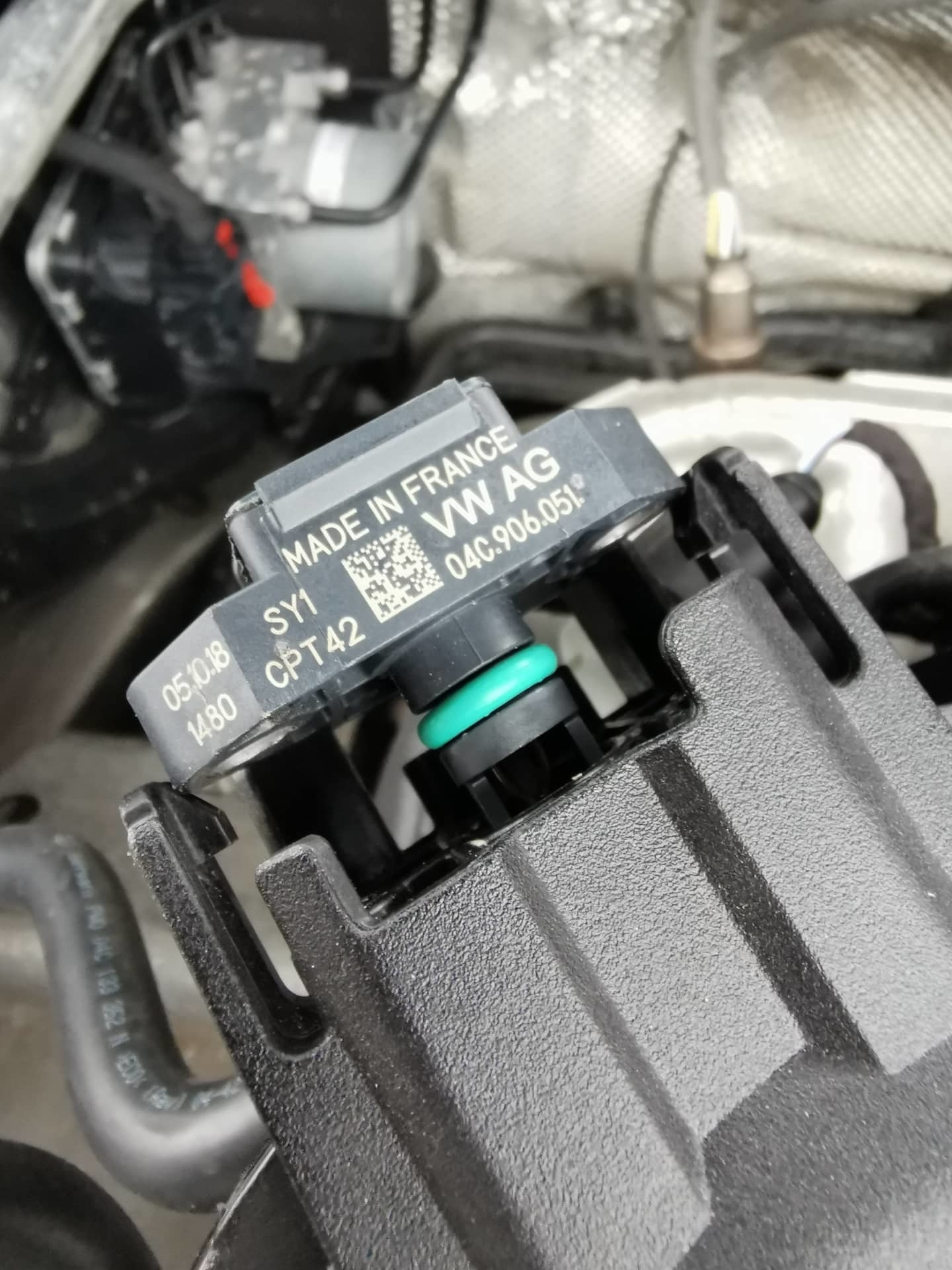

Good morning,
I attached a picture for you of the sensor.
Turbocharger (TC) Intercooler temperature sensor, bank1

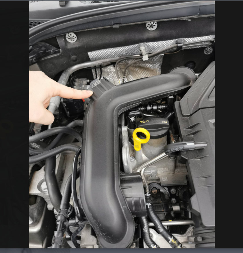

Is it this sensor?

And this is the error code i get see PIC.

That is correct. That is the sensor.

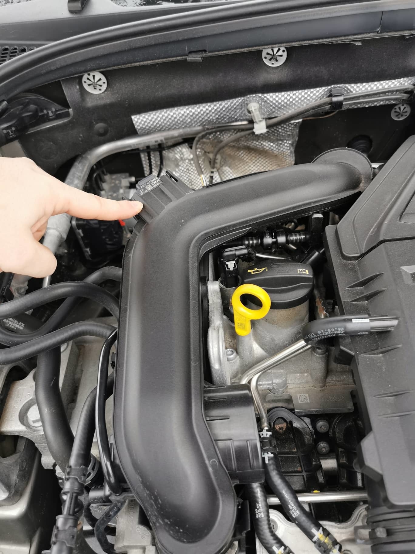

Another pic of the sensor.

ASEMASTER6371 then thank you mate i ordered right sensor at least. I hope it will solve my issue.
