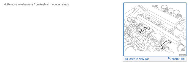

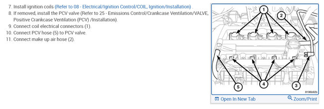

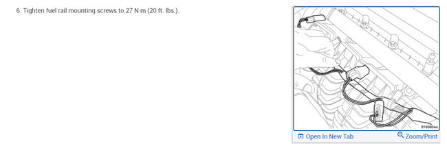

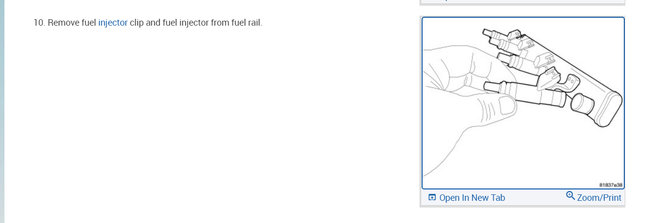

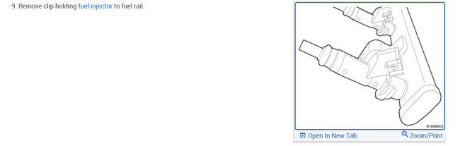

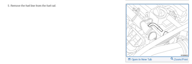

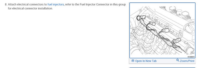

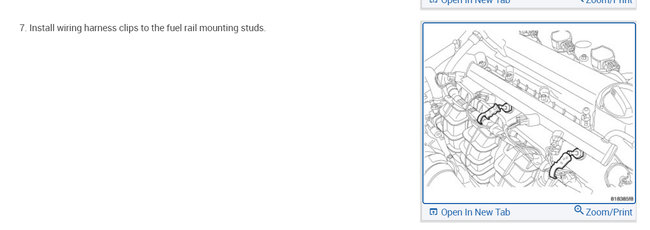

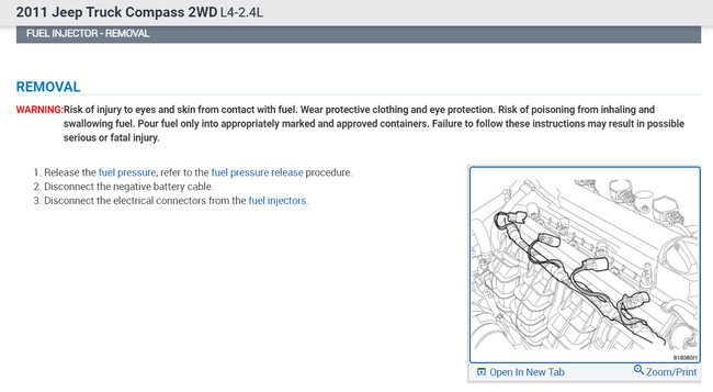

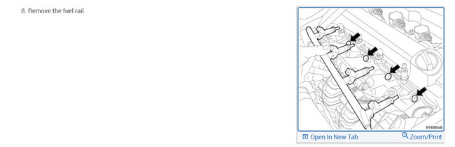

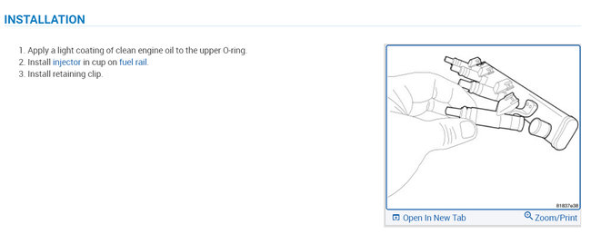

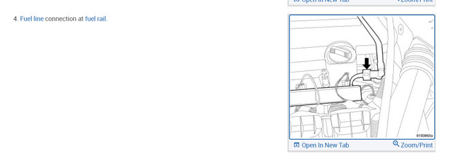

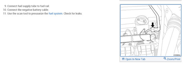

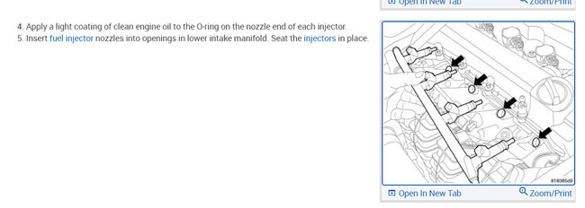

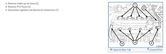

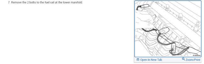

If the compression is good the most common thing that goes bad is the fuel injector. here is a guide to help you make sure the compression is good and how to change out the fuel injector in the diagrams below:
Here is a generic guide that can help you see what you are in for when doing the job:
https://www.2carpros.com/articles/how-to-replace-a-fuel-injector

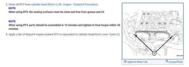

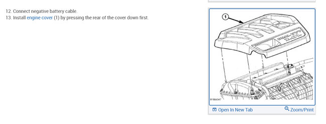

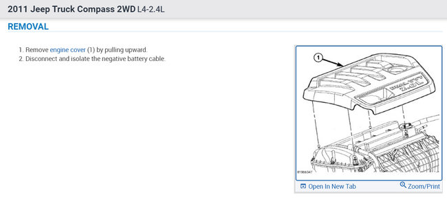

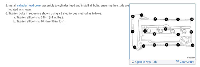

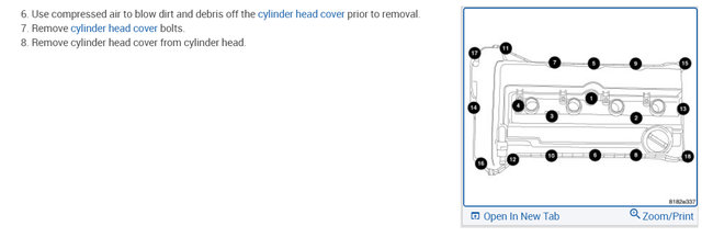

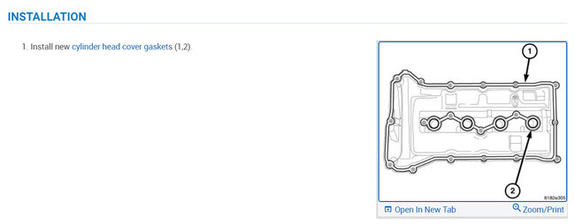

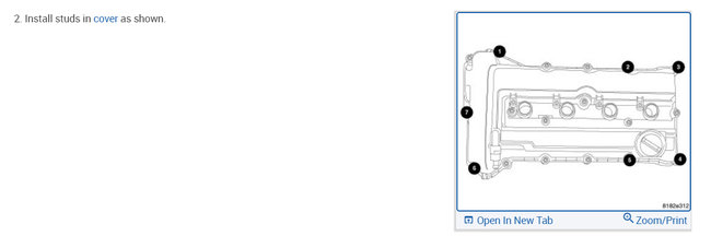

Okay, we need to remove the valve cover and use a flashlight to check for a broken valve spring on cylinder #2. Here is how you can remove the valve cover in the diagrams below. I would remove the spark plug to make sure it is not cranked as well. Let me know. Check out the diagrams (below). Please let us know what you find.

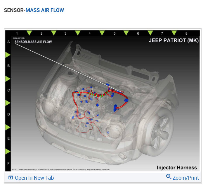

Okay that helps, when you get this code, it could mean the MAF sensor is not working correctly. Also, when you have the valve cover off did you check the camshaft lobe for wear?
