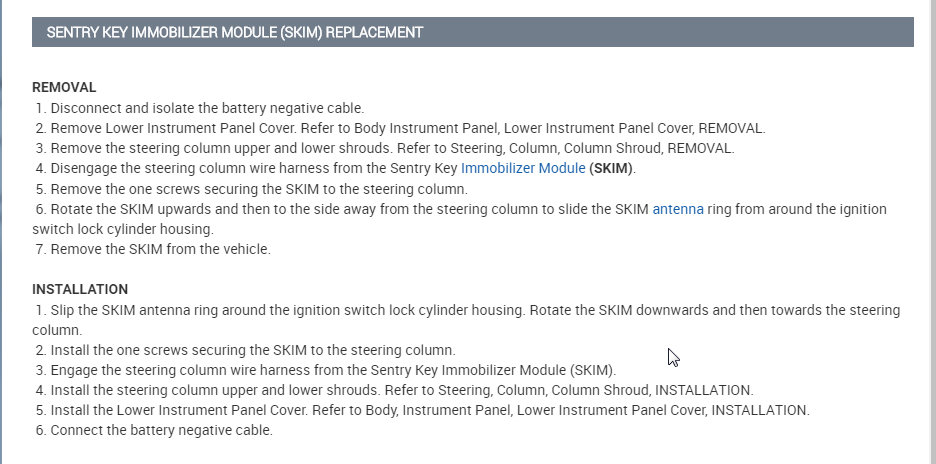

Hello. I am having very serious issues with the SKIM/SKIS unit in column area. the unit is activating/malfunction at complete random, triggering the immobilizer unit constant. I and another mechanic friend had original thought it was the ECM unit causing problems. Wrong. A brand new ECM was programmed and installed on July 23. Made no difference. SKIM unit still activates immobilizer at full random. There isn't anywhere in my county I haven't been stranded because of this faulty SKIM unit. My priority question is just this: Can I fully remove this malfunctioned SKIM unit, completely wipe and erase the new ECM memory to pre-install, use a non-chip blank Dodge key instead of transponder chip key. will the car start and run without any SKIM unit? I will greatly appreciate any professional auto tech help and answers to my serious car issue. Thank you with regards.

The short answer is no. You cannot replace this unit with a non transponder unit. The PCM is programmed to get the valid key code from the key and SKIM then it allows the start. If you don't have one, the PCM will never get the signal and never start the engine. Have you replaced the SKIM?
If not, I would think this and a new key would be my next step. Let me know and we can go from there. Thanks

Normally when you get a SKIM it comes with new keys so it may not be the key but it sounds like the SKIM issue so I would just get keys with it. Unfortunately there is not much you can do with it. There is no way to repair it as it is a part that just has to be replaced if faulty. Plus you are not able to bypass it so if this is malfunctioning then you have to replace it. Sorry to be the bearer of bad news.
Let me know what questions you have with this. Thanks
