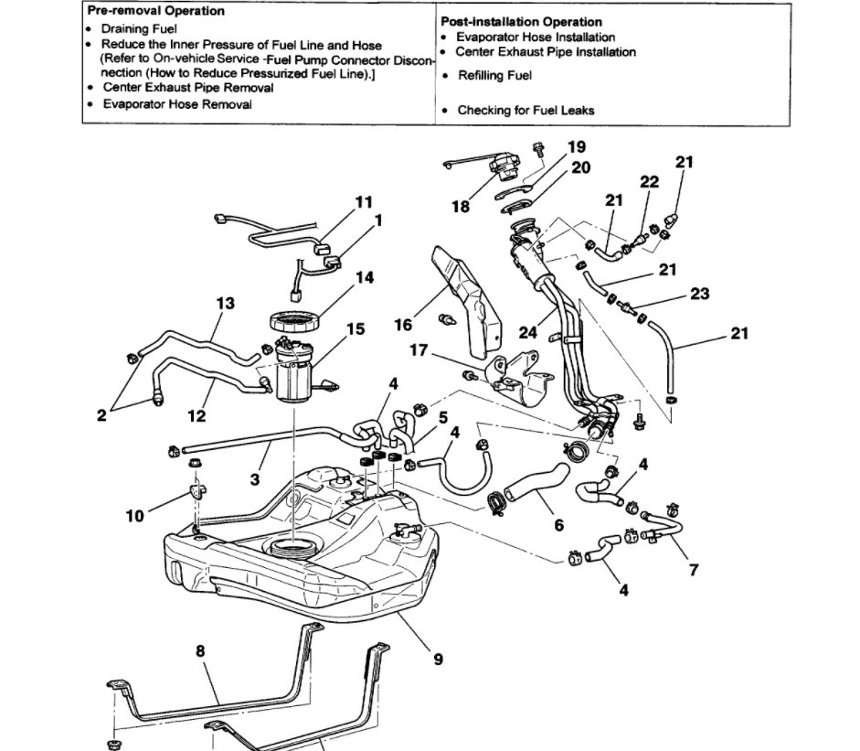

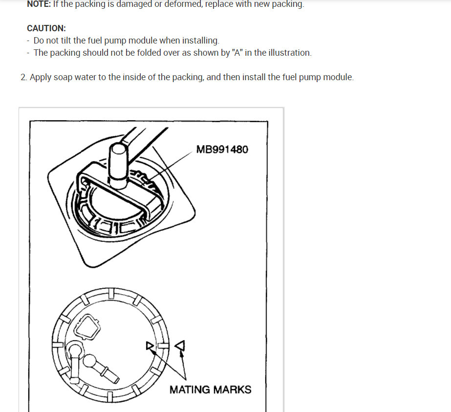

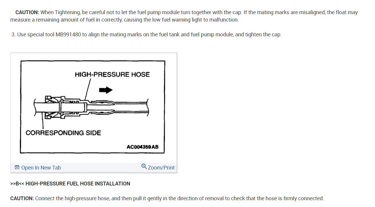

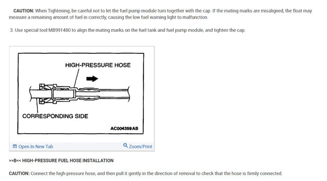

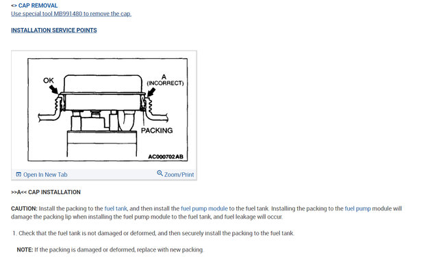

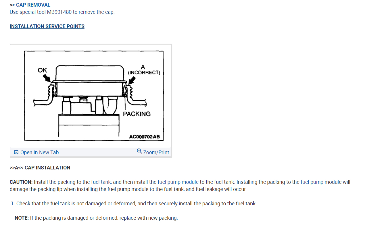

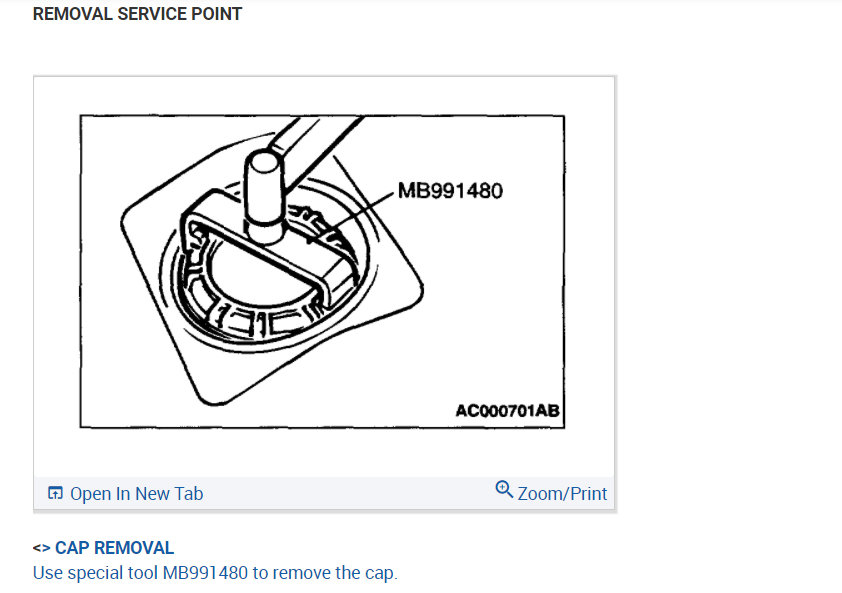

You will need to drop the fuel tank and have it flushed out and replace the fuel pump. Fuel that old is no good.
https://www.2carpros.com/articles/how-to-replace-an-electric-fuel-pump
