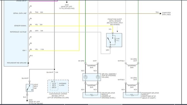

Need a diagram of the security system (sir)
1994 CHEVROLET CAPRICE
150 MILES • 4.3L • V8 • 2WD • AUTOMATIC
ANONYMOUS
as the sensors , their connection . In General, you need to know everything about sir in your car listed above. So same all time is ablaze airbag after accidents, all pillows and sensors were replaced.

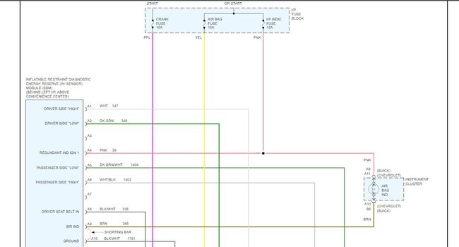

I attached the wire diagram for you.
Did you replace the module as I suggested way back?

No, but there is a working module from 91 years.will it do?"

Where do you get the schematics?
Dec 22, 2019 at 5:00 AM
No, you need a new one and have it programmed to your car. That is required.
Alldata is where I got the diagram.

How to program it?
Dec 22, 2019 at 5:06 AM
You need an advanced scan tool that can program the module. Most scan tools will not do this procedure. You most likely will need the dealer to program it for you.
