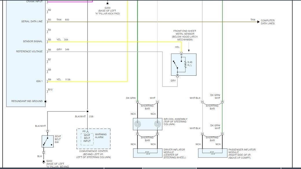

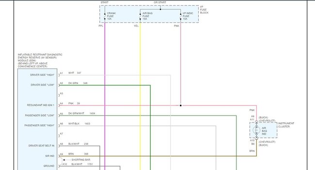

Need a diagram of the security system (sir)
150 MILES • 4.3L • V8 • 2WD • AUTOMATIC
ANONYMOUS
as the sensors , their connection . In General, you need to know everything about sir in your car listed above. So same all time is ablaze airbag after accidents, all pillows and sensors were replaced.
Dec 22, 2019 at 3:48 AM
Good afternoon,
Hello again.

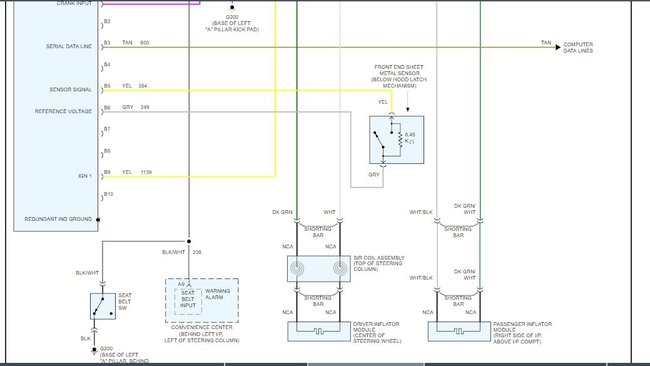

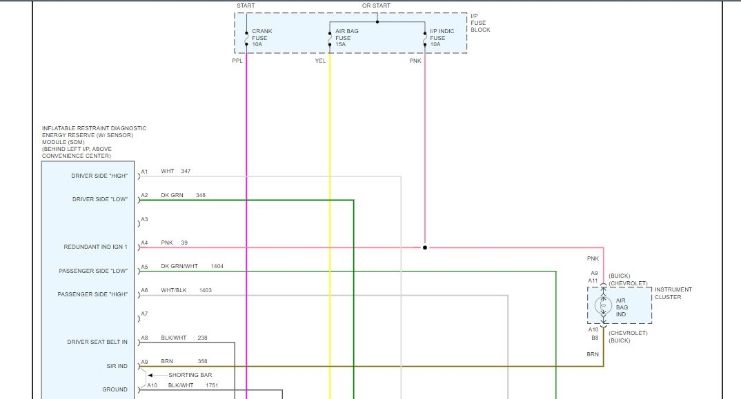

I attached the wire diagram for you.

Where do you get the schematics?
Dec 22, 2019 at 5:00 AM
No, you need a new one and have it programmed to your car. That is required.
Alldata is where I got the diagram.
