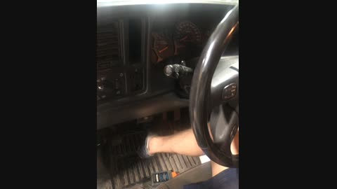

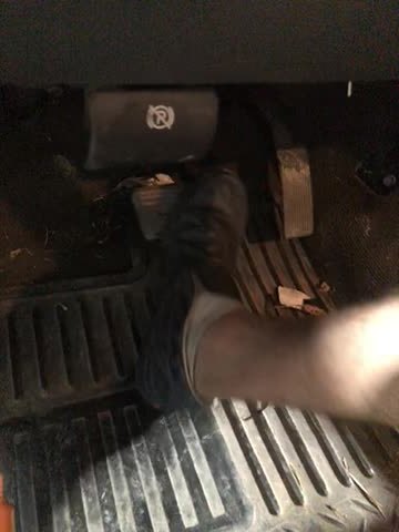

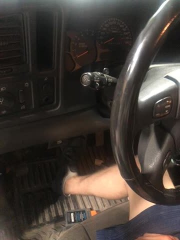

As soon as turning truck on brake pedal sinks. When driving push half ways down and nothing happens.followed the entire brake lines no leaks.I have done new master cylinder, drum rotors,pads,rear wheel cylinders,brake fluid flush, and bled ABS with a scan. Feels exactly the same.

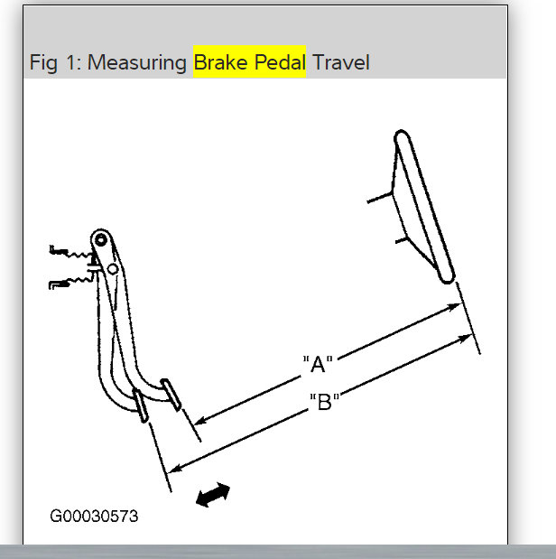

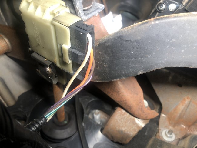

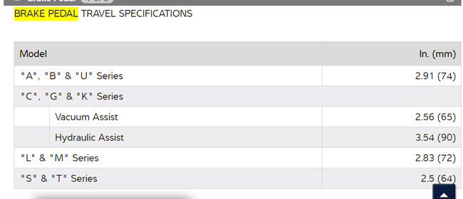

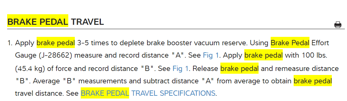

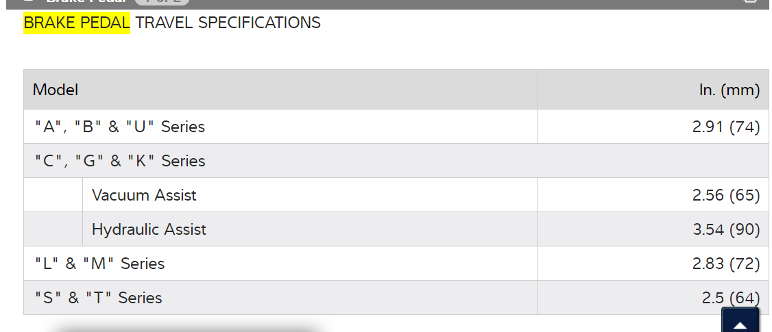

This could be a problem with your brake pedal adjustment. You need to have the brake pedal on your vehicle at the right height for it to work properly. Using the guide in the diagrams down below you should be able to adjust your vehicle's brake pedal to the proper height. Please get back to us with what you are able to find out.
Thanks,
Alex
2CarPros
Feb 22, 2021 at 5:20 PM

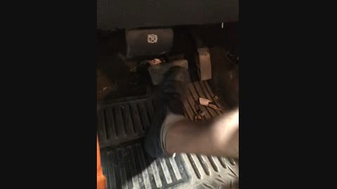

Thanks for the reply. Alright I followed all the procedures I don’t get step 5 saying release pedal between each test. On my scan tool tells me to press down and never release pedal until tests are complete. Then says complete no faults found. I have never had the ABS lights on pulled fuse just to make sure they light up. Which they do. Bled all the brakes RR, Rl, RF and left front. Push pedal and it’s stiff as soon as the truck is on and I push in the pedal sinking right to the bottom and stays soft.

As far for pedal height it’s two feet normal rest no pressure. Two feet four inches engine off all the way can push down. And two feet six inches truck on all the way pushed down. Don’t even see anywhere you would adjust height on the brackets.
