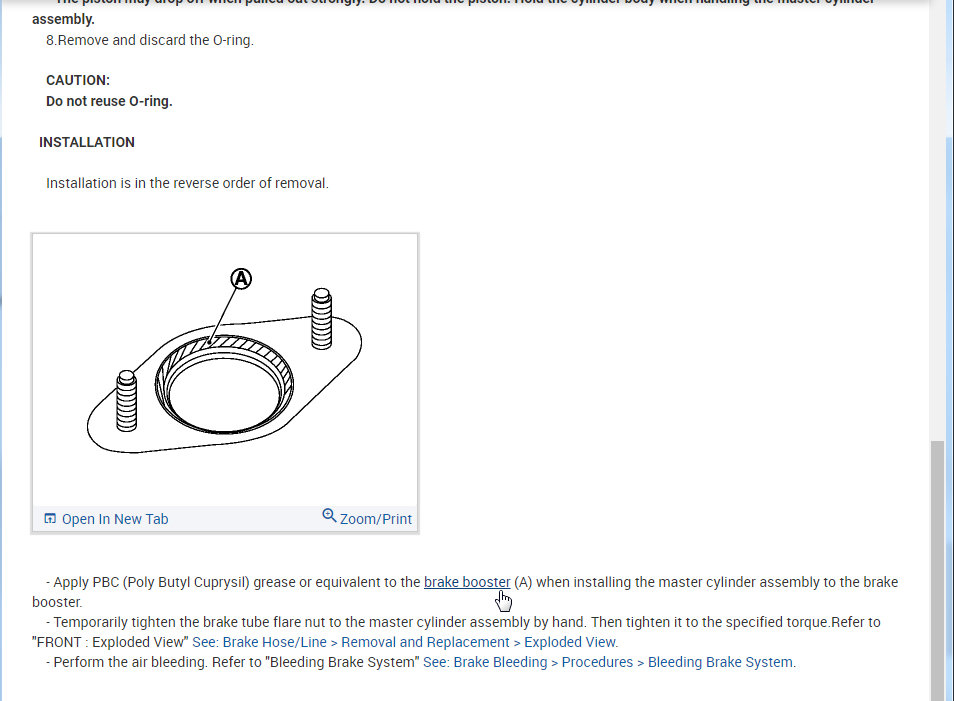

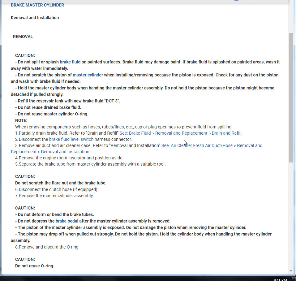

Here is a guide that will help with this:
https://www.2carpros.com/articles/how-to-replace-a-brake-master-cylinder
Also, below you will find the process from the manual on how to replace this.
Lastly you will need to bleed the brakes so here is a guide that will help with this:
https://www.2carpros.com/articles/how-to-bleed-or-flush-a-car-brake-system
Please let us know if you have other questions.
