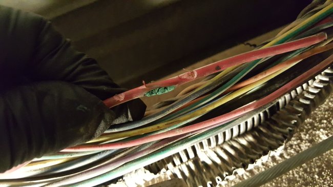

Hi I really need some help on this one I'm working on a 08 silverado 5.3 vin#m would a bad pump trow this code reason I ask is cuss it's pump not turning on and 12v direct to pink and gray wire to pump not turning it on could I have bad pump? Many thanks in advance

Yes, it could
DTC U0109 00: Lost Communication With Fuel Pump Control Module

I suggest you call the dealer first. There is a recall on that.
# 14515B: Product Safety - Chassis Electronic Control Module Internal Contamination - (Feb 2, 2015)

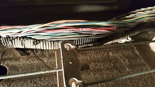

It was bad red white stripe wire that powers the module I would get 12v at module but I guess it was to week to power it was bad right by the frame under Cabinet thanks for all help not sure how it happened i attached some pics

Maybe chewed up by a rodent. Glad to hear you found it.
