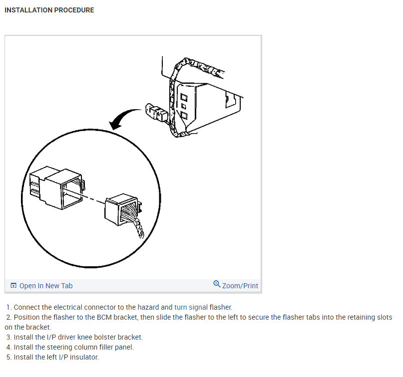

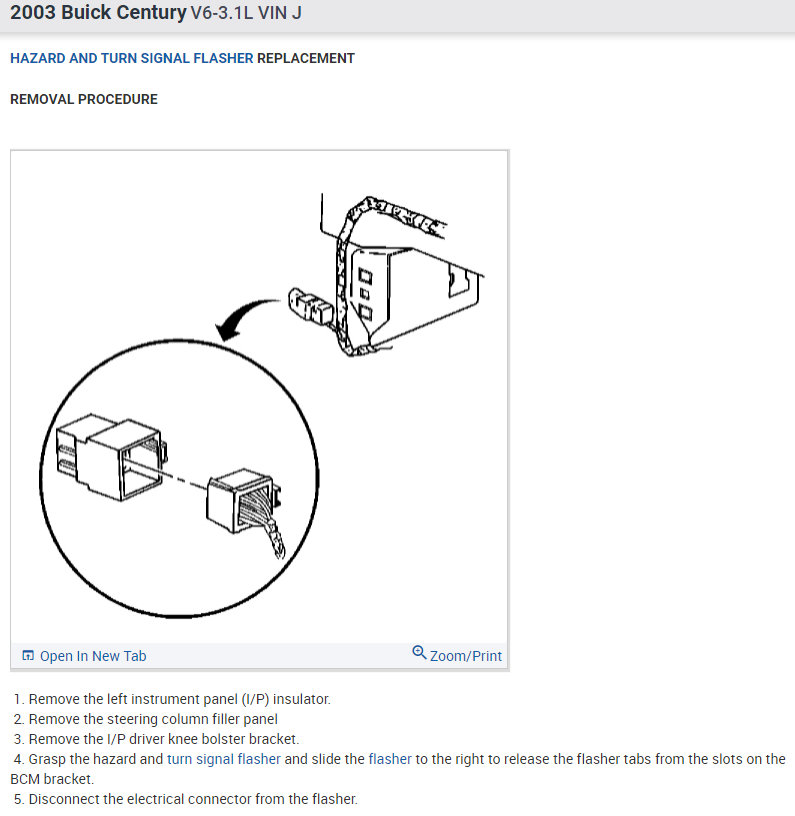

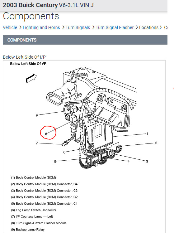

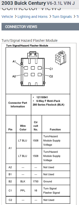

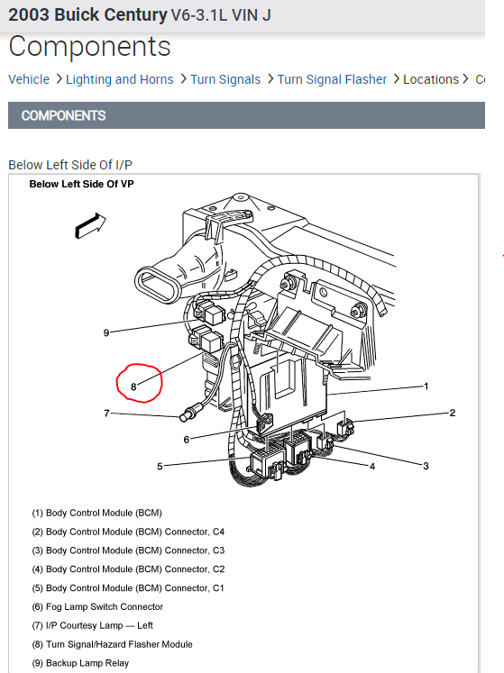

Given that the fuses are good, you probably have a faulty flasher relay/fuse.
It controls the turn signal flash as well as hazard.
It is located on the left side of instrument panel under the dash.
I have attached the location diagram as well as replacement procedure.
