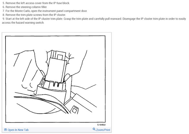

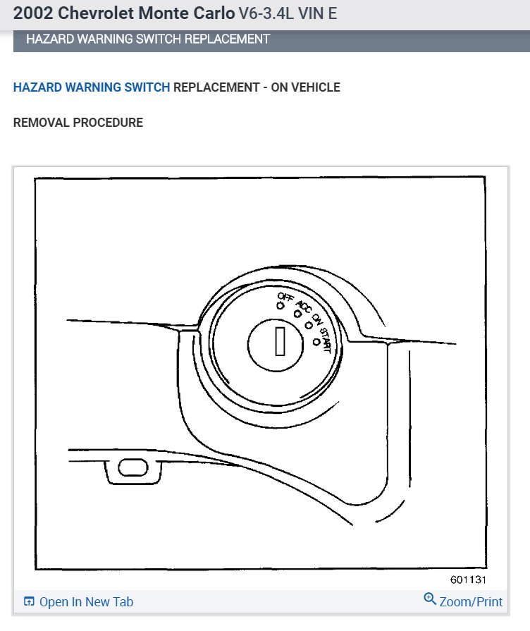

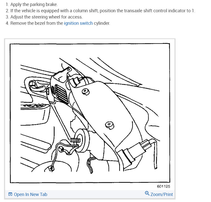

Have hazards but the turn signals work and then don't.
Jul 30, 2019 at 4:47 AM
  • 55,732 POSTS
It sounds like the hazard/turn signal flasher module is out. here are instruction to replace it in the diagrams below. Please let us know if you need anything else to get the problem fixed.
