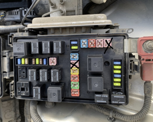

Blinker switch and wiper switch won’t work also the heated seats and cruise control.

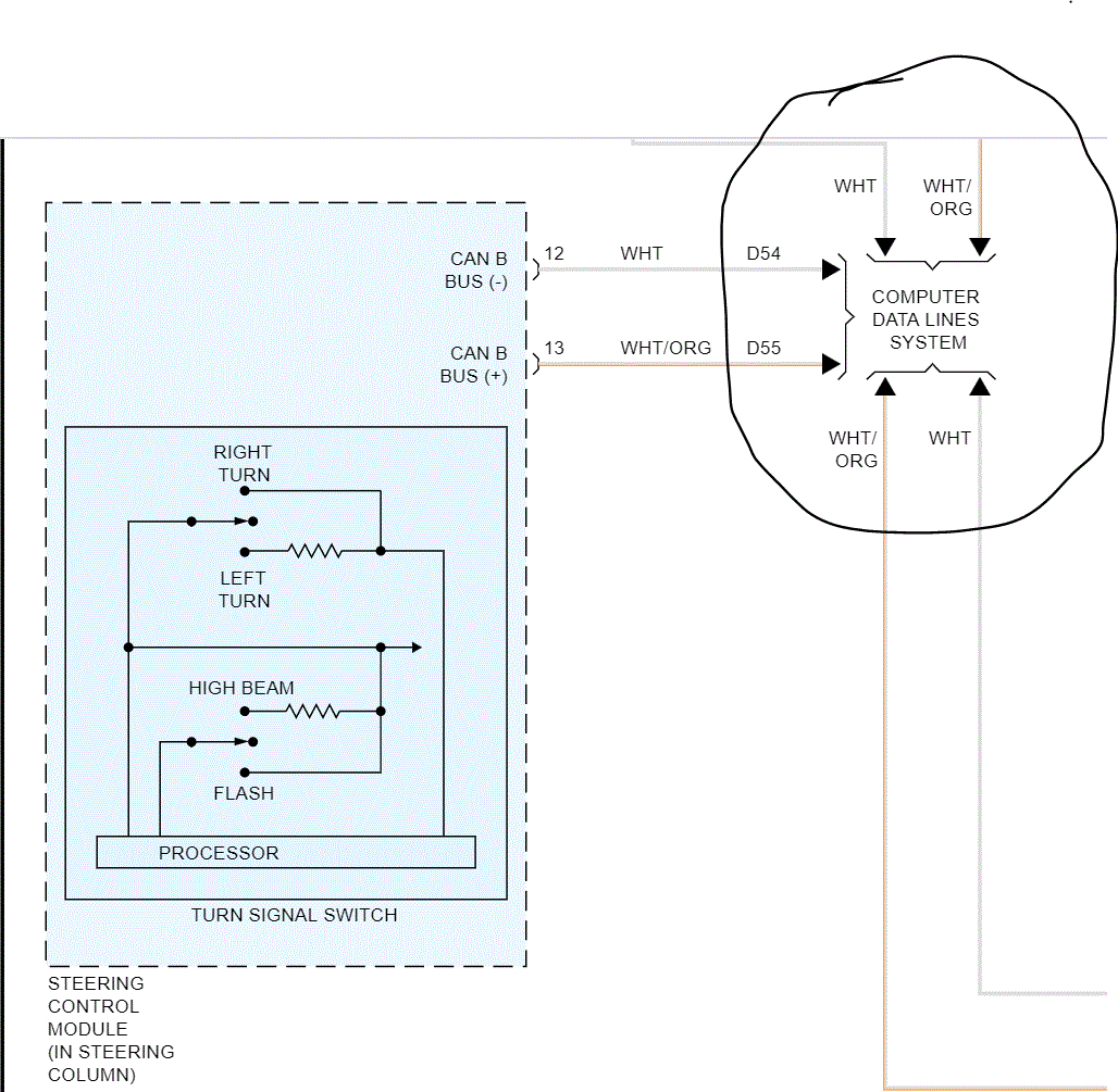

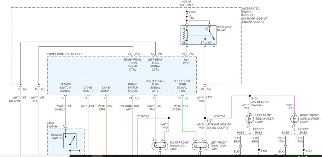

This vehicle has an integrated power module (IPM). Often times, the pins on the module corrode or break and cause this type of issue.
The way to determine if there is a break down in communication within the vehicle's CAN bus system, you need to scan the modules via a CAN scan. CAN stands for computer area network. If you look at the pics below, you will see where it indicates CAN in the wiring schematics. In pic 2, I circled computer area data lines for you to see.
Here is a video that shows how and why a CAN bus scan should be done and how it's done:
https://youtu.be/InIlnsjOVFA
This is what I suggest having done. Let me know if you have questions or need help.

I changed both 32v fuse that were broken and still the same thing.

Did the new fuses blow or are they okay? Also, you have me a bit confused. When you say 32v fuses, I'm not sure what you are referring to. Fuses are based on amperage. Is that what was meant?
Next, if you have power in and out, then chances are it deals with the IPM. I suspect something in the connector has failed. Often times the small pins will break or corrode and then break.
Jul 5, 2020 at 1:47 PM
06CHARGERRT
The new fuses are okay, And yes I meant amperage.

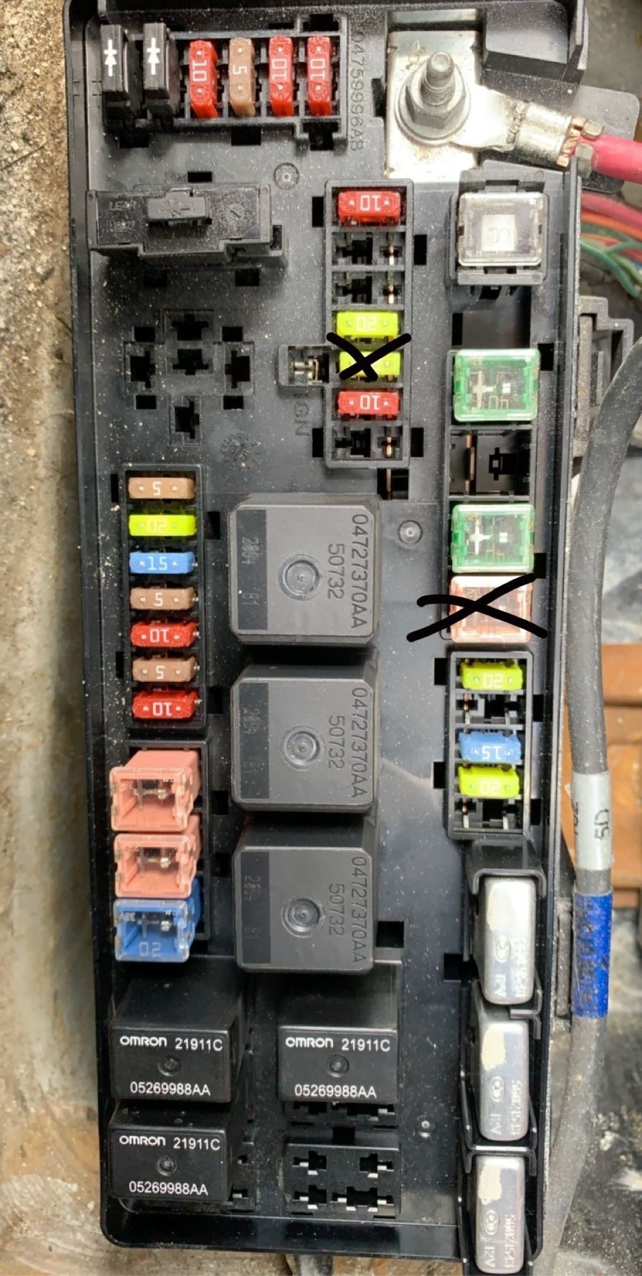

06CHARGERRT
I found 2 more blown fuses and changed them.
One 20amp and one 30amp and they all started working again. thank you so much for your answers they really helped me diagnose the problem.
